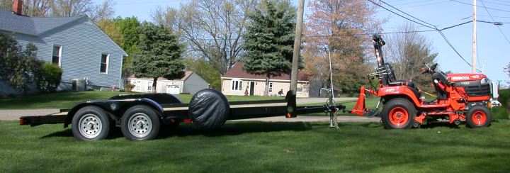

mow4fun, I had a 3K (3500# axle) 6X12' with no brakes and the BX2230 fit and hauled fine with my F150. Then I added a loader and counterweight to it and backing the tractor onto the trailer I could not set the bucket on the floor of the trailer, it had to sit against the ramp gate. With the BX it seems to be a matter of length not really the capacity of the trailers (talking about 3500# axle trailers). I just sold that trailer and bought a 16' tandem with four wheel brakes. Bottom line the BX with a loader and anything on the back will not fit well on a 12' trailer. I like having the brakes much more than not having them. The old 12' trailer was well built and weighted around 900# the new one weights 1650# so it is not that much heavier for what you are gaining. Having owned both I recommend a 16' dual axle with brakes, mine is a Gatormade and it only cost $1850 + tax, they are allways on E-Bay. It seems like a well built 6'-4" X 14' trailer with one 5200# brake axle would fit our needs, but I have never seen one?

Ok, here is an update:
Load Rite trailer, galvanized, 6x12, surge brakes, 15" tires, 3500lbs GVWR, trailer weight 900lbs, and wood floor (blanks).
It will definitely handle the tractor with FEL or Chipper. Nice to have the surge brakes as apposed to electric brakes which would have required additional expense for brake controller. I think the price is right too: $2100.
Probably use it 2 or 3 times a year, mainly 15 miles although there is one trip I am looking to do this year which is 90 miles but that will be a one time event.

Here it is, took for a ride and it rides and hauls very nice. I still need to figure a better way to tie and secure the tractor, I am using the strap type to secure it but thinking to get a chaine setup.

Looks to fit on there fine. The front rail looks to be removable via a few bolts, I'm betting if removed the tractor could be moved forward enough to get the chipper on too or just put the loader over the rail. Weight distribution may be off though.
Have you checked the tongue weight with the present positioning?
/ Trailer choices
#98
All railings are aluminum and are removable with few bolts. I didn't get a chance to weigh the tongue, I read some directions on it.
Any thoughts on best way to do it?
What would the weight mean when done?

Conventional wisdom claims the weight should be 10-15% of the gross weight, so assuming you are pretty much near the trailers 3500GVWR the tongue should be 350-525#'s. If a bathroom scale doesn't go that high there's a method using the scale, a block and a board which can get you close.
I personally find it easier just to determine what tongue weight you want then have yourself, your wife,and/or kids (whatever approximates the total weight) sit on the bumper then measure the ball height. Hook up the trailer and position the tractor until the ball is at the same height minus an inch for good measure.
Straps are fine... I have used both over the years.
I have 5K straps that are more than strong enough for your use and easier thank chains /binders... Just place some chafing gear if running over a sharp edge. Check with local fire dept, Old 1 3/4 hose in 2foot seconds works great split down one side...
