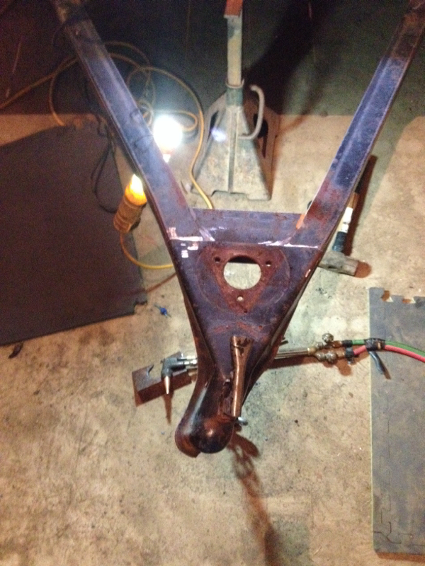

Is there a need in welding the under side of the coupler. The original one was and it took a lot of work to get it off. I would not want to go thru that again.

I put a few tacks on the under side and I think I'll drill a hole on each side and use bolts. I might use the bolts to attach the safety chains back on. Here is what it looked like when I started.

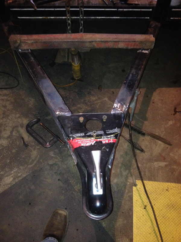

If you look at the first pic, I welded across the top then down sides and under the rolled up lip on the sides. I also put a few tacks under red sticker.

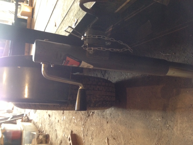

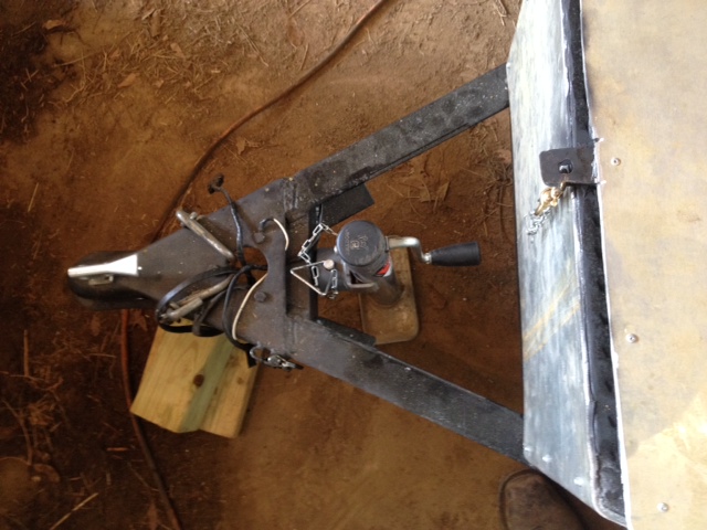

Update...When I bought the trailer from a buddy it had a slight bend in the tongue from where he jackknifed the trailer while backing it up (you can see that in the orginal pic) That always bugged me so while had the coupler off I straightened the A-Frame. Then I welded across the top then down sides and under the rolled up lip on the sides, I welded underneath where I could. I meant to weld the safety chains on but remembered after I painted so I bolted them on. While I had the trailer in the shop I did a few mods. I built a tongue box out and added a sidewind bulldog jack. I never like the original jack because it would drag when I cross ditches. Also added jack mounts to each side of the trailer behind the axle when I have a flat.
