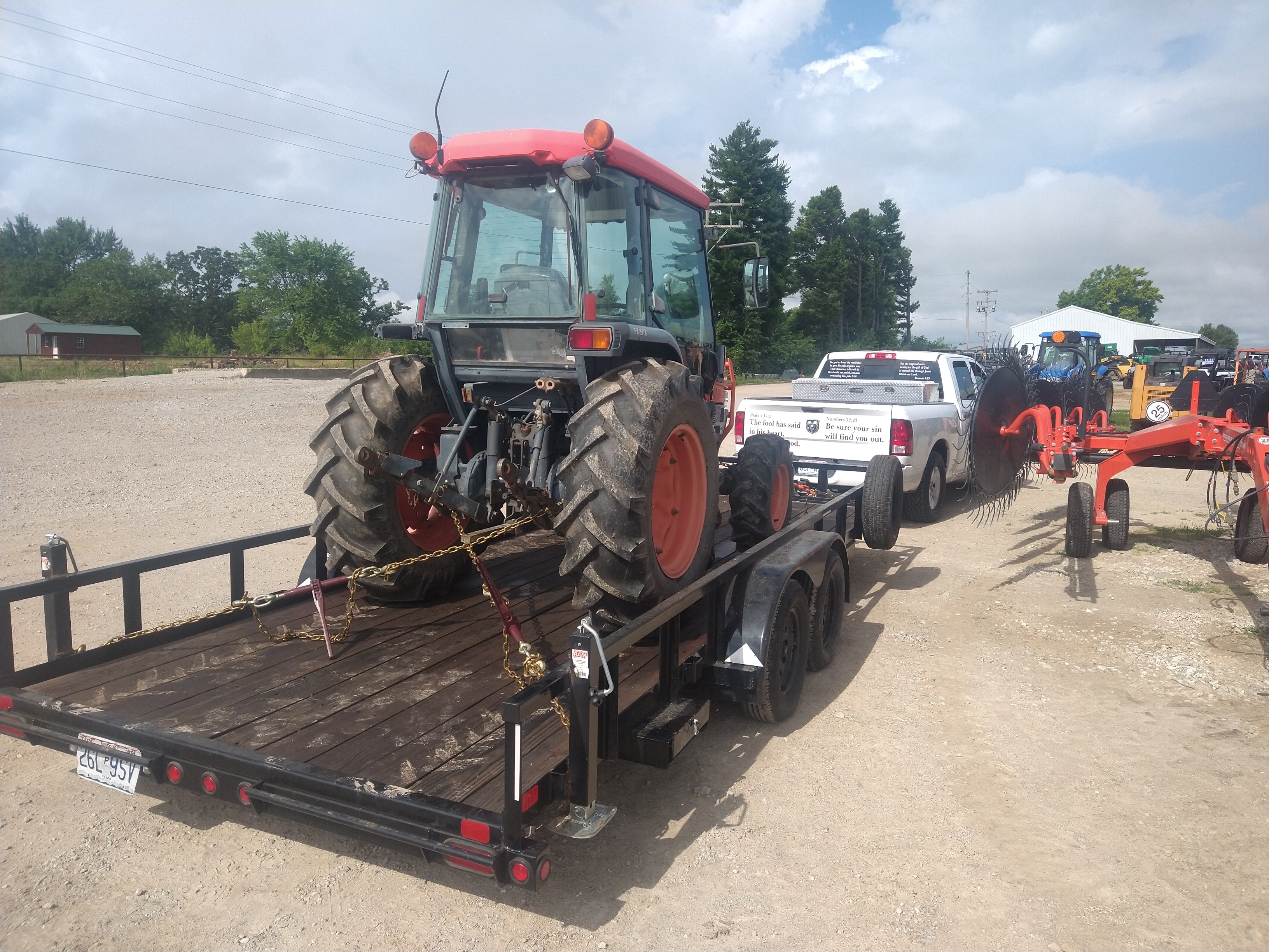

My equipment trailer, (7 X18-ft deck area) is decked with pressure treated 2x6s. Anybody have recommendations on what to treat the deck with to make it a bit more waterproof, and weather resistant? It gets stored outside and not under cover, and spends several months covered in snow.
