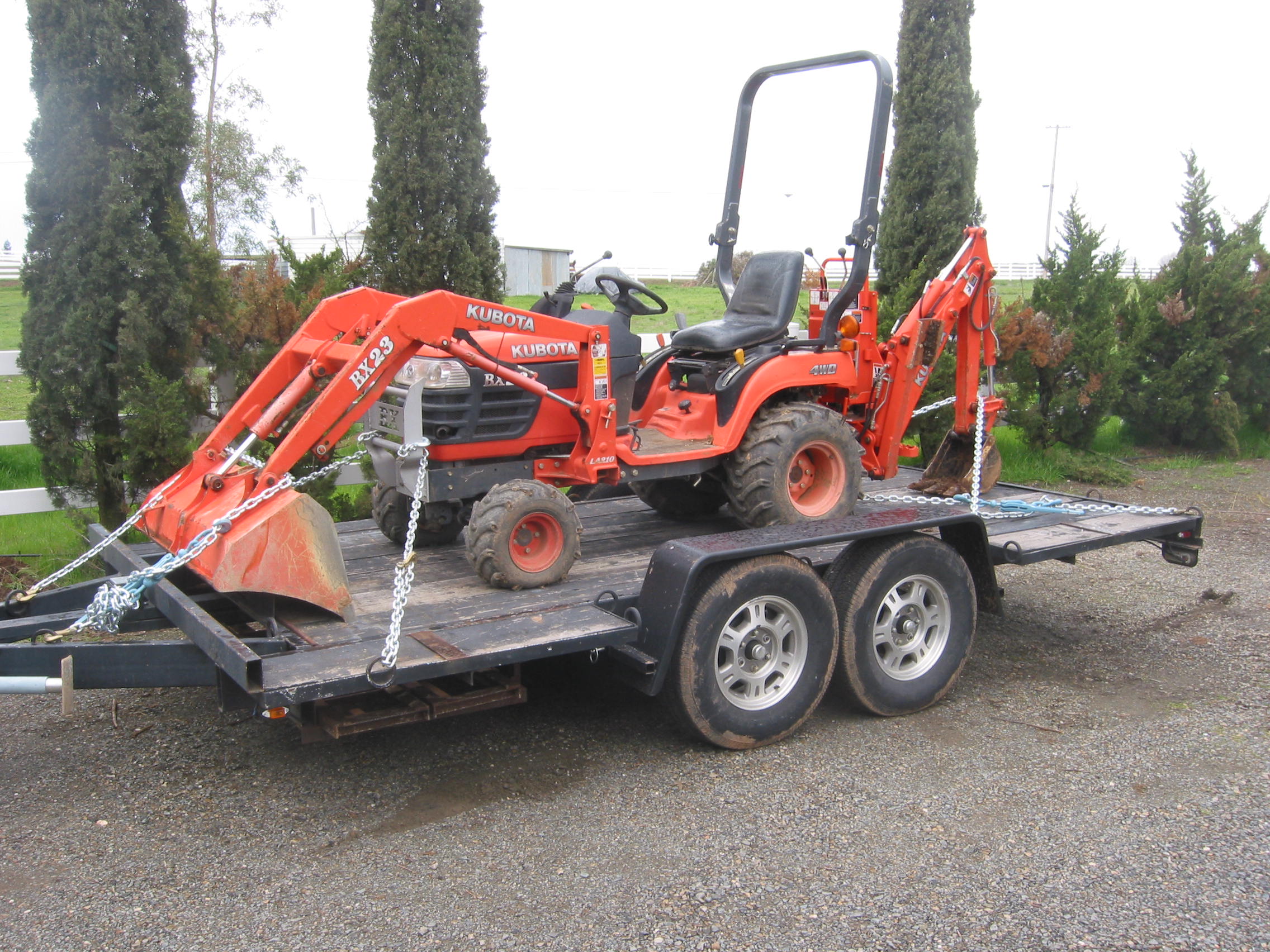

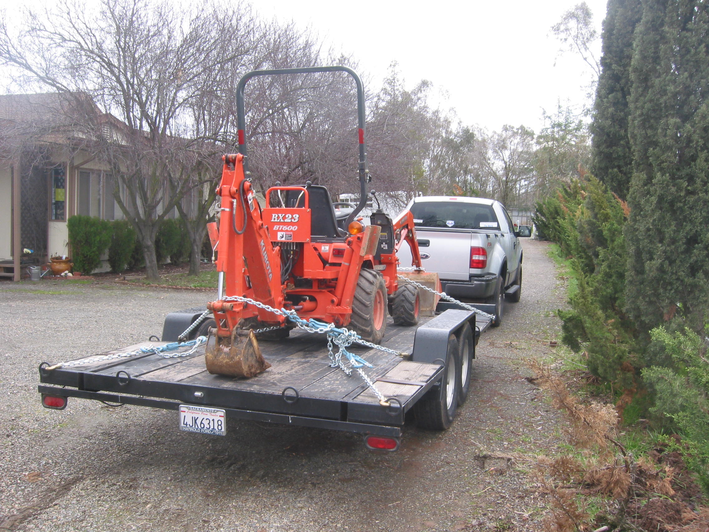

here's the way it arrived from the dealership. yes, the dealer. note the over-loaded tires and single axle, lack of adequate tie downs, pretty illegal looking bucket overhang, excessive tongue weight, high center of gravity, etc.
i'm much more comfortable driving down the road at 70 mph with the new set up in the post above. sure, it fit on the dealership trailer, but that's about all you can say positive about their set up.

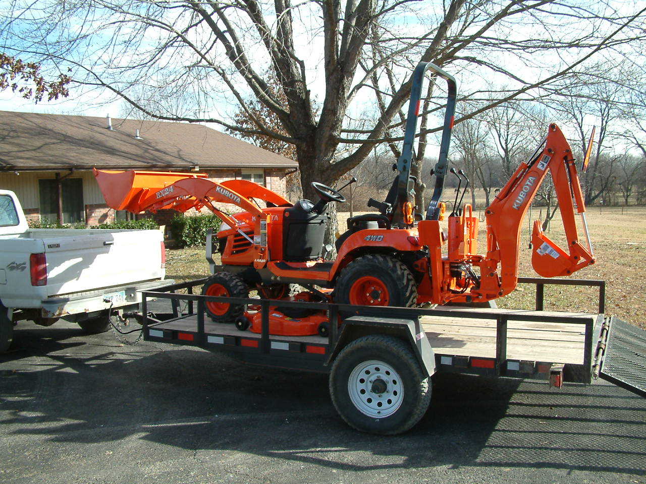

Here is what I use. 16' dual 3500# axle with brakes on both axles. Kind of overkill for the bx but about maxed out with my @5000# jeep on it.

Is the left front tire on your tractor low, or do you pull down hard enough on the chains for the tire to flatten that much?
