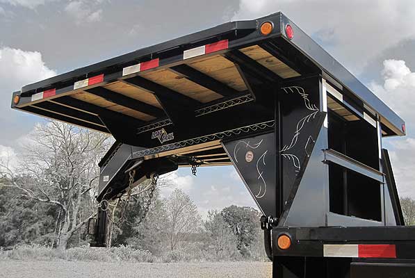

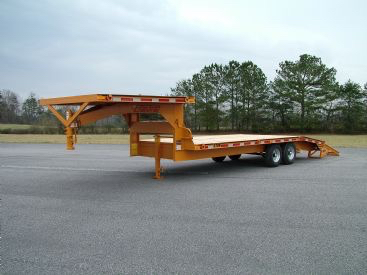

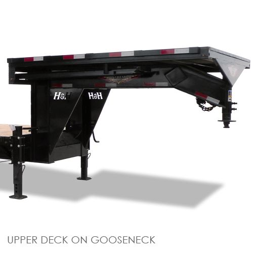

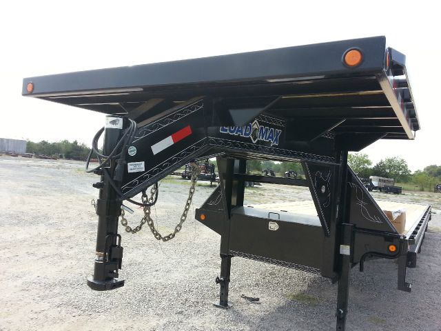

   / Trailer for two UTV's and two ATV's #13

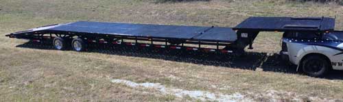

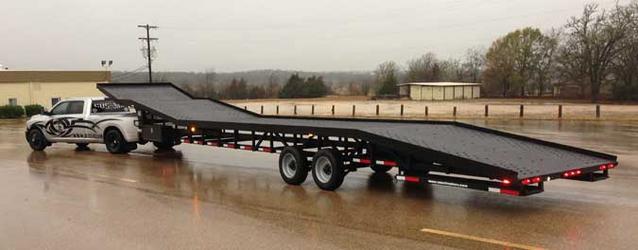

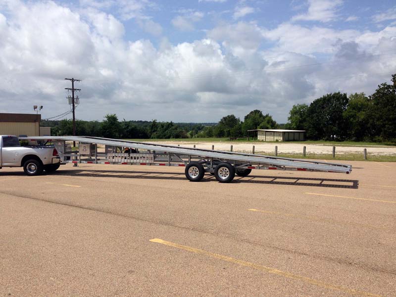

For those that haven't seen a deck on the neck.
3E74D800-B488-4296-932D-1D1C662A8705_2.jpgbf2ba96a6941b7d57a8d3f425b86b157_f399.jpgDO1.jpg
bdog, since you have a unique load to haul, you need a unique trailer.
How about a short version of this one.
Take 3 Trailers | Custom Trailers

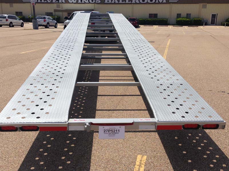

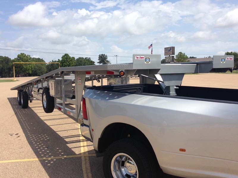

Thanks, another advantage of a custom built is, it would be narrower and lighter than a normal gooseneck.
Amr_-_Ultra_Lite_Silver_003.jpg Amr_-_Ultra_Lite_Silver_007.jpg Amr_-_Ultra_Lite_Silver_008.jpg
This is the car hauler style.
