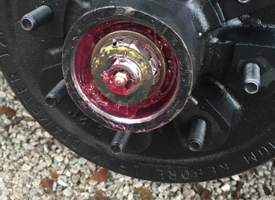

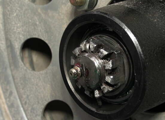

Yeah I kind of ignored the suggestion as there is no cotter pin and I did not want to call it out so I just said nothing.
To the best of my knowledge EZ lubes never have cotter pins, maybe some do but not to my knowledge as the cotter pin would go right through the grease channel and block it so they use either a tang washer (not a fan of) or a special spindle nut retainer (which is really kind of cool device).
The EZ Lubes on my Sure-Trac with Dexter axles use an offset drilled cotter pin. So the grease goes through the center but the cotter pin is off to the side of the passage.
Interesting my 9 Dexter axles total for 18 hubs don't have the offset cotter pin. Wonder if those offset are on heavier duty or lighter duty axles than mine. I have 4- 6K, 3- 7K and I think two are 5.2K from many years back.
   / Trailer hubs shedding grease caps #45
From the Dexter parts catalog they claim the cotter key wasn't used after 2002, but I have them on my 2011 Sure-Trac. So either Sure-Trac has some old axles laying around that they are still using or Dexter is supplying old axles for sale.
I saw your earlier post about Sure-Trac and thought that must be a Dexter axle model of some type but it sounds like that is not accurate. Never heard of Sure-trak. Googled it and it seems to be an east coast (Tenn) manufacturer. NO wonder I never heard of it before. Probably like you have never heard of Great Northern trailer either.
All my axles are post 2002 manufactured and that makes sense as to why I know nothing about offset cotterpins.
