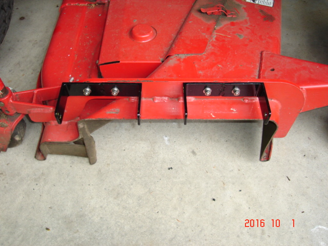

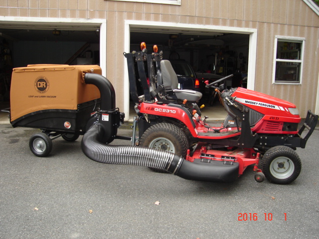

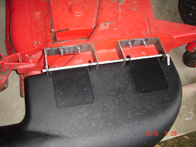

I just picked up a DR Lawn & Leaf Vac this fall. Still learning how to use it, but so far it seems to do pretty well. Had some issues attaching to the M-F MMM, but figured that out. Now, I need the 36" extension on the tube. Thought it would work (and it does), but it severely limits turns to the left so I'll add that extension. (Only need about 12"!!)
DR folks have been good to work with; since I live fairly close, I drove up to Vergennes to pick it up. (Of course, "close" is relative-- took me about 2.5 hrs to get there, as there are few east-west roads around here, but it's a nice time of year for a drive in the country.)
Some observations:
1) Engine is splash-lubed (no oil pump), so travel "is limited to no more than 15 degrees" according to the manual. Around here, flat ground is precious! I've taken it up to 18 degrees without issues, but only for short periods, a few seconds at most.
2) If you stop forward travel, it seems to continuously spit small bits out the back end, making a small pile on the ground under the back end until the leaf vac engine is shut off. (There may well be a remote kill switch in the future.)
3) The dump feature of the unit is fantastic. Easy to operate with the help of the hydraulic strut, and the shape & tipping angle of the box really dumps out very completely & quickly.
4) I'd say effectiveness, for relatively dry leaves, is about 98%. It leaves a few leaves behind, but not many. Was really impressed that it sucked up pine needles very well, too! I'm still breaking in the engine, so haven't really run it full tilt yet, however.

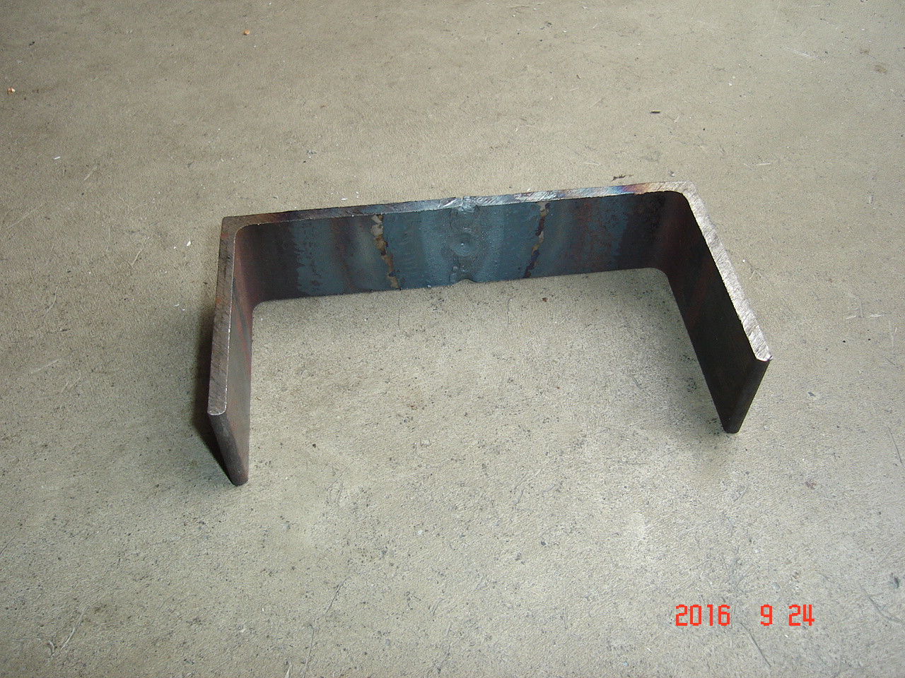

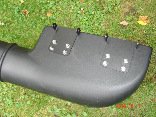

To make the mounting brackets fit to the existing four bolt-holes on the MMM, I just welded together two 1.5" wide 3 x 3 angle pieces and used one long rod (hardware store, $4), heated & bent on one end, then drilled for the keeper pins supplied by DR Power. Crude, but effective.

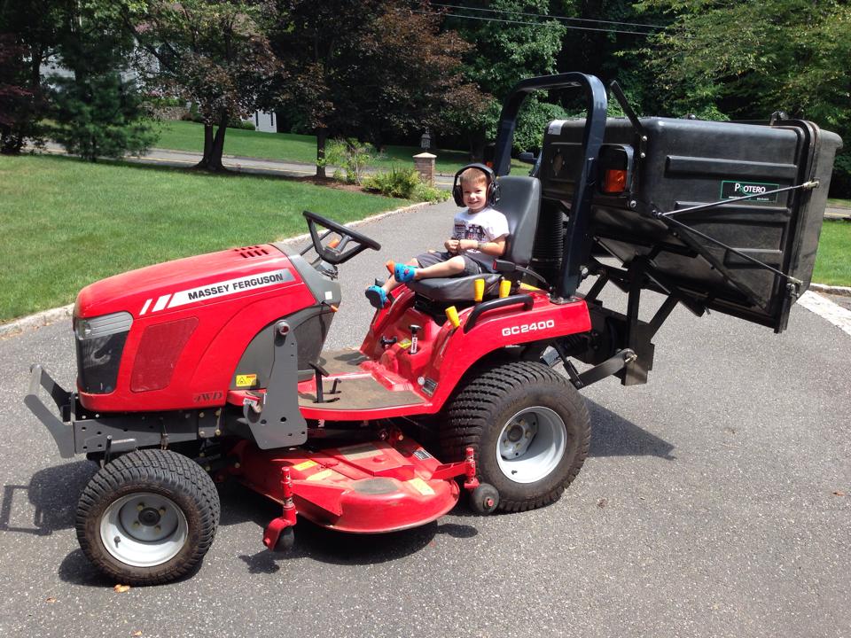

Just throwing out another option. I collect my clippings all season, but I have a complicated lawn with lots of obstacles, so didn't want to tow something behind me. Its got less capacity than tow behind at 14.5 bushels, but is quick dump from the seat via a lever over the left shoulder. Its powered from the rear PTO, no extra engine!

Its made by Protero, its not cheap, just over $3K, and Protero isn't the best supplier to deal with (they will not deliver on time). BUT...it works well. Good suction, 8" hoses. only clogs if you get a stick stuck up there. Not sure exactly what material the hopper is made from...some sort of plastic, won't rot or rip. Has a couple of caster legs that go on when you want to remove it, works well on the slab of my shed.
Besides cost, the downside is that it really block your view to the rear. And of course, it doesn't fold down small when I store it for the winter. You also gotta be careful, because on most of these small tractors, the mower deck raises and lowers with the 3pt hitch. You gotta make sure you don't drop until the vac is dragging on the ground...

BTW, out-the-door price for mine (the "Premier" --small-- model) was a tad over $1400, but I found that I did need the extension piece on the hose because on left turns the hose would pull off -- not quite long enough. Had to add about 18" of length, though that may get reduced later. Extension 8" x 36" hose was around $50.
