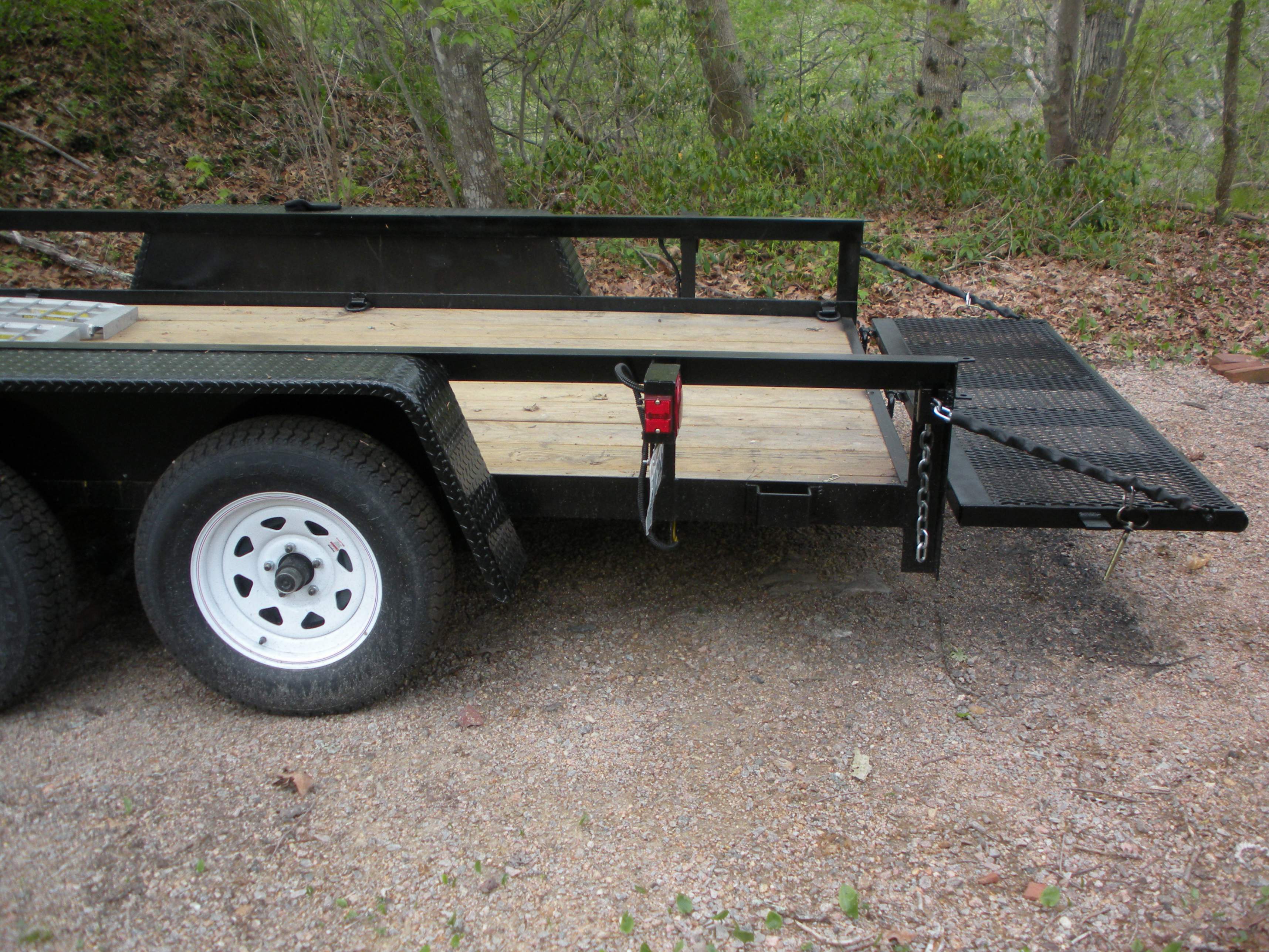

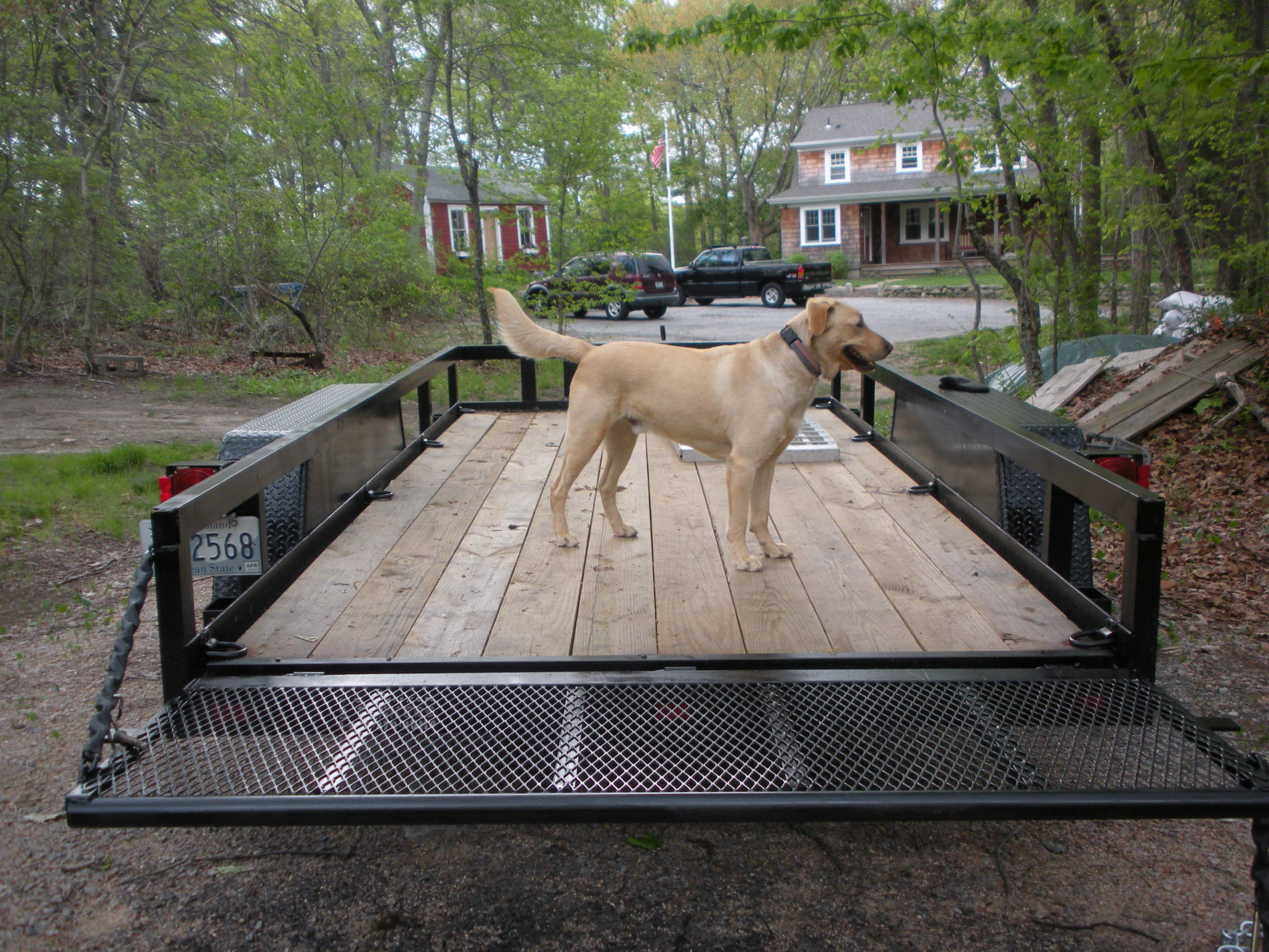

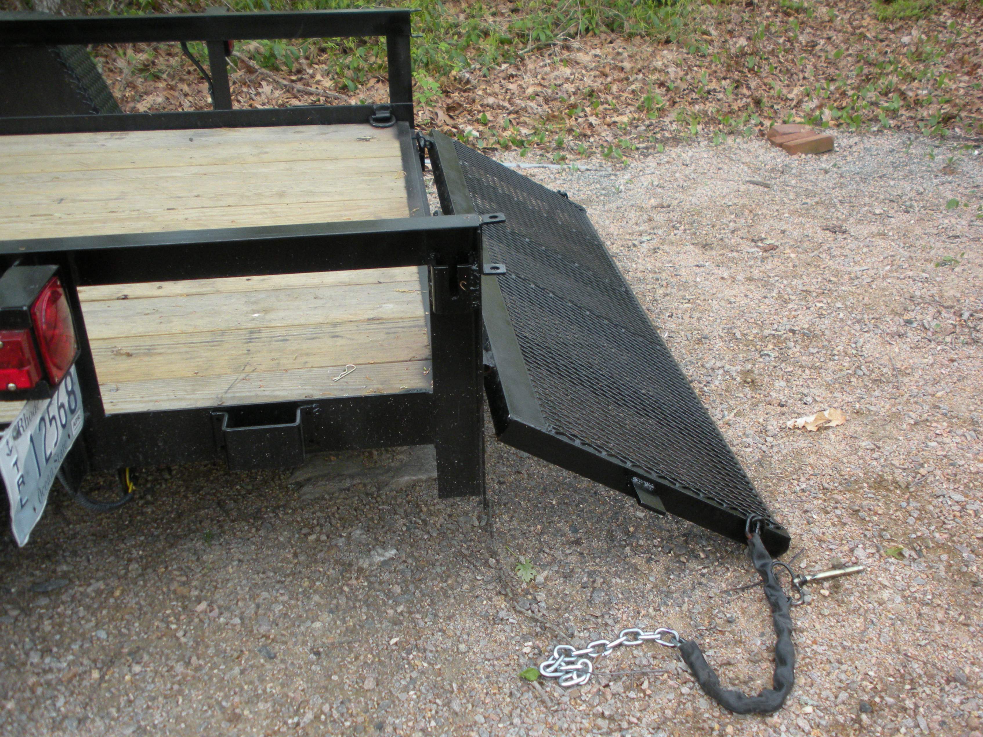

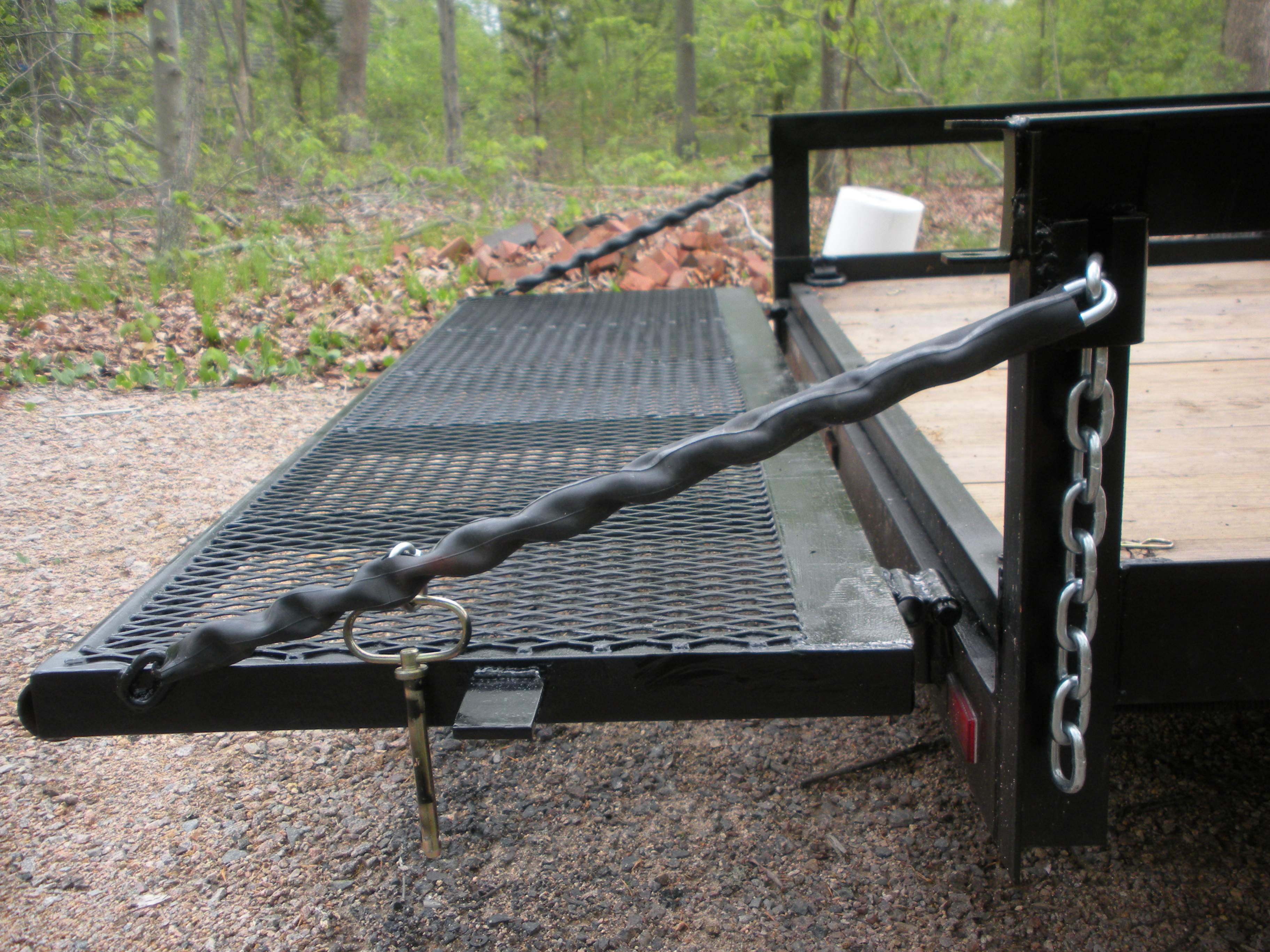

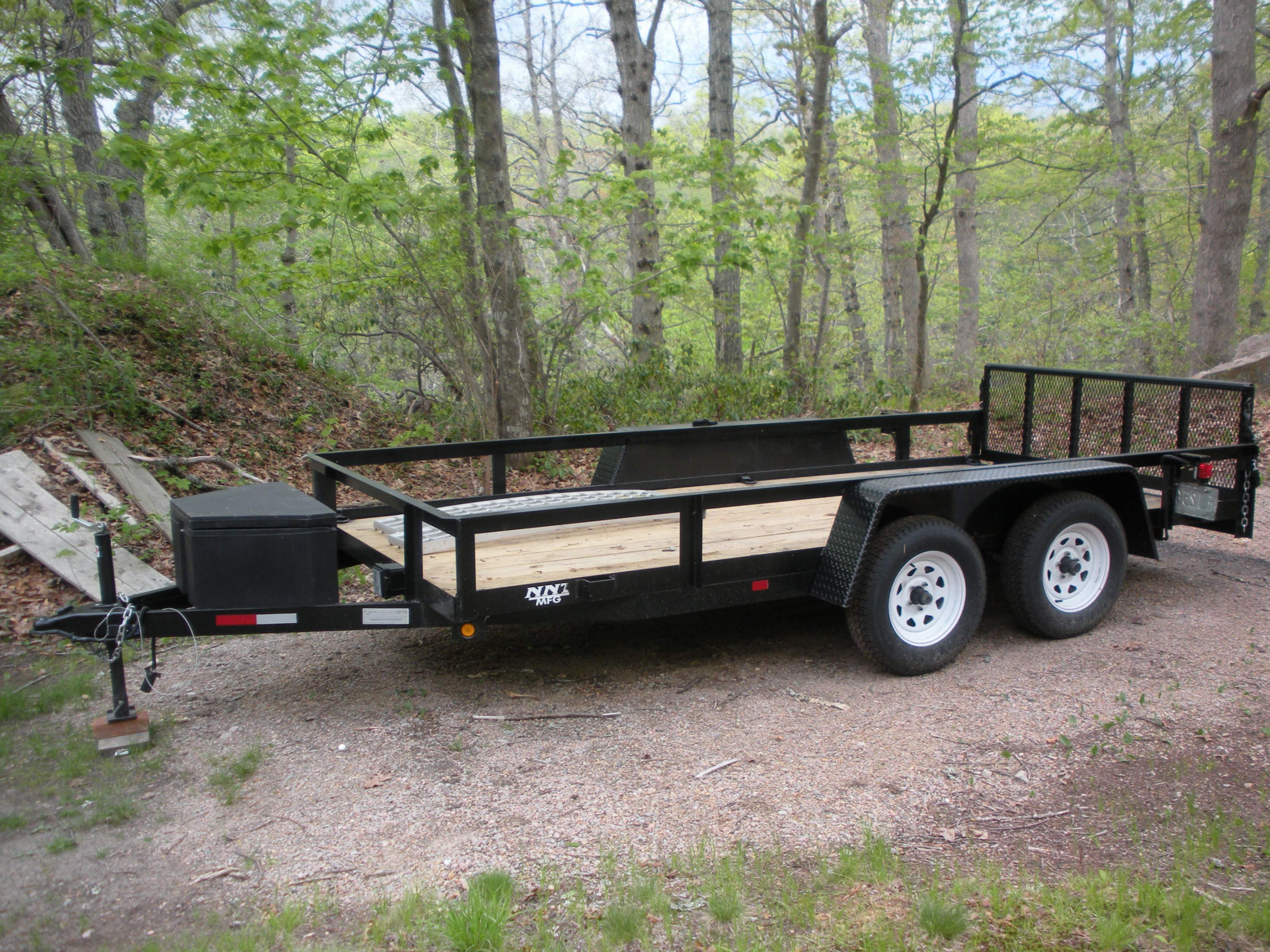

I recently purchased a brand new 14' tandem axle landscape trailer. It will mainly be used for hauling around my Bota b7500, but it will also be used for hauling lumber, firewood, dump runs, etc. on occasion. I, like many others, was torn about which size to buy. Aparently size does matter. I'm glad I went with the 14' since it is very manuverable around town and in my yard. I solved the dilema of being able to haul the tractor with implements like my brushhog or york rake by designing a tailgate system like on a pickup. I picked up the basic gate from my neighbor who wasn't using it anymore, then welded on two tabs for the latches, some new hinges, then some adjustable chain holders and finally welded the chain to the gate. I had a set of 5' aluminum arched ramps from my last trailer that work perfectly. Behold, a 14' trailer that instantly converts to a 16' without the wind drag of a full size gate!

Looks good, one thing I might be concerned with is it bouncing during travel and putting a shock load on the chain. Technically I think tail lights are also supposed to be within 36" of the rear of any trailer, but you could probably get around that by "red flagging" anything longer.

Bouncing gate---I thought about that too. I would only ride with the gate down if I needed to have something long on it like the brushhog or york rake, so they would be resting partially on the gate and that should keep it from bouncing (hopefully).
Tail lights---I should be pretty close on that one, the gate is only 24" long. But thanks for the heads up.

ramps---I can leave the gate on when I use the ramps if I drop it all the way to the ground. If I have the slightest incline to use, I can load the tractor without an implement without even using the ramps if I put the gate all the way down to the ground. I am also planning on trying to weld a set of cleats on the top of the gate bar so that when the gate is down level with the ground, I can use the ramps and drive on. The chains are each rated for 1900 lbs so that shouldn't be a problem. I just hope the welds on the chains hold up where they are attached to the gate.
1*I think tail lights are also supposed to be within 36" of the rear of any trailer, but you could probably get around that by "red flagging" anything longer.
1*He only added a 2 foot tail gate which is within the 36'' range.
Looks good.
2*Does the gate need to come off to use the ramps?
2*T thought the gate was the ramp.

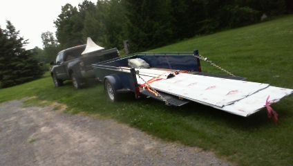

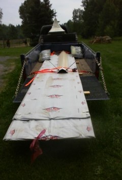

I did something similar, although not as professional. I just wrapped a heavy chain around the back (through the handles) and used locks to make sure it didn't go anywhere. I was able to put 17 foot lengths of steel into a 10 foot trailer. Not entirely legal, but it worked well.

I got a free trailer, 4'x8', from next door neighbor, it was an old grape bin trailer to pull behind a tractor. He was pulling 3-4,000lbs on it. It's made of 2"x4"x1/4" box tubing, throuout. Very heavy trailer itself. It came with a bed of rollers, to roll the bins off. It also had a motorhome axle on it, and I had to put 2 new tires on it to haul it next door. Once here, I proceeded to make it a street trailer. Put a bed over the rollers, cut off what wasn't needed, and added a steel frame with expanded metal sides and a 30" tailgate very similar to yours. I also make my hinged for tailgate, and my latches for tailgate, from sched 40 1/2" ID steel tubing, and 1/2" steel rod as the hinge pin.
I cut the tubing into pieces of equal length, then I spot welded the tubing to both the tailgate and the bed of the trailer, in a position I wanted the gate to be. Alternating the welds of course. One weld to trailer, next piece to gate, then on and on. Once all spotted, I did final welding with steel rod still in place. Then I welded the end of the rod on one end to keep it from coming out.
I did the latches a similar way, and bent a piece of 1/2" rod at a 90 deg angle, and aling the gate and drop the rod in, that gate goes nowhere.
My tailgate is also chaoned, like yours, but I have a few extra links on each chain, and when loading my MF1010, I drop the tailgate, and attach my steel ramps, that attach like the tailgate does to the trailer, but the rods are removable for the ramps. When not using the ramps, they are stored underneath in brackets I made, and they are loacked in place. Always there when I need them.
