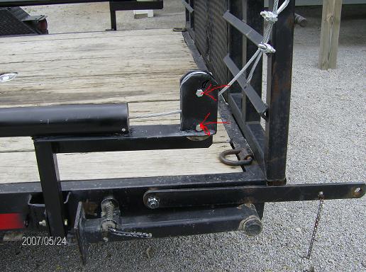

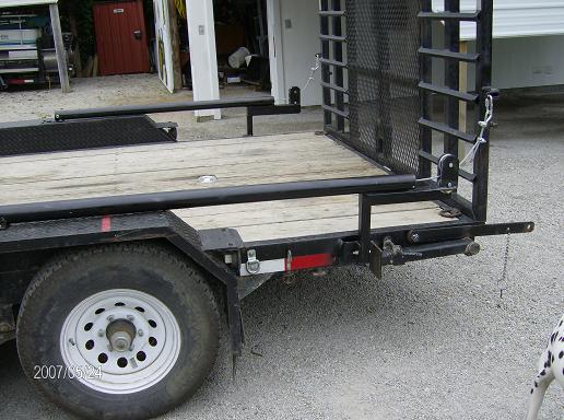

Lift assist using springs & cables for the ramp-gate. I made my own with garage door springs in exhaust tubing:

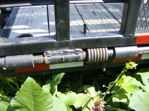

My 16' trailer also has two heavy coil springs on the hinge pins:
This gate was built to hold up a 7500# tractor! ~~ Lowell
Looks good! :thumbsup:
I need to do that to mine. For some reason my tailgate is getting heavier all the time. I'm sure it's not because I'm getting old, though. :laughing:
Btw, in this pic I see you saddled a dead horse, although I don't think you'll have any problem with the cable slipping. :laughing:
