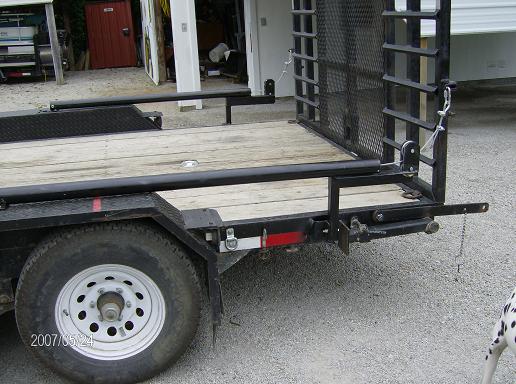

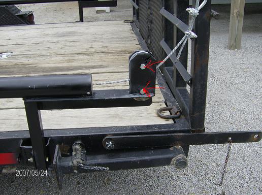

Lift assist using springs & cables for the ramp-gate. I made my own with garage door springs in exhaust tubing:
My 16' trailer also has two heavy coil springs on the hinge pins:
This gate was built to hold up a 7500# tractor! ~~ Lowell
