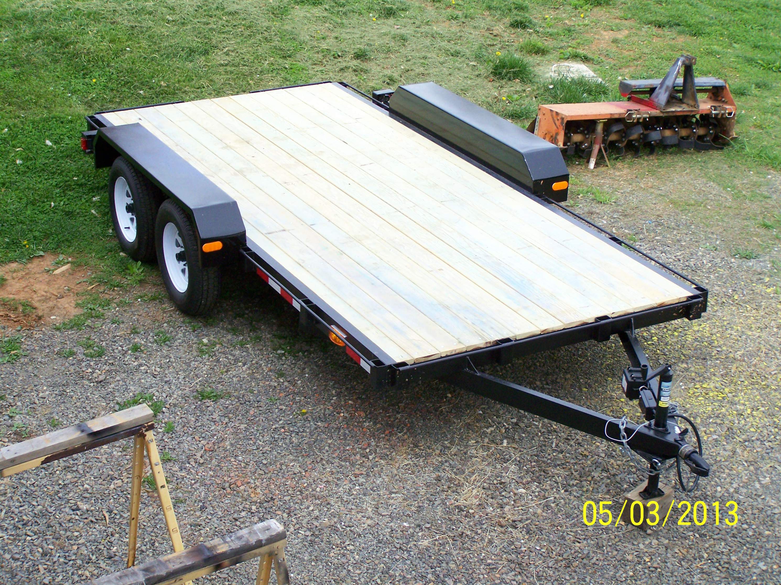

I was looking to do most of the same chores as you are. Like you my truck is to small to haul my tractor, so that wasn't part of the plain. Here is what I decided on, and has been working out well for me. 14ft bed 6ft between the fenders, tandem 3,500lbs axles, the deck is 5/4 PT, weight is 1,440lbs.
I prefer having tandem axles and brakes hauling lumber.
I haven't built sideboards yet, but plain to in the future. New 14 ft Trailer 002.jpg

That's sharp looking. Is the tandem axle/14 footer easy to hook up? I'd like to pull my truck near and just lift the tongue right onto the ball by hand. My friend's 16 foot tandem is too big for that.

Thank you. Lift it by hand? Maybe 20 years ago, but now I use the tongue jack.:laughing:
I built the trailer 14ft for two reasons. (1) I felt that I would need to haul 14-16ft pcs of lumber. (2) the 5in channel I had was 14ft long, and I hate to waste.:)
I was on the fence about making it 12ft, and honestly I think it would work OK too.
Even at 12ft I would want tandem axles.:thumbsup:
I have seen factory built trailers similar to mine. Trailers | Utility | Tandem Axle | Medium Duty | towiing | hauling and I'm sure there are others.

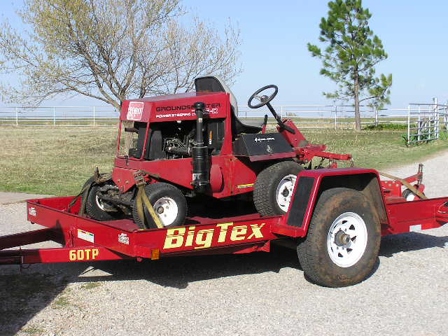

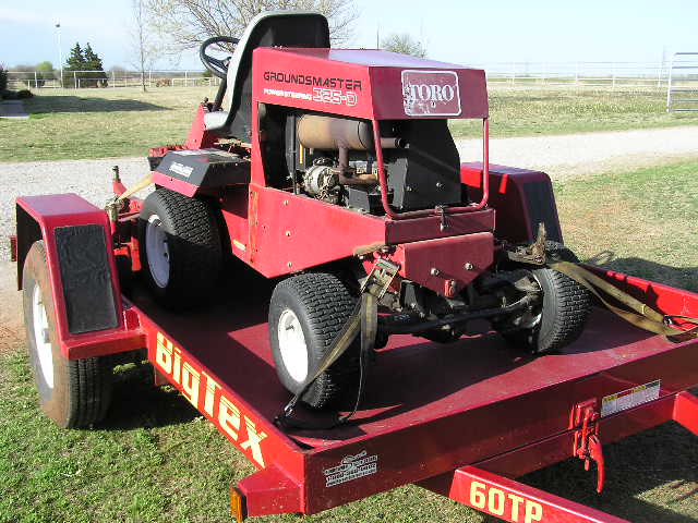

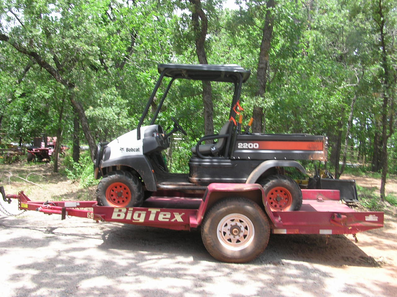

Why?
I have a 6.5 x 12' tilt, with a 6K single axle that is very handy.

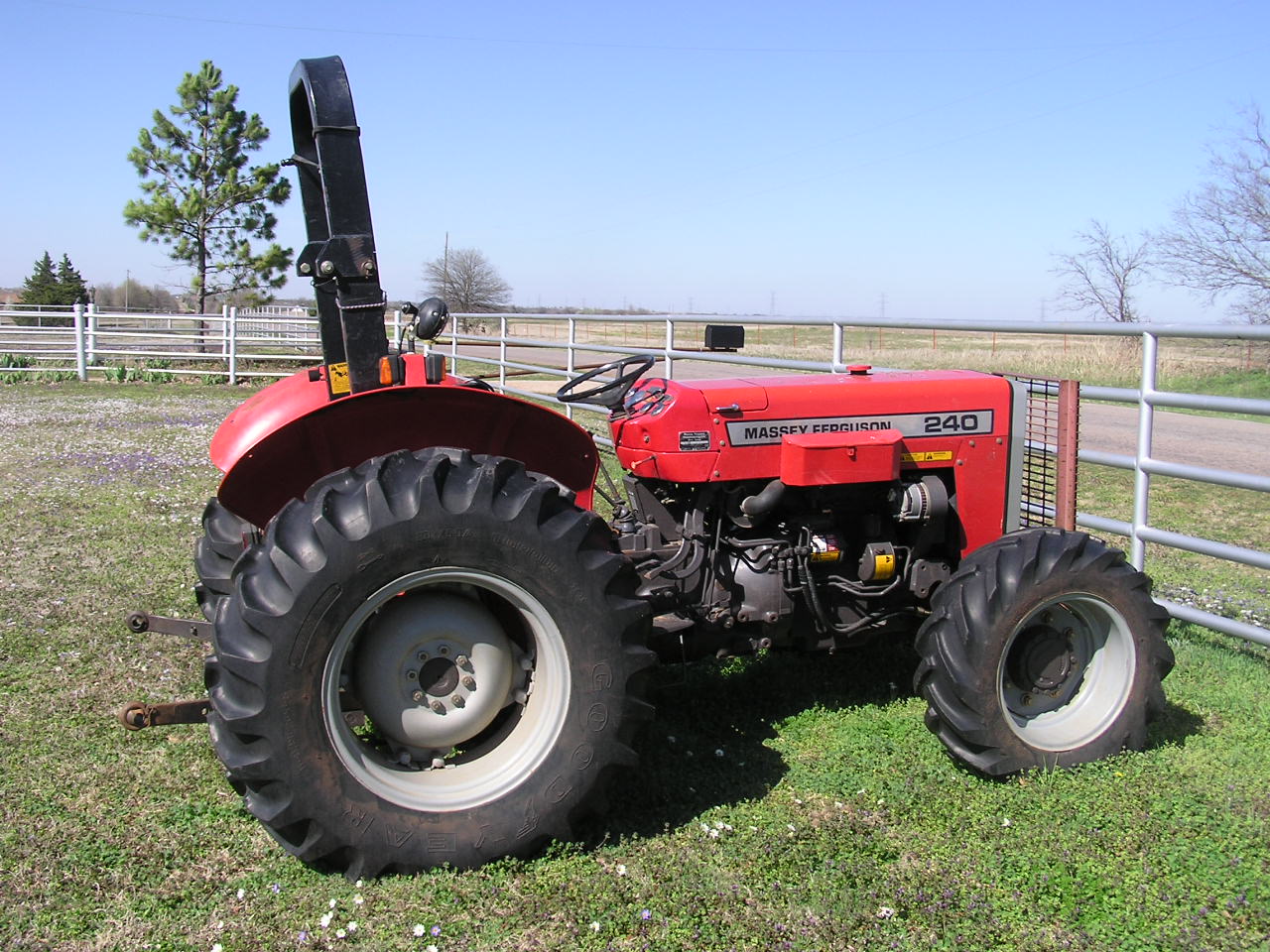

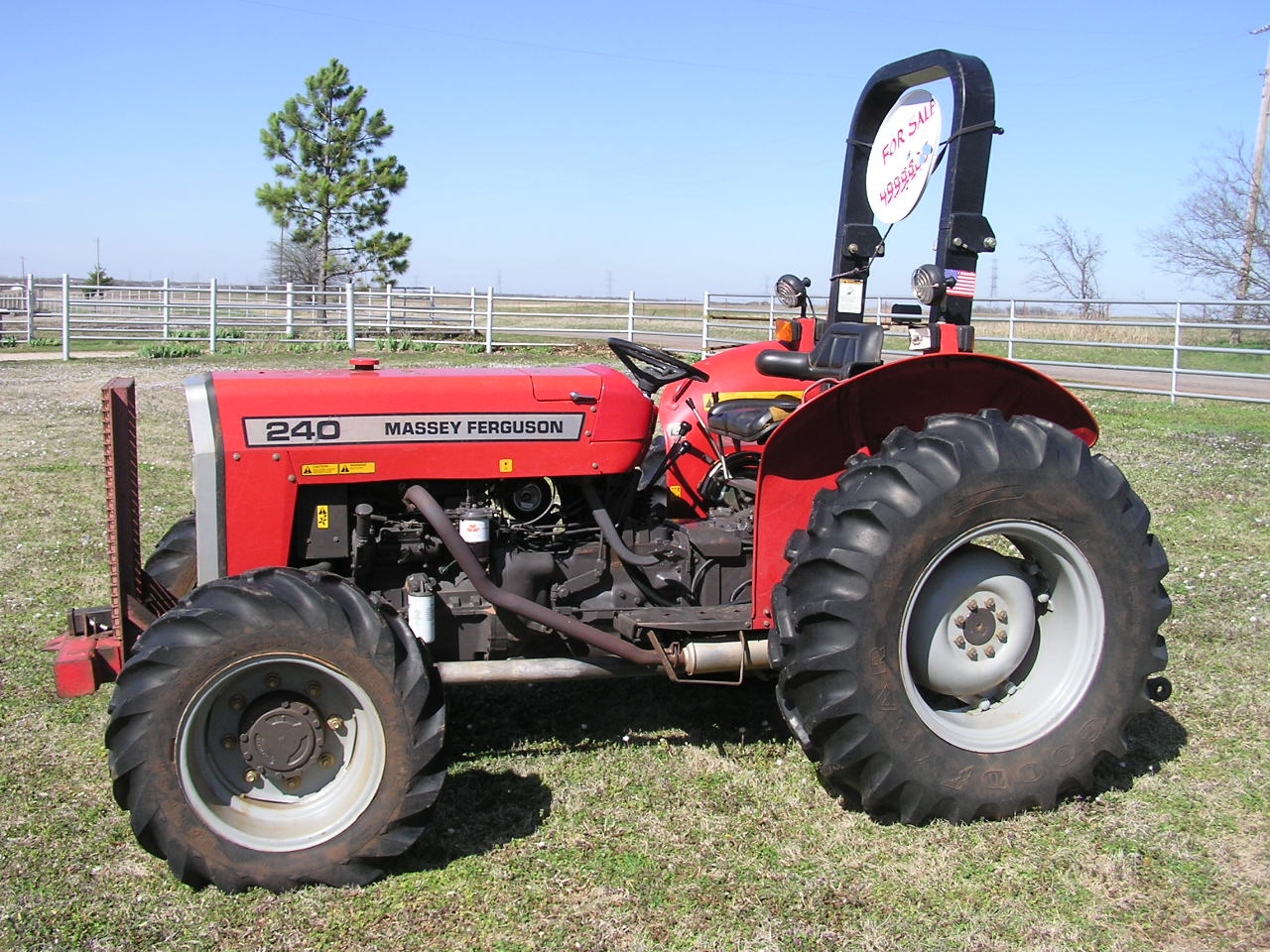

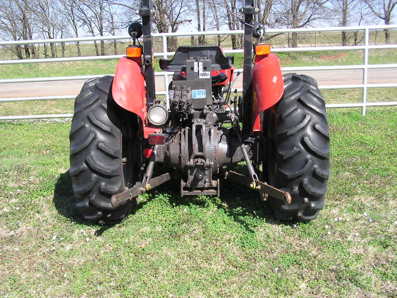

Even hauled my old tractor on it, back in the day. :D

A single that out weighs a tow vehicle. Been there done that. I won't sell or tow them anymore. Just hope you never have a blow out at 65mph with a single axle trailer loaded to 6K.

My 3/4 ton GMC Duramax weighs 7300, front axle 4100, rear axle 3200. The empty weight on the trailer axle is 1660 lbs, tires are rated at 3640 lbs. each. So I have no qualms pulling it.
I have had blowouts on a single axle horse trailer, but it was a gooseneck, so no problem.

To each his own. I tow about 10000 miles a year and even with my 7600 lb F350 I would not want a single that high. I tow as much as 25000 lbs with my truck but that is a tri axle.
