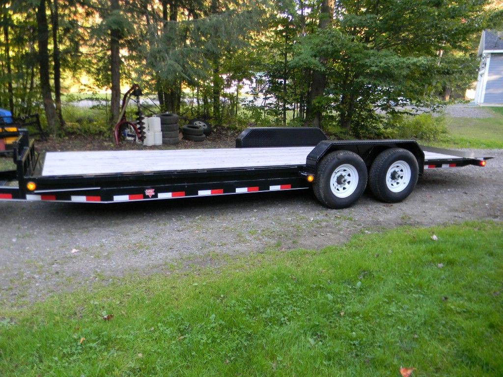

I have a PJ model TF 22' 14K tilt bed trailer for hauling my LS 3037HC, cars, trucks, etc. It is listed at 22' but the deck is actually 23'. It is a great hauler. I tow with a Chevy 2500HD. I've had tilt beds for the last 15 years and like them much better since I don't have to use ramps. My previous trailer was a 20' tilt and I didn't have much wiggle room fore and aft to balance the load.
Not familiar with Currahee or GPS brand. I don't think there are any dealers near me. Tilt beds do cost a bit more but no ramps to worry about. Bought mine from a dealer about 50 miles away. Price was about $6800 incl. tax but that was in 2014. I think quality is excellent.

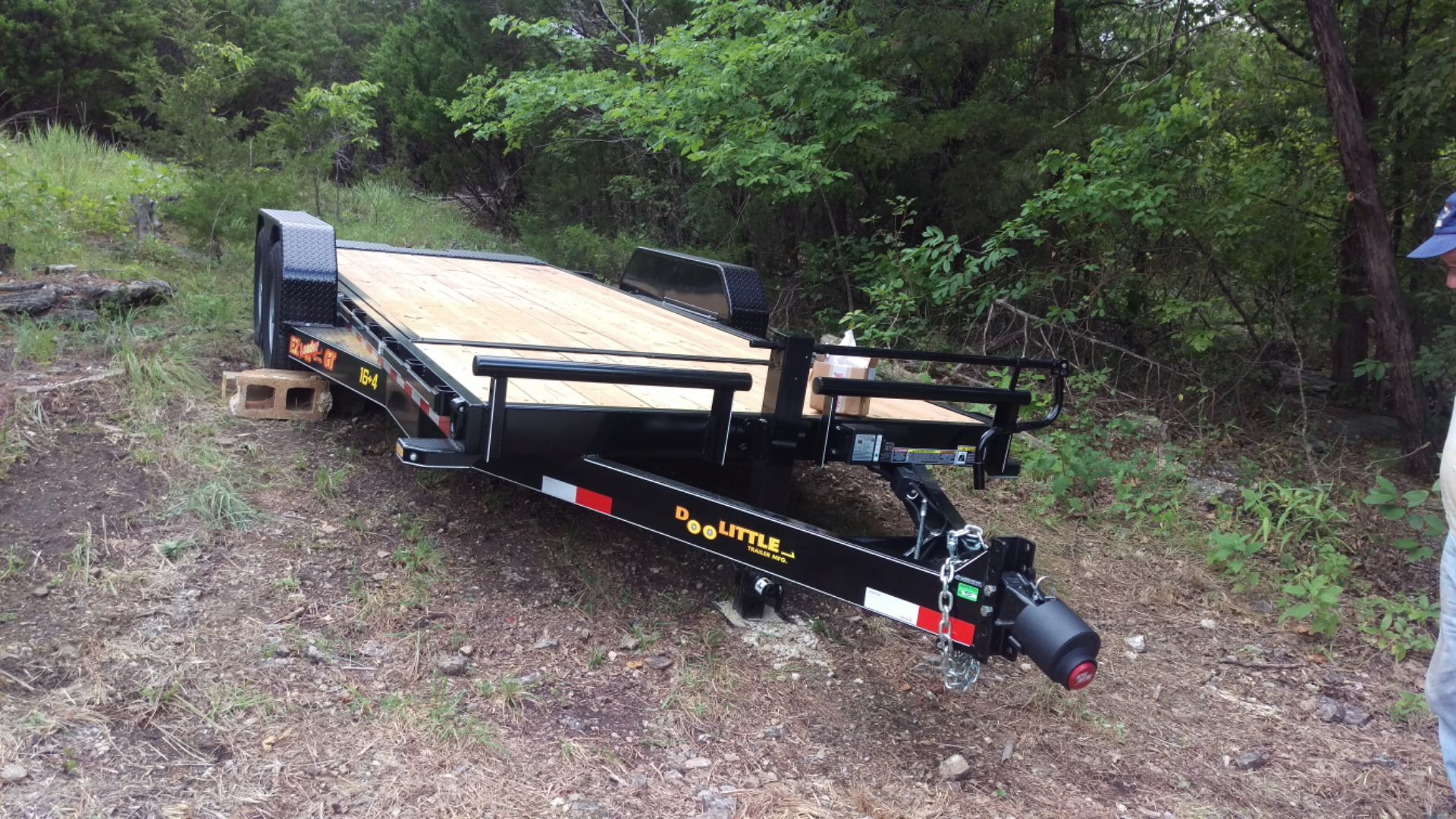

This is my 14K tilt bed DooLittle trailer. This is before I added the tire mount, front toolbox, solar panel to charge the battery and added GPS tracker, 8 additional marker light on each side, and added more turn-brake led to the rear. The offset jack was upgraded to 12K and has a adjustable coupler mount. Watch to see tire size matches weight wanted. It also has bolt on fenders (some have drive over fenders). I also added a 9K winch. It also has spaces on both sides for steps to get on and off.
You have a great truck for going gooseneck or any other mount for a trailer. This trailer is 20'. I did not have room to park anything longer or gooseneck. But I also use the truck bed space when I travel with the trailer. Ever foot of space on a trailer will become prime real estate. 22' is good and there will be times you will wish to have the 24'. I have 20', and sometimes wish it were 22'.
A little word of caution - Any added feature is great. BUT, if you buy a trailer that is not well built and DOES NOT track well, you will never be comfortable when traveling with it, especially loaded.
I have had several tilt beds. This is the best trailer I have ever had. It is a jewel. And it was priced like a jewel also.
A toolbox will become important as you look for places to store those chain binders you want to use. I keep my chains stretched out on the front deck of the trailer - otherwise they go into the toolbox also.
I installed a GPS tracker - hoping to prevent or locate if stolen. But then I talked with my Ins agent. I had it insured - only cost $23 every six months. I think that is the best way to not worry about that. That coupler lock is made by Proven Industries in Canada. 14" hardened plate. If you use bumper, you may want to look at that.

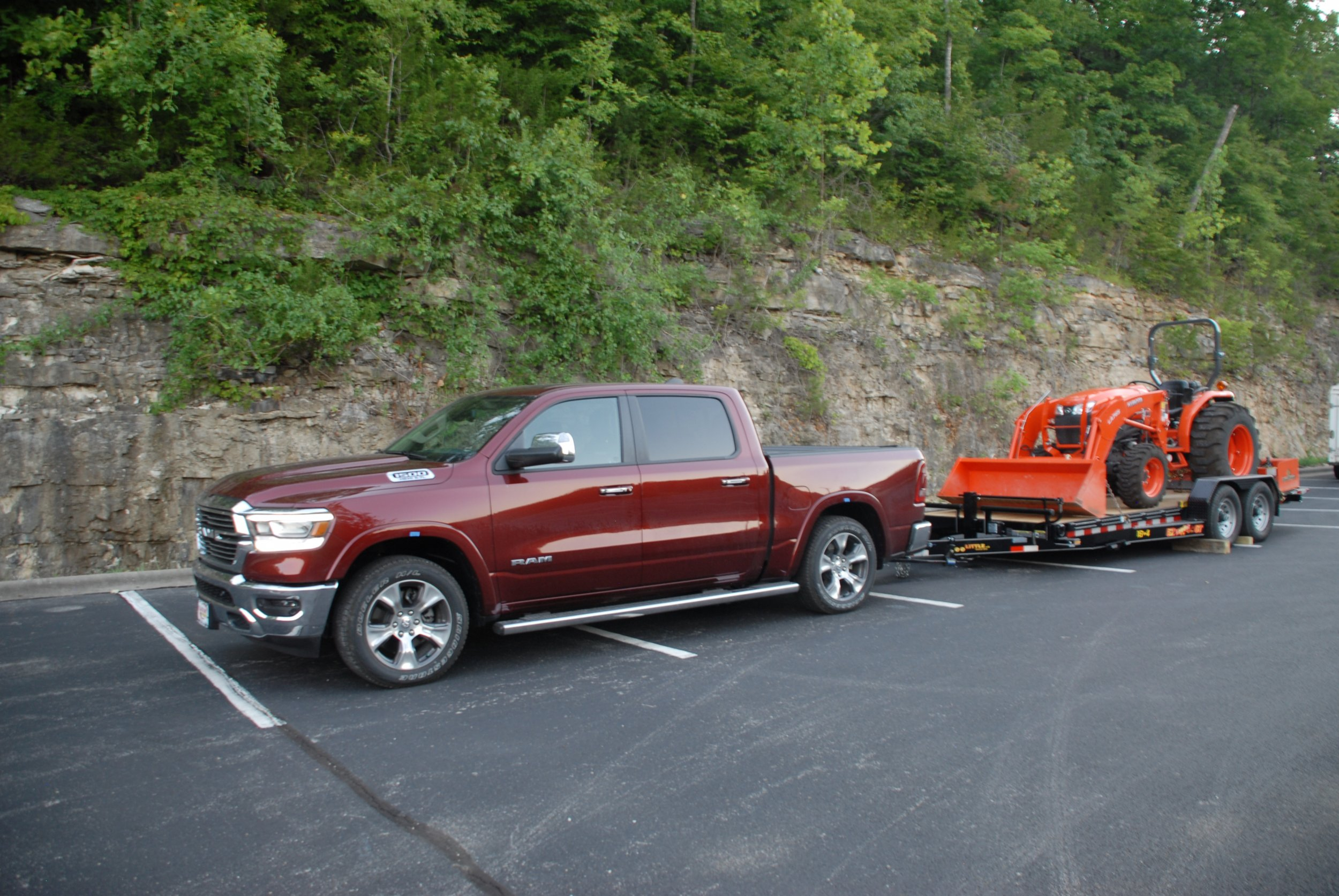

Thanks, for all the replies, and for all the info. For the record I originally was looking for a gooseneck, but after weighing out many factors I decided that a BP was going to be the better route for me. I did get to go look at the Currahee brand trailer yesterday and the quality was good but they had sold the 24ft 14k and only had a 20ft 10k left in stock. The price was "good" on the 20ft but I have about convinced myself that 22ft is now my minimum length and I really want to stay with a 14k, as somewhere in my future I have asperations to buy more equipment like a skid steer/ track loader, mini excavator or possibly a bigger tractor. I am planning on going today to look at the GPS brand trailer (in 22ft) so I will let you know what that looks like. But for reference I have hauled this setup on a 16ft car hauler more than once, so for comparison a 20ft would feel like loading it on an aircraft carrier, lol.

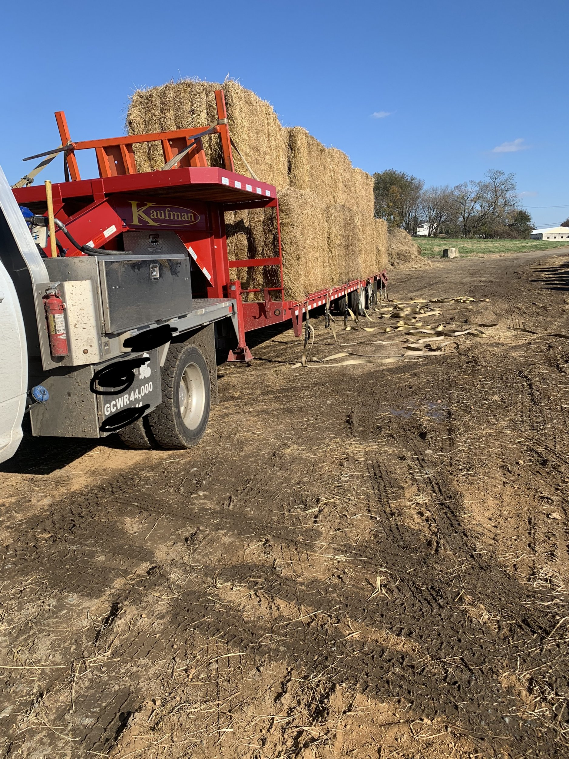

After running gooseneck trailers for the last 20 years, I wouldnt go back to a bumper pull for bigger jobs. For heavier loads, a GN puts the hitch weight further forward over the rear axle, greatly extending load capacity. Handling is greatly improved, too. I can back my GN’s up at a 90* angle to the truck, where a BP is limited to about 45*.
A GN allows the operator to use the full towing and GCWR of a truck, where a BP does not utilize full GCWR or towing capacity. Another nice GN feature everyone should have is a deck on the neck. An 8x8 deck on the neck literally gives you another truck bed worth of storage for buckets, bale spears or other loader mounted attachments, tools, wheelbarrows, whatever you can strap down.
Bumper pulls are fine on bigger trucks, like dump trucks since thats all they can tow, but when it comes to lighter trucks like a 250/350/450/550/5500 or anything with a non dumping bed, a GN gives you so much more versatility, load capacity and storage. A bumper pull will give you your full bed, where a GN will leave you with about 1/2-3/4 your bed, but the deck on the neck gives it all back and more.
I rarely see a GN owner switch to a bumper pull, but I see almost all GN owners used to be bumper pull owners.

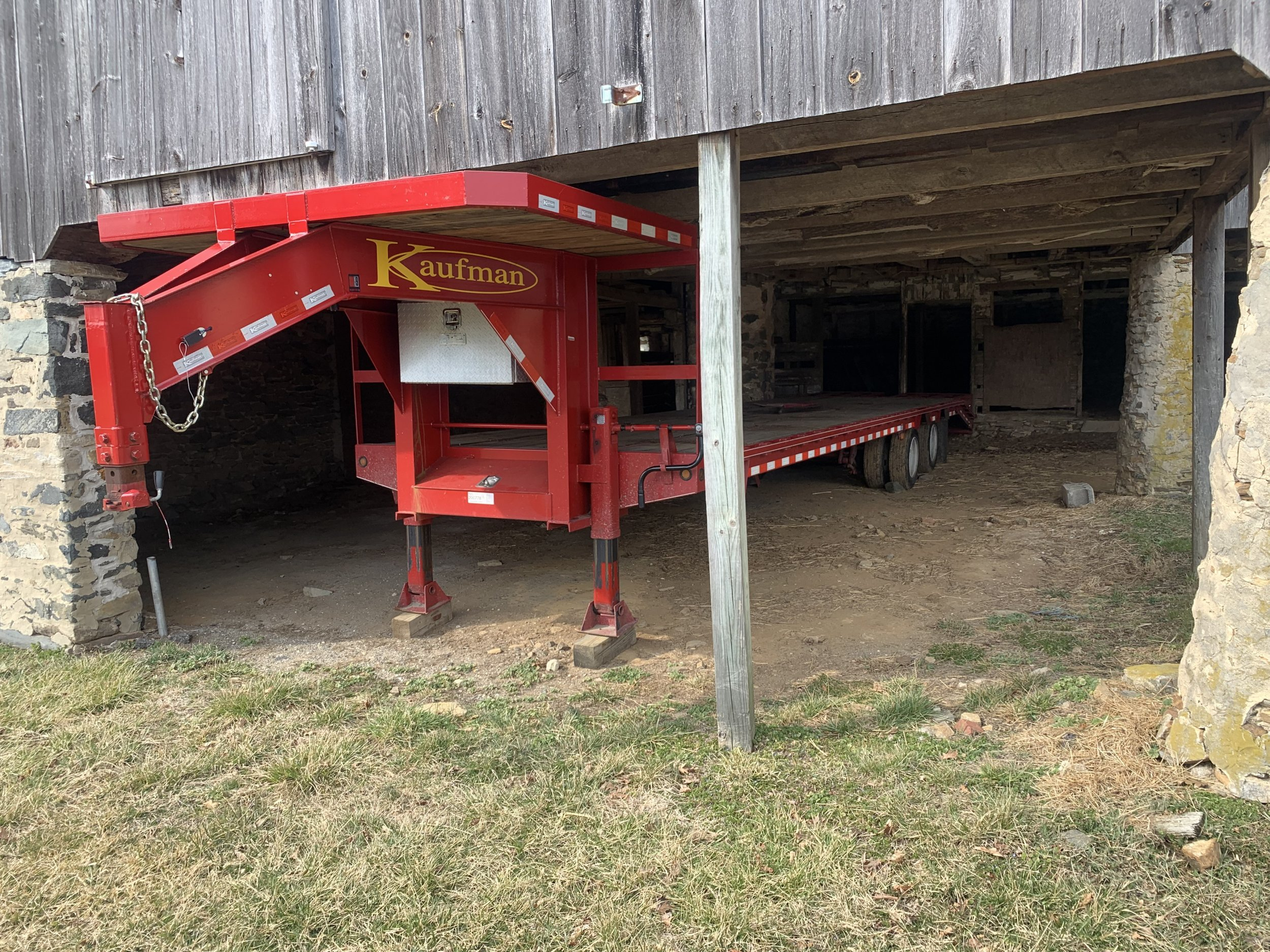

Heres my 35’ GN with 8x8 deck on the neck.
Now I have 43’ of storage platform.
Heres one of mine with a dual bale spear up top. I could store much more up there. Anything a person or a tractor loader can stow up there could be carried.
