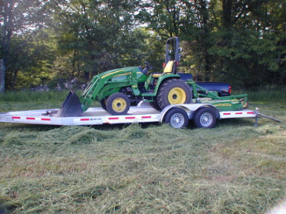

Thanks for all the replys. It looks very much like the trailer in the first photo. I am going to pretty much scrap the idea than and just go back on the hunt for a regular equipment trailer, which is what I was initially doing, just thought that this might do the job. Thanks for all the help to all of you.

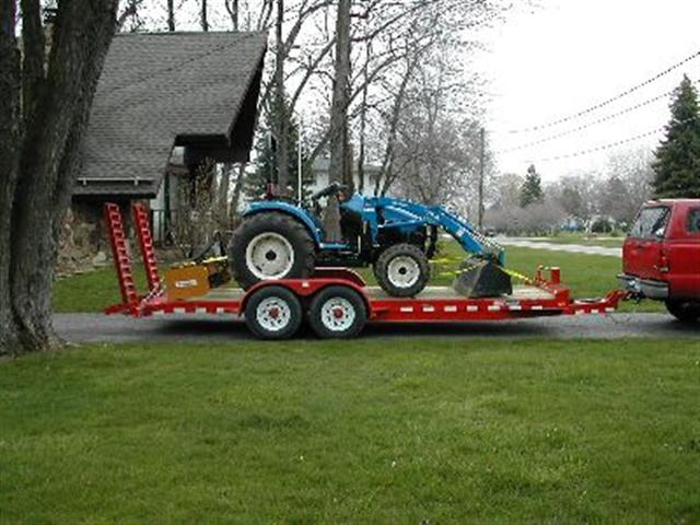

Brian; Ah, Marine City. I originated in St. Clair. I think an equipment trailer might fit your needs better myself. The ramps on mine are angled backwards in the upright position, and have extensions that act as jacks when the ramps are lowered. I can load equipment with out having to be hookedup to the truck. It's a MacLander 12K. Antique Auto Sales here in Monroe sell them, and I think they might have a place in New Boston also. Since the price of steel has gone up, the 16' ones are right around $4000. My twenty footer ran me $3800 a year and a half ago. I stick to the belief that you usually get what you pay for. If your interested in one, let me know, and I'll get a price for you. /forums/images/graemlins/grin.gif

St. Clair is nice town. I like it much better than Marine City. I actually live just outside of Marine City in Cottrellville. Your trailer looks nice. I am just uncertain if I want to spend that much. I don't intend to use it that often, probably 4-5 times a year at most. I am going to do some more shopping this Saturday. If nothing comes up, I may ask you for that pricing and info yet.

John,
I loaded my tractor for the short trip to my brothers last weekend. After loading I noticed a floorboard seemed awry and upon inspection I saw that it's rotted out.
I guess what I'm saying is that I'M JEALOUS OF YOUR REALLY NICE TRAILER!!!!! /forums/images/graemlins/laugh.gif
