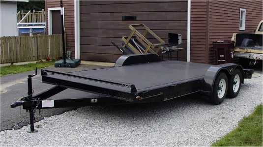

Its rated at 7000#. It weighs 1500, so I could put 5500 on it if my tow vehicle could handle it.
It can't /w3tcompact/icons/laugh.gif
Right now, all I have to tow it is my 93 chevy 3/4 ton van with short wheel base and V6. It hardly noticed it coming home about 25 miles the other day, but that was an empty trailer.
My Power Trac weighs less than 1500 and the implements don't total 1000, so I'll probably only be hauling 4000 total including the trailer. And I will only use it to go to my property about 9 miles away two or three times a year and over to the little league several times a year, which is only about a mile. If I was going to do any distance or frequent towing I'd get a proper tow vehicle. but this is a fine setup for now. /w3tcompact/icons/smile.gif

Appreciate the pictures and updates on this new project. That is one very fine trailer. I have stopped by trailer lots to see what is on the market for a number of months. Still undecided as to length but want something that can haul dirt and mulch along with the tractor and FEL. The comments regarding the hitch are very interesting.
