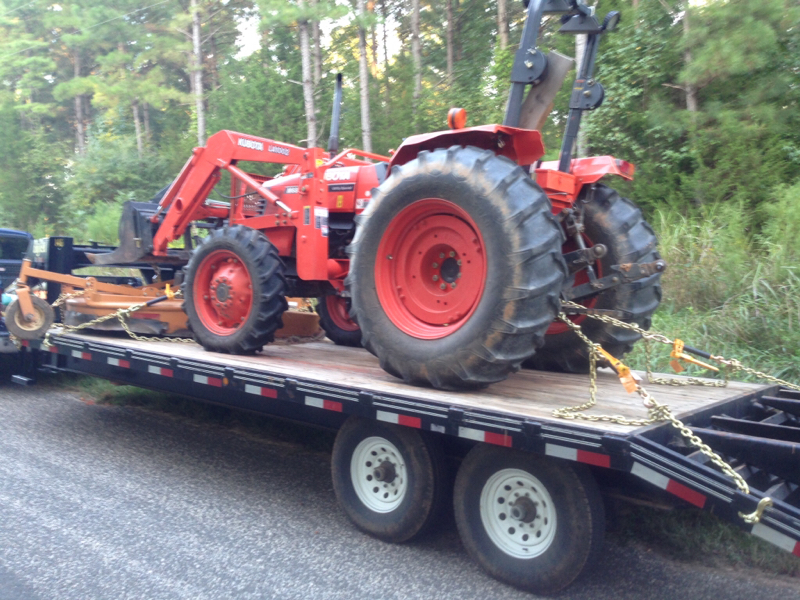

My tractor with a grapple and rotary cutter is long! I have to pull forward with my FEL up to allow the ramps to fold back up flat. But then I can back up to center the weight and get my FEL down flat. It's not a problem
But a trailer is rarely too long, but often too short!

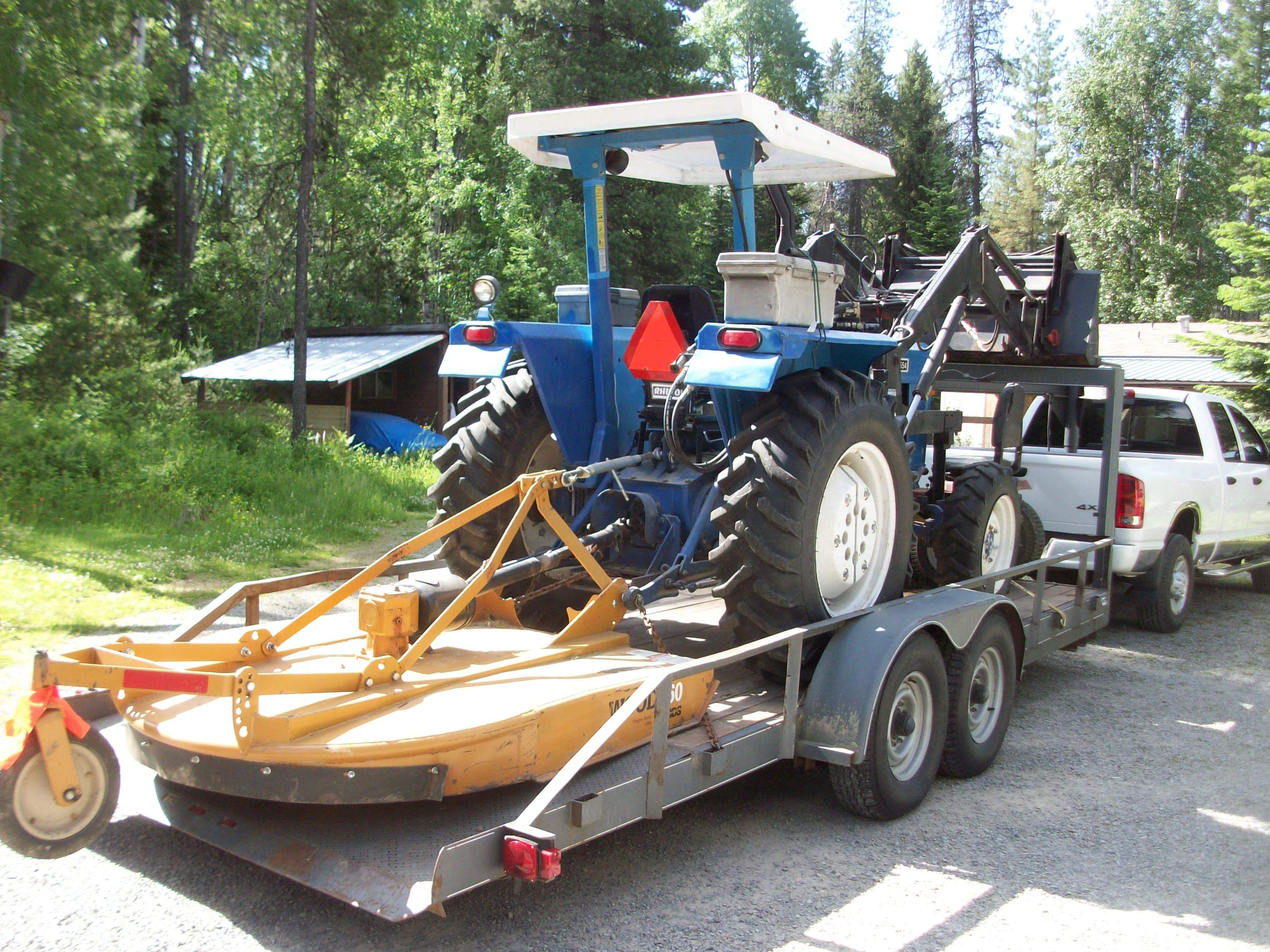

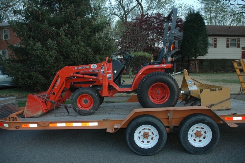

I'm in the process of buying a tractor, about 40-45hp and will also need a trailer. I most likely will be moving it with a brush hog or snowblower attached. What length is good, should i get folding ramps or hidden. I was thinking the folding might get in the way if I hang over back. How about width, I'm seeing 7' and 8.5'?
This is a 50HP tractor on a 16+2 BP Hudson equipment trailer.
This is a 23HP tractor with a Box Blade on the same trailer when I bought the package.
Notice the extra room.
IF you get sliding ramps get some support. I like my folding ramps.
Get plenty of stake pockets. My equipment trailer only has 4.
Make sure you've got enough width. When I bought my trailer in '09 (it came with the tractor) 80" was plenty wide. In 2014 I had to reset my tractor rear tires to squeeze the new to me M4700 tractor between the fenders.
But also consider where you are going to haul it. My trailer barely fits in my suburban driveway.

This is a 50HP tractor on a 16+2 BP Hudson equipment trailer. <img src="http://www.tractorbynet.com/forums/files/trailers-transportation/442267-trailer-sizes-style-recomnedations-40hp-20140427_103025-jpg"/> This is a 23HP tractor with a Box Blade on the same trailer when I bought the package. <img src="http://www.tractorbynet.com/forums/files/trailers-transportation/442268-trailer-sizes-style-recomnedations-40hp-tractor-n-trailer9x6-jpg"/> Notice the extra room. IF you get sliding ramps get some support. I like my folding ramps. Get plenty of stake pockets. My equipment trailer only has 4. Make sure you've got enough width. When I bought my trailer in '09 (it came with the tractor) 80" was plenty wide. In 2014 I had to reset my tractor rear tires to squeeze the new to me M4700 tractor between the fenders. But also consider where you are going to haul it. My trailer barely fits in my suburban driveway.
That shows that the 16 +2 isn't big enough if he has a rotary cutter attached. It's amazing how long a tractor, FEL and a bush hog can get. Even more with a grapple. Often I also want to make one trip. I'll throw on a box blade as well. Get a 25 footer if your truck and budget will handle it .

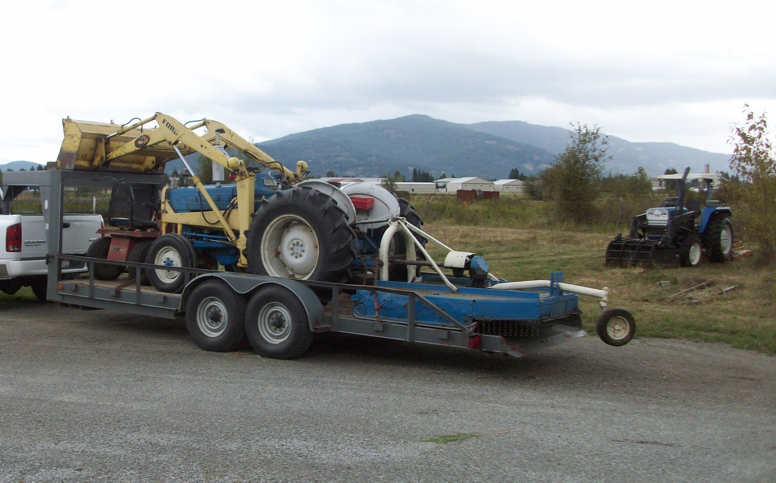

Here's what i use for my 55 hp with loader and Brush hog, it tilts so no ramps needed. 20 foot x 82" no extra room at 20 foot. I realize my tractor is a little larger than most 40-45hp tractors but it shows just how fast you can run out of space...
It works well for my uses and being a fifth wheel and having a low center of gravity it sure pulls nice.
actually here is a picture of my 40 hp pto ford 3000 on the trailer to-still not much extra room...although i did get an 18 hp riding mower parked in front of the ford.
lots of great options out there good Luck

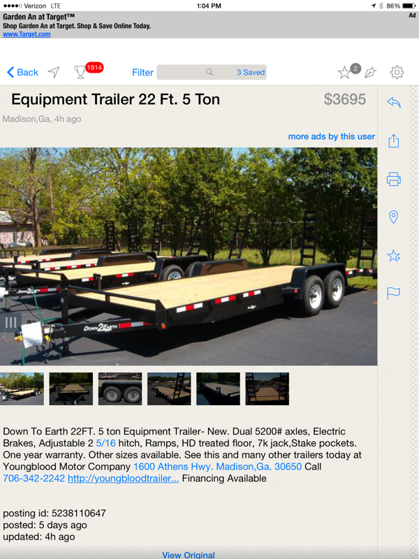

I'm not familiar with the tow ratings of your truck . I imagine it will be at its upper limits. Saw this trailer locally and I like the style if your truck could handle it
