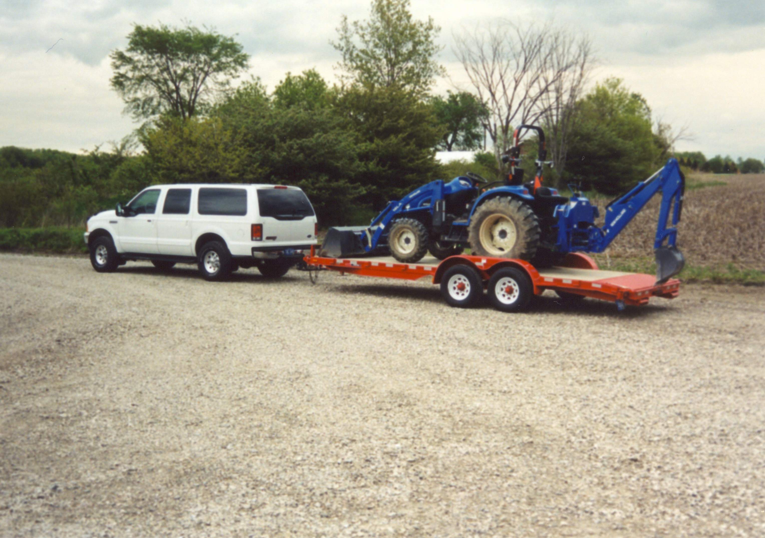

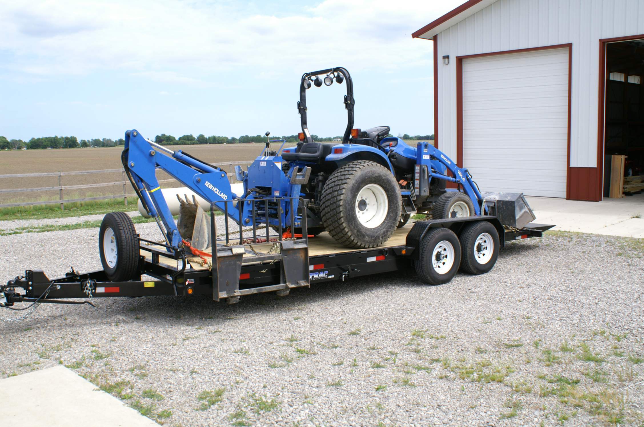

Here is a picture of my old 40HP New Holland TC40D with a backhoe and loader. A good 6ft rotary cutter will stick around 8 ft behind the tractor. Add a loader and you are probable close to the length of mine with the backhoe. The trailer is a 22ft tilt deck and rated for 14K.
Here is the same setup on a 20ft 10K trailer. I traded up to the larger trailer because I could not balance the tractor properly on the trailer to maintain the right tongue weight. Before the safety police chime in. No it is not chained down. I pulled on the trailer to see if it would fit which it did not. Never moved the truck, just took the picture to show the wife why I needed the new trailer.

I would recommend that you look at a minimum 20ft preferably 22+ and 12K or heavier. To be sure you will need to do some research on the exact model of tractor you are looking at and determine how much capacity you need. The weights can add up quickly. As for the style, you will get hundreds of opinions, but only you know how you will use it. Each style has their advantages and disadvantages. The other thing you need to verify is how much you truck can pull. That will open a whole new debate. :D

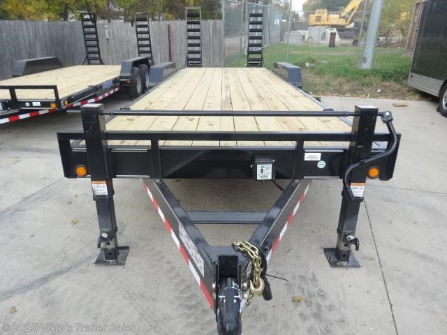

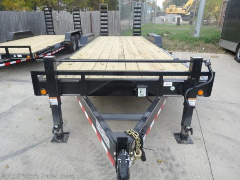

Learn from my mistake of getting a 20' trailer that is too short. Get a 24' long 83" wide dual 7000 pound dexter axle Load n Trail with tip up ramps. Life is too short for slide in ramps.
I like the double front tongue jacks... have not seen that before.
