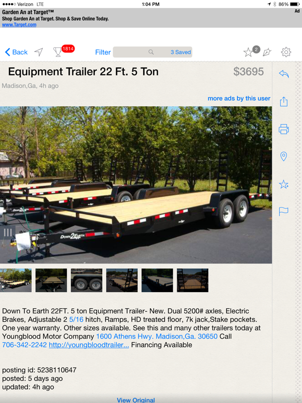

I'm not familiar with the tow ratings of your truck . I imagine it will be at its upper limits. Saw this trailer locally and I like the style if your truck could handle it
Sent from my iPad using TractorByNet
That trailer is about right. You might get away with a 20 footer if you want. I would go no shorter.

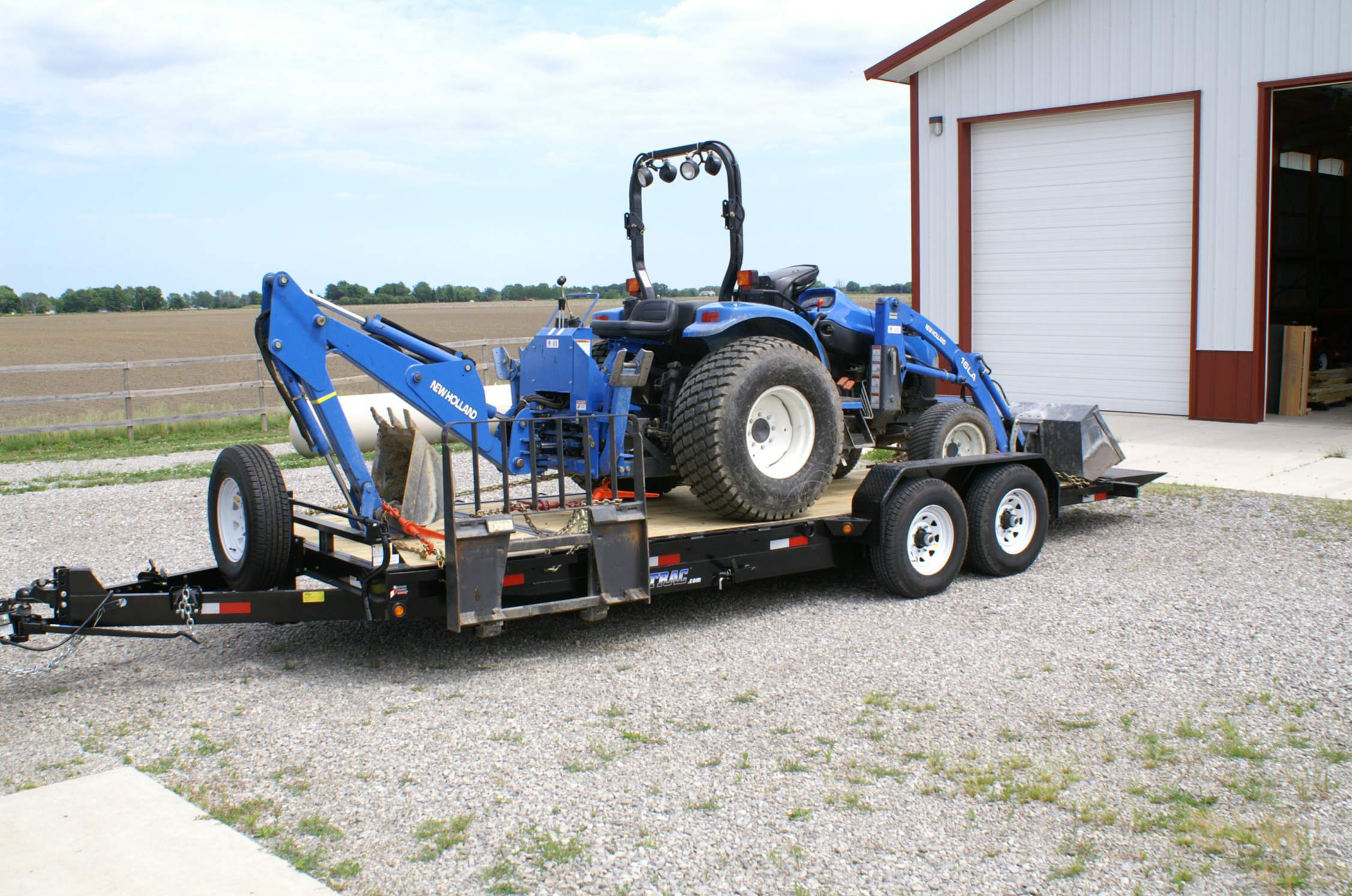

Here is a picture of my old 40HP New Holland TC40D with a backhoe and loader. A good 6ft rotary cutter will stick around 8 ft behind the tractor. Add a loader and you are probable close to the length of mine with the backhoe. The trailer is a 22ft tilt deck and rated for 14K.
We have a TC40D also and a 22' trailer similar to the one in the picture. Our has a beaver tail and stand up ramps. Not only do the ramps help with backing up the trailer when empty, they provide a place to bungie, if needed.
We pull ours with a Nissan Titan and/or a Toyota Tundra. Both handle it quite well.
One other difference, we position the tractor facing forward instead of the way it is pictured here.
