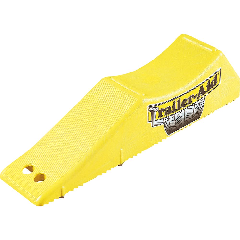

I'm planning on getting one of these for tire changes, etc. I might even get two and leave the trailer parked up on them to keep it out of the dirt. Probably a little better than a left over piece of treated lumber.

I would stay away from them. I'm in the trailer business part time and have seen many bent axles due to them. Placing all that load on one axle overloads it.
Chris
Even with an unloaded trailer? So what do you do when you have a flat on a loaded trailer? Seems like any jack point on the frame would be liable to frame failure with a loaded trailer too.
   / Trailer Storage #9
Maybe not on a unloaded but we've seen plenty of bent axles from it.
I always tell everyone to Jack from the axle as close as possible to the spring perches. I carry a short 16,000# Bottle Jack in all my town vehicles with some wood cribbage to make it possible for any situation.
