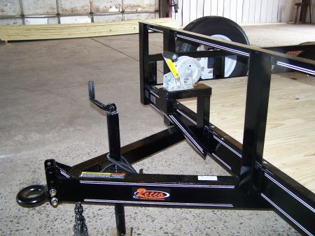

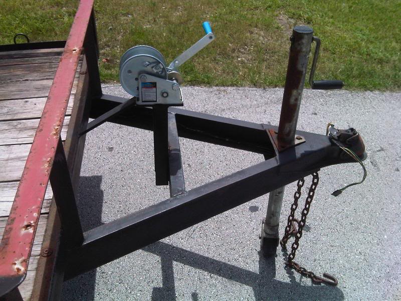

I am thinking about adding a winch to the front of my small trailer in case I need to get my lawnmower on if the motor fails and I need to bring it to the shop. I would appreciate any photos and details how you added one to your trailer.Thanks

We just bought the winch, cable, and the hook from northern. I don't weld either but a friend of mine mounted it to the front of the trailer with some angle iron. I will try a get a photo tomorrow for you. It's a very simple setup.

Some ideas:
If you have a straight tongue, boat trailer winch posts are made to bolt on. Then bolt the winch on top. No welding needed.

Here is the winch on my car trailer. It is removable and will fit a 2'' trailer hitch.

Norman,
The upright for the winch mount on the car trailer is 2x2 box tubing.
I took some pictures of my utility trailer winch setup today.
With this setup you can use anything that will hook into a 2" receiver. I have a ball that I can haul latch a wood splitter on to haul. (Yes, the ball mount is bent. A guy ran into me with truck with a snow plow on bent it. This is all I use it for.)
You said you had a boat winch. Does it have a strap on it or a cable? I had a strap hand winch on a car trailer and it did not work good. The strap would get all messed up/ twist over if you could not pull straight on it. I traded it to a guy for a hand winch with a cable on it. Even if you go with a hand winch I still recommend you make it removable that way you can take it off and keep it out of the weather.
I got the 2'' receiver portion at harbor freight. ATV Hitch Adapter
