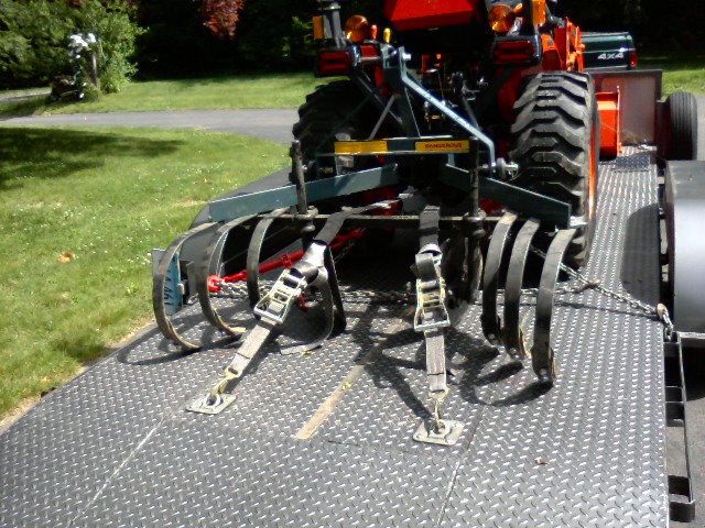

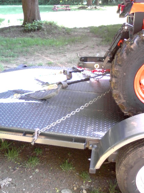

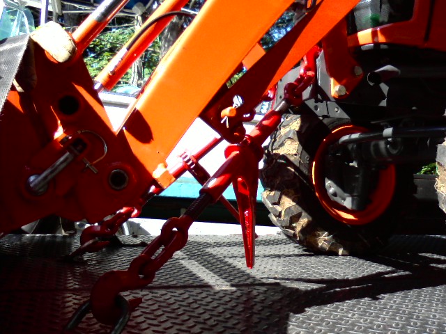

OK so how about a few comments from the trailer experts here on how I am tying down my B2920 to my trailer.
I am not looking for the Chain / Binders vs Strapping arguments but more about where on the tractor I am tying to (or should be tying to).

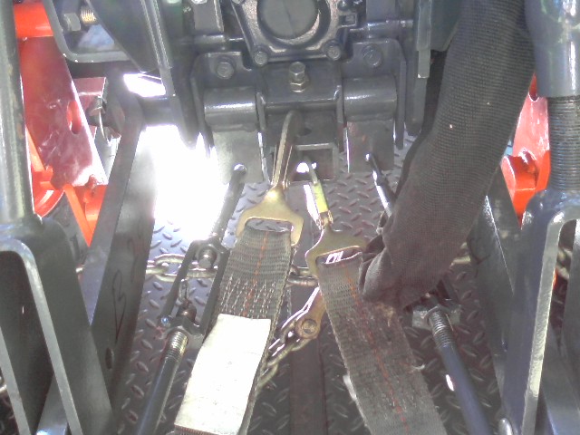

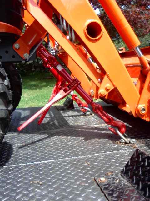

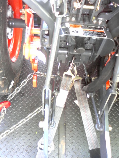

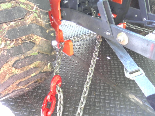

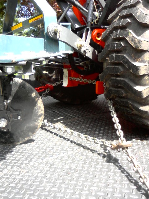

I am having a devil of a time finding an area to clamp to in the back. As you can see I am looping (or should I say "nesting") a chain in the BH wells and using the holes in the DrawBar with the hooks of strapping. Can anyone give me any idea how can I solidly can tie down the rear?
As for the front - there are D Rings right under the front frame plate so I just loop the ratchet binders without the need of chain. In one pic you will see I trailered the tractor with my cultivator / hiller implement so I strapped over the cultivator bar since the webbing would have been cut like a knife through butter from the hiller discs. I did use heavy padding between the bar and the nylon web of the strap. I also tie down the loader with the strap as well.
Thanks in advance.
~jim

What you are doing looks secure enough. The backhoe hooks are fine...Those chains are not likely to pop out of those hooks.
I installed a large shackle thru my draw bar. A 3/4 shacke and then 2 1" shackles for the chains to run thru...
I have seen hooks or D rings welded on the rear for chains, but your BH hooks are acting as the same..

The only other place might be on the inside of each rear tire over the axle. It might be a pain to attach but you know the machine would never go anywhere!

Hi Jim,
I have 3/4 shackle thru the draw bar permantly, (i always leave it in) I think I had to bore out the draw bar a touch so the pin would fit...
Then toss on 2 more shackles thru the one mounted already 3/4 or 1" with your chains and you are in great shape.
You CAN fit one chain thru 5/16 (not 3/8) thru the shackle on the draw bar but can get the second chain thur UNLESS you remove the shackle each time and run both chains thru before connecting to the draw bar.
There are a few ways to skin this cat. I like leaving the shackle in place so I always have it for pulling stuff with chains etc..or pulling the tractor out :rolleyes:
Pretty much the same...clevis / shackle, pin vs threads...where ever you got your chains should have them...
This makes a great rear tie down area, chains or staps...
Good luck

Ditto that. Recently brought a JD755 back from upstate NY for a friend. I looped the strap over the inside of the tires (around the axle), doubling the strap (and it's streangth). I took both side of the strap to the opposite corner of the trailer, in effect tieing the right side rear axle to the left rear of the trailer and visa versa.
Always better to double, always better to cross.

My only point was that if I had an accident (run into a wall, rear-end a car or truck) the last thing I want to worry about is my 5 - 7,000 lb tractor coming through my back window. I would feel much better with something that captures the chain. Even if the chain became loose it would still stop the tractor. If the chain became loose with it running over the BH hooks it could pop out when the tractor tried to move forward in an accident., I know he still has the straps, but I don't know how I feel about the hooks in the draw bar pin holes. I would have the chain through the BH hooks, and a chain through a clevis/shackle on the draw bar. Maybe the way I would do it is overkill, but If I prepare for the worst then I shouldn't have anything to worry about.

I agree with you. I wasnt really comfortable with just the BH hooks and the idea of usinig a Clevis or Shackle really sits well with me. I always over strap in the past for redundancy and always had a meaty part of my former BX22 frame to hook or strap onto. This is my first year with not only my new B2920 but also working with chains and binders so when I went to hook up for the first few tims I was stratching my head until the replys on this post told me to utilize Shackles off the draw bar.
