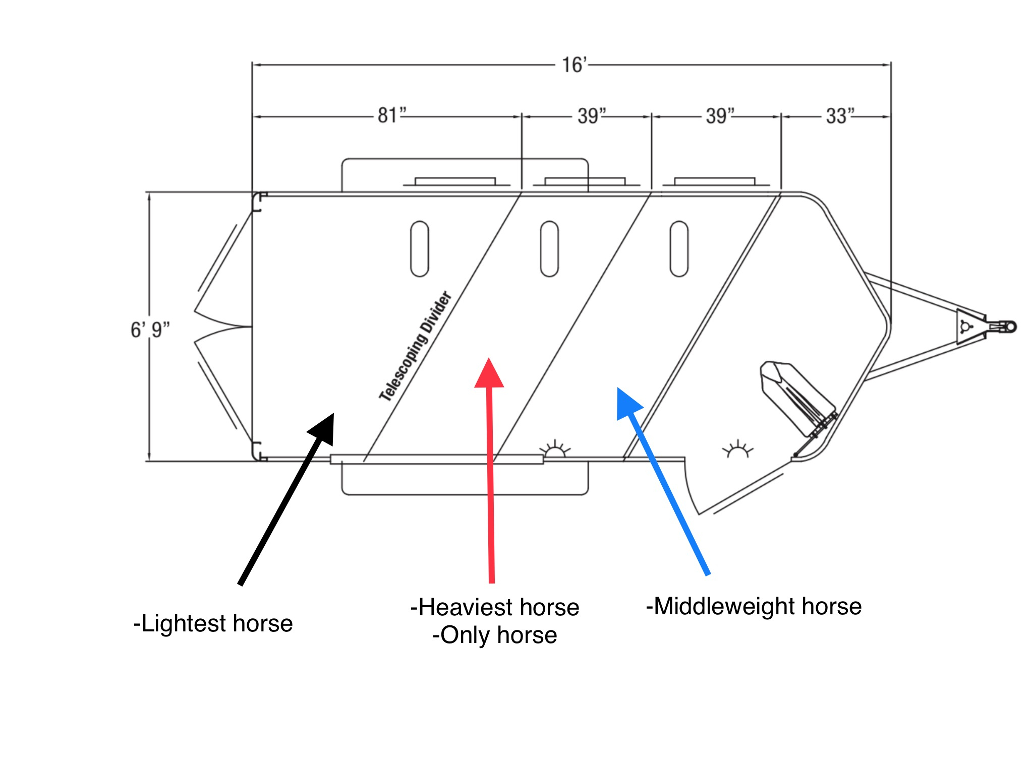

Horses over the axles. Wheels are far enough back that they won't act as a pivot point and make the tongue weight too light.

I have used a Chevrolet Suburban (2) to pull my horse trailers over 250,000 miles. The trailer alone (no horses ) puts a proper load on the tongue/hitch. I try to get the horse weight over the axles, without adding much weight to the hitch or lightening the load on the hitch (which can be very dangerous). I pull an old steel Delta 2 horse slant (2500 lb empty, small front tack room). My biggest challenge is finding tires that will hold up to high speed expressway trips when fully loaded. I race thoroughbreds ...1100 lb aprox.

Doesn't you Suburban/Yukon have a leveling system as part of the tow package. Our Yukon has it. When you shut off the ignition the system may bleed down, thus the sag between the vehicles. Also,as previously mentioned you might want to consider a load leveling hitch with the torsion bars to help distribute the weight. We have a two horse trailer and it levels fine. I would put the horses in the rear and center stalls.
