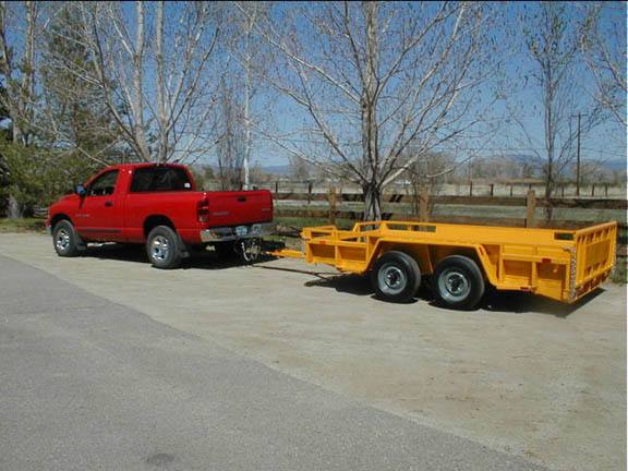

<font color="black"> </font> I have something very close, its an old U-Haul auto carrier that I completely rebuilt. It has a front jack which lets the bed articulate to lower the rear to the ground, and then a large tailgate that lowers like a ramp. The end result is a trailer bed thats almost flat with just a slight incline. It works VERY well and the rig has an extermely low center of gravity and a long tongue so it pulls like a dream. GVW is about 7000#, not made for a really big tractor, but plenty for a typical small CUT. It also allows a 90 deg hookup. pics to follow
BTW, U-Haul currently does NOT sell trailers, if you find an older unit be absolutely sure its not stolen. I called the U-Haul corporate headquarters and ran the VIN before I bought it to be 100% sure it indeed was legal.

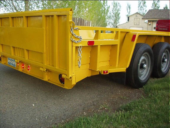

pic 2- The actual bed with everything folded up is 12', however the front panel folds down as well as the tail gate to extend the bed to 16' plus another 3 feet over the tongue. Kinda handy arrangement.

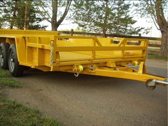

pic 3 The fold down tailgate that either acts as a bed extension or a drive up ramp
