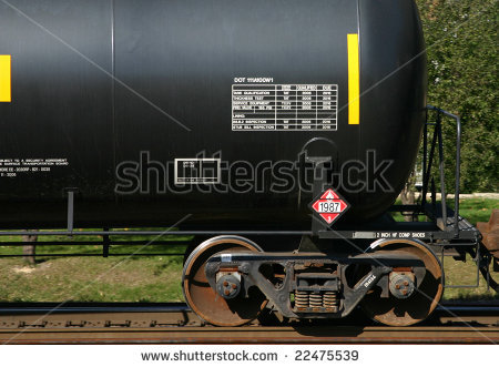

   / Train - hazardous cargo "accident" #265
The railroad industry and the federal government have long kept secret what dangerous goods are transported through municipalities, citing fears for security should the public know what is riding the rails past their homes.
But it's easy to find out.[/I]
Not very secret. Read the placard number, then look it up here (link below) or many other places.
Search for Placards by UN Number
1987 is alcohol.
Bruce
#266
1987 is alcohol.
Bruce
Agreed.... anybody remotely familiar with rail, EMS, or transportation in general knows. Even a semi-intelligent "bad guy" would have figured it out the first month the system was in place.... the slower ones, 3-4 months max.
