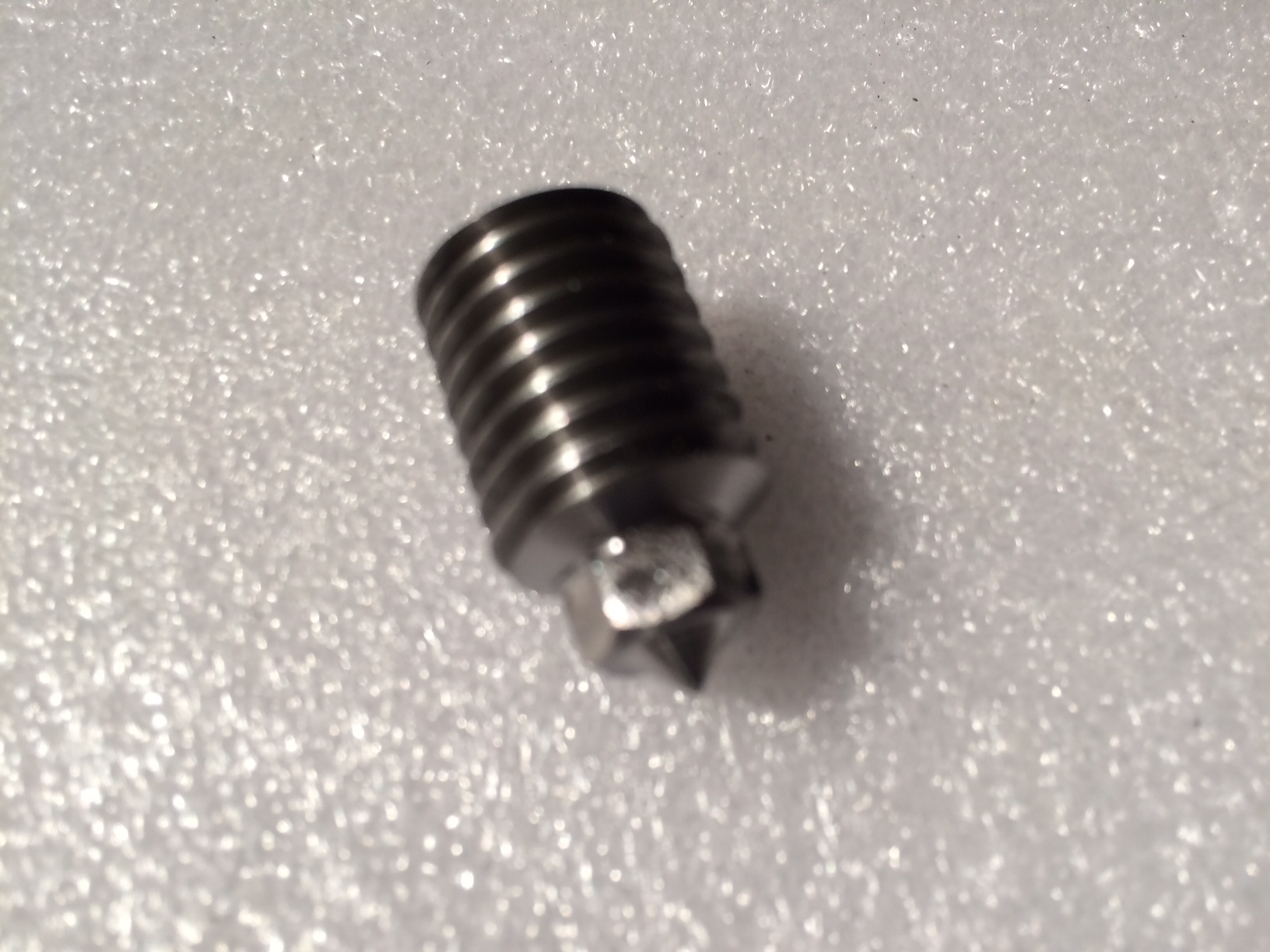

Not sure how many folks have used transfer screws to measure or transfer a hole pattern but here's a little project:

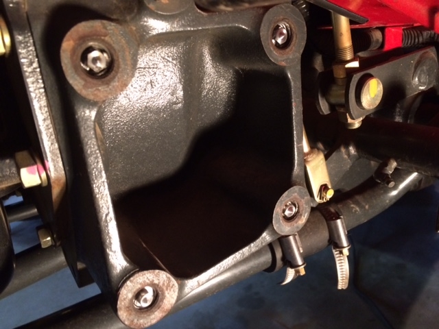

I'm looking at adding a front end loader to my Mahindra 3015 (30HP) and probably going to have to design and make mounting brackets to fit.

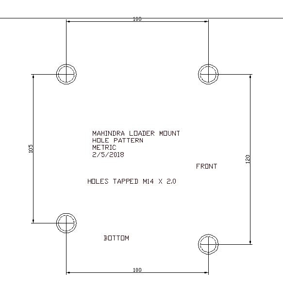

The 4-hole pattern shown in the pic is on the side of the tractor chassis and is one place that the mounting brackets will attach to.

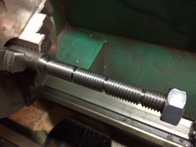

The purpose of making the transfer screws, which are M14 x 2.0 thread, was to measure accurately the hole locations which is not a square pattern.
You may notice the point on the end of the screws which normally creates a center punch mark pattern when a piece of material is held against the screws and hit with a hammer or such.
I simply installed them and then measured the distance between holes. Will probably drill the mating plates on my vertical mill using digital readout.
The long hex piece shown in the link below is actually a wrench for storing the screws inside and installing the screws using the female hex on the end.
I didn't find any transfer screws online to fit a M14 threaded hole so made these on the lathe by single pointing the thread and then milling the hex.

Yep. I have used those several times, and they are very handy. Another way to get the same results in your case, is to screw bolts in the holes and caliper over the outside of them, and subtract one bolt diameter to get the center distance. I have used that method more than the transfer point method in cases like that.

Based on your final measurements, I would have put a metric tape up there and read 100mm and 105mm!
You just need to figure out if it was designed metric or sae.
I probably would have done that also if the bolt pattern was square. Seeing the one bolt "out of position" made me a big leary. The pattern sure looks simple enough now, however.
