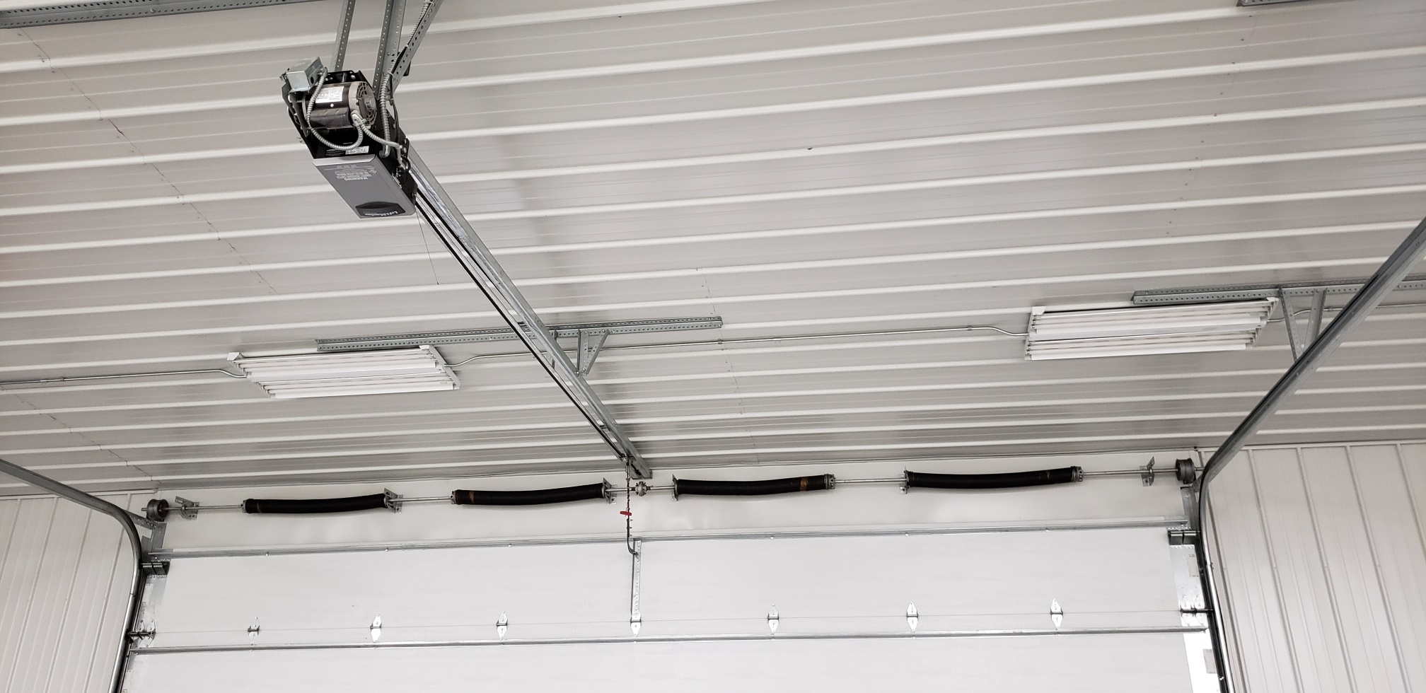

Looking at the picture of the actual garage door opener and the up down buttons next to the door,
I wouldn't be surprised if that was a line voltage box.
Does that require that you hold the open and close buttons till the door is were you want it?
If so I would definitely check to see what voltage is at the operator,
if you don't feel comfortable pulling the cover after killing the power and re energizing it with exposed wireing,
call an electrician and have him check it out or check with your door man when he comes out to service it.

It is a low voltage switch. Just push a button, the up button for up, down for down and stop for stop. there is no need to hold any of them down....Unless the safety stuff is acting up and it won't go down. Then I push & hold the down button to override the safety stuff to force the door down.

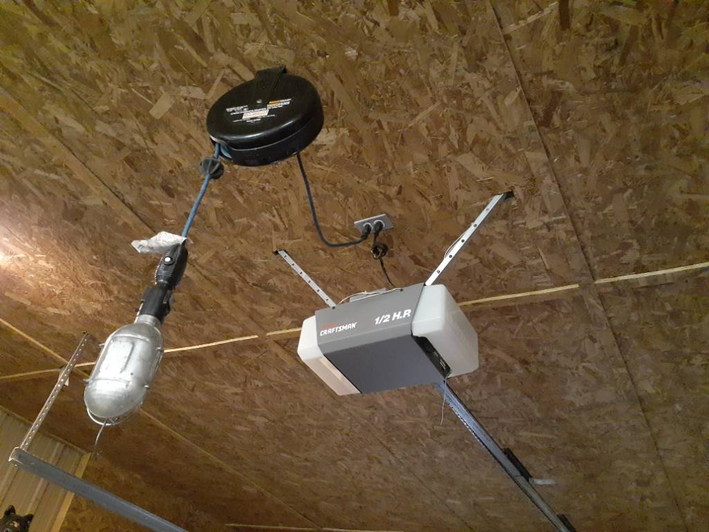

How difficult is it to install one?
My door opener in the tin shed is plugged into an outlet on the ceiling. It is 15 feet high and I can't get up there to plug in a drop cord from a generator when the power goes out.
I would like some sort of transfer switch mounted beside the breaker box so I can plug in a 2000 watt generator to open the door so I can get the tractor out.
Also, any recommendations on the type/brand of switch to get?
I put in a locked manual cable. Just unlock it, pull the lock plug through with cable attached to it which then will unlock the garage door from the opener. Guess you made the same mistake we did, e.g. not putting in a people door on the garage to the tractor.

no, there low voltage. Ive installed quite a few of those over the years.

well, i personally dont see how a control can be line powered, as all reversing functions are done at the motor. Every unit i have ever worked on, and my background was mostly as a commercial and industrial electrician in the union, were 3 button controls fed by 18 ga control wire. I guess someone out there might have a line voltage control, but for the life of me i cant see how you can reverse direction on the unit by this method.

I agree. It's unlikely there would be 120 volts on one of those industrial (A-B Type) three pushbutton (up/down/stop) controls. More like 24 VAC or DC???
I mentioned before. My Chamberlain Jackshaft opener, due to low drop on the track, and the inclusion of helper springs, cannot be opened manually. Of course, that never occured to me. Until the power failed, my main generator battery was dead, and I dragged out a portable (Diesel) Yanmar generator. That was a year or so ago, and the garage still stinks!
All that is require to reverse a single phase motor is to reverse the polarity of the start coil.
It can be done with push buttons or a drum switch.
