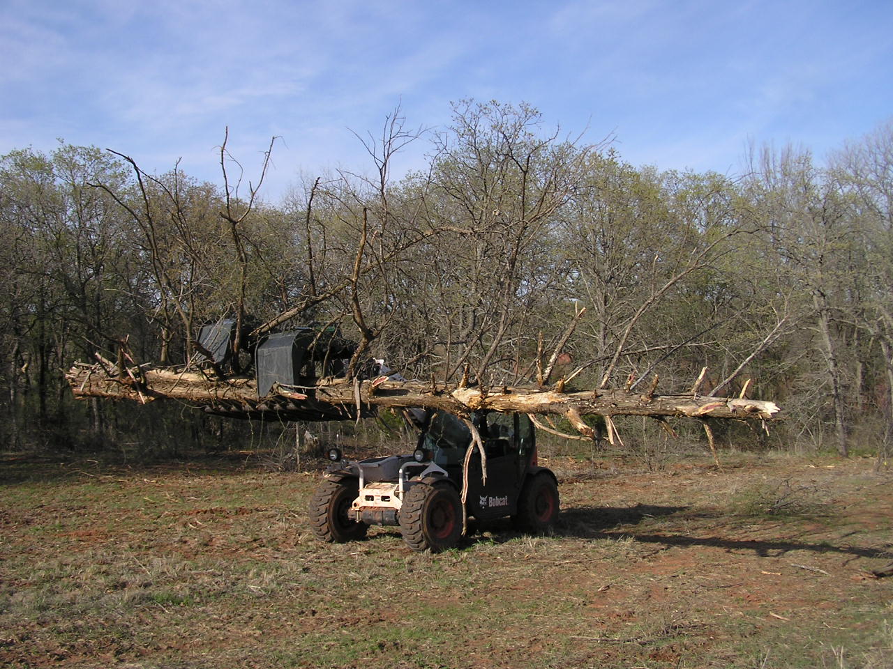

If we were closer together, I would bring the Versahandler over and pick it up!
These are only about 35 feet long, but the lift goes 17 feet high, so I could at least hold it while you went on the other side of the fence, and cut the top off.
