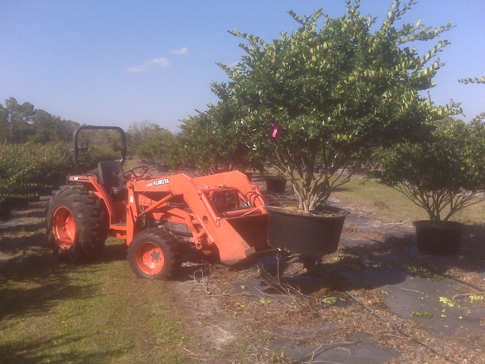

My partner and I run a small wholesale nursery, mostly 30gal and 65gal Ligustrum trees. We use a Kubota L3710 with a LA681 FEL. Since this is mostly a side business and we both have full-time jobs, we are trying to come up with a more efficient way of moving and loading the large trees. Our current method requires a lot of man-handling and takes to long. (See attached picture)
I would like to add a third function to the loader and come up with some type of grapple device to grab the trees.
I assume the everythingattachments.com kit would be the best route for us to add the third function, since I don't think we will need to do curl/dump at the same time as grabbing the tree.

The cheapest idea I have is to buy a pair of the quick attach (bolt-on) bucket forks (about $150 to $200) for the front bucket. These could set about 20 inches apart, that should give good support for the bottom of the 65gal bucket. The only thing is you would have to always set the 65gal buckets up on some wood blocks, that would let you drive the forks right under it, raise up the loader bucket, and then drive off. You could even weld on several chain hooks on the bucket and use some chains to secure the bucket in place while moving it.
Or, to take it one step further, you could start setting EVERY 65 gallon bucket on a standard shipping pallet, and strap the 65gal bucket down to the pallet with some nylon straps or banding material. Or maybe screw some wood blocks (onto the pallet) around the bottom of the 65gal bucket to help keep them from sliding off of the pallet should you curl the loader bucket too far in one direction.
If you use pallets, it would be a piece of cake to simply drive the forks under the pallet, raise it up a foot or two, and take off with it. Lot's of businesses will give away used pallets, or at least sell them fairly cheap.
Good luck!

That pot lifter seems like it's about 3x what it ought to cost. I'll 2nd Kebo's idea. With the forks it'll be easy.

I too agree with the forks.
If you still want the use of the bucket, then put the forks on the 3 ph (then a hyd. top arm would be a good addition and this would be a great excuse to add one).
But that tub in the bucket looks like "too much work" that some flat forks would handle with ease.
