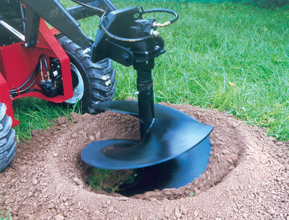

I agree that if you are planting seedlings then you don't need a large 12" dia hole. Building a small auger out of a 2" dia piece of pipe with a purchased or fabricated tip and some kind of ripper teeth a foot or so up the length would be the kind of tool you need to use with your PHD. I'm thinking something like a few pointy pieces of angle iron welded to the sides of a pipe might do the trick.

IMO, you don't need an auger-sized hole for small seedlings. You are going to have to do a lot of back-filling with a shovel.

Years 3&4 - We use a two step process now.
Step 1 - Use a subsoiler to rip a nice straight line cut in the soil.
Step 2 - Use a Dibble-Bar to walk down the cut planting seedlings
The auger was too big; left a smooth sided hole that root bounds the trees and was really more time consuming than you could imagine. The dibble bar is easy to use and you can plant a seedling in 10 seconds, and then firmly "back-dibble / stomp" the top soil back into place preventing any air pockets from forming around the roots (which will kill the tree real quick). The subsoiler cuts a nice straight line and also provides a good soil rip for the roots to spread and grow. I considered buying a 3pt hitch planter, but for our needs it was just too much money for a weekend worth of use.

For clear ground, I lay a starting cord so I have a straight edge. I c-clamp a 2x4 to my FEL so I can have a dangling chain guide to the side for my 6' spacing to run the cord line. I place my PHD on the tractor and drag the auger on the ground to mark my row. Do the same for the next row, etc until I see the row starting to curve. Then it's time to move the cord over and re-establish straight. If it's a square field, I might criss-cross to establish my grid.
If the field has stumps from old growth, then I'll just be planting in the center of my rows and now need to mark out a grid at all.
If I'm planting seedlings it will be with a Dripple-Bar, and if I haven't established a marked grid, I'll drag a 1x2 6ft long with me so my tree spacing is consistent.
If I'm planting transplants, I'll use the PHD with either a 6" or 12" (mostly 6") auger to pre-dig the holes. If not fully gridded, I'll drag a chain behind just to the side of the auger so when the end reaches the last hole, I'm at my 6ft spacing. I can't imagine trying to use a hand help power auger. That would be work!
