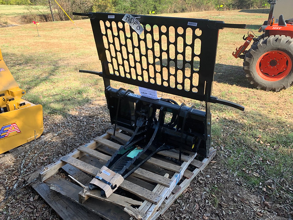

Looks impressive. My only concern with it would be how wide it is where you actually grab a tree. In many cases, I am trying to thread the needle between two close tree bases and I think it would be nearly impossible to do so without damaging the other tree in your current design, even with the jaws together. Doesn't look like you could hardly get between two trees that are 18" apart. It looks like it will pull a house out, but I use mine for some more detailed work which the tree bases may only be 8" apart or less. Granted they may only be 3" bases, but if someone wants to really strategically pick things out, you may consider an option with a thinner profile at the tip similar to the Notch. Just trying to be constructive with feedback since I have quite a bit of time using mine. Everyone's use will probably be a little different.
I also assume that is more for a Skid Steer only. Looks awful heavy to use on a tractor without taking up a vast majority of the lift capacity.

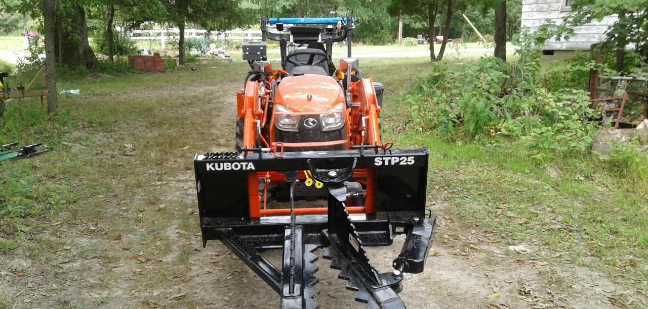

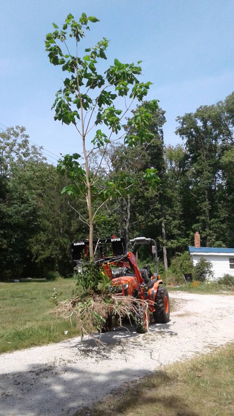

I'm going to go with a maybe, but I'm not sure I'd try it. .... at least not with the cutting and trying to hold the tree.
I've used a Danuser Intimidator on my L3560 (very similar to the EA attachment above) to remove smaller trees (<4 inches) and can from experience say they work much better to grab a tree/pole and push/pull while lifting to remove a tree than just holding it. Even small trees may shift in the grapple once free of the ground - or other support.
So personally, I'm not sure I'd want to be working under/near the loader when it's holding some of the larger/heavier size trees you've mentioned. With larger trees when using a chainsaw and a grapple (of any type) it's been a two-person operation: one cutting the tree like the tractor wasn't there, and the tractor just providing assistance to help push the tree where it's aimed. ..... which is still a relatively high risk proposition.
If it's not possible to drop the trees (roughly) parallel to the fence line it may be worth checking to seek if you can rent a boom lift and cut the larger trees down in sections. I say that as depending on the height of the 8" trees not only would the loader be having to lift/hold the weight of the tree, but resist any motion being imparted by the wind on what can effectively be a long-levered sail..... (while the M7060 is a larger tractor than a L3560, it's not that much larger despite having ~2x the HP).
...to be honest though just the thought of cutting down a 8" diameter upright live (or dead) tree while holding with my L3560 is almost a brown-shorts moment itself (at least if it's a tall/slow growing species) -- which is saying something since there's been more than a few times I've lifted long (>25-30ft long) & larger diameter trees from a horizontal --- and have been guilty of lifting the rear tires more times than I can -or care to- count (it's been often enough that I've almost gotten used to it happening as much as I push the limits, it's to the point I keep my right hand on the loader controls in order to be able to react faster should the backend start feeling a little "too light" when dealing with large/heavy loads). However, the smaller trees should be easily handled and could likely be pulled out like over-sized weeds with the grab, push (or pull) and lift technique....
anyway just my :2cents:

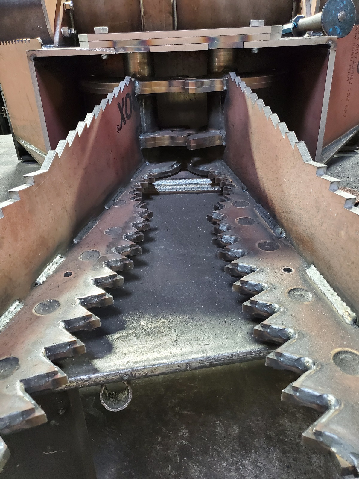

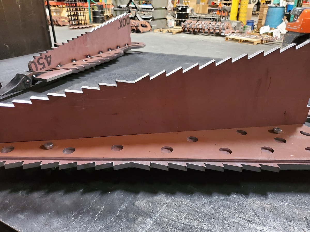

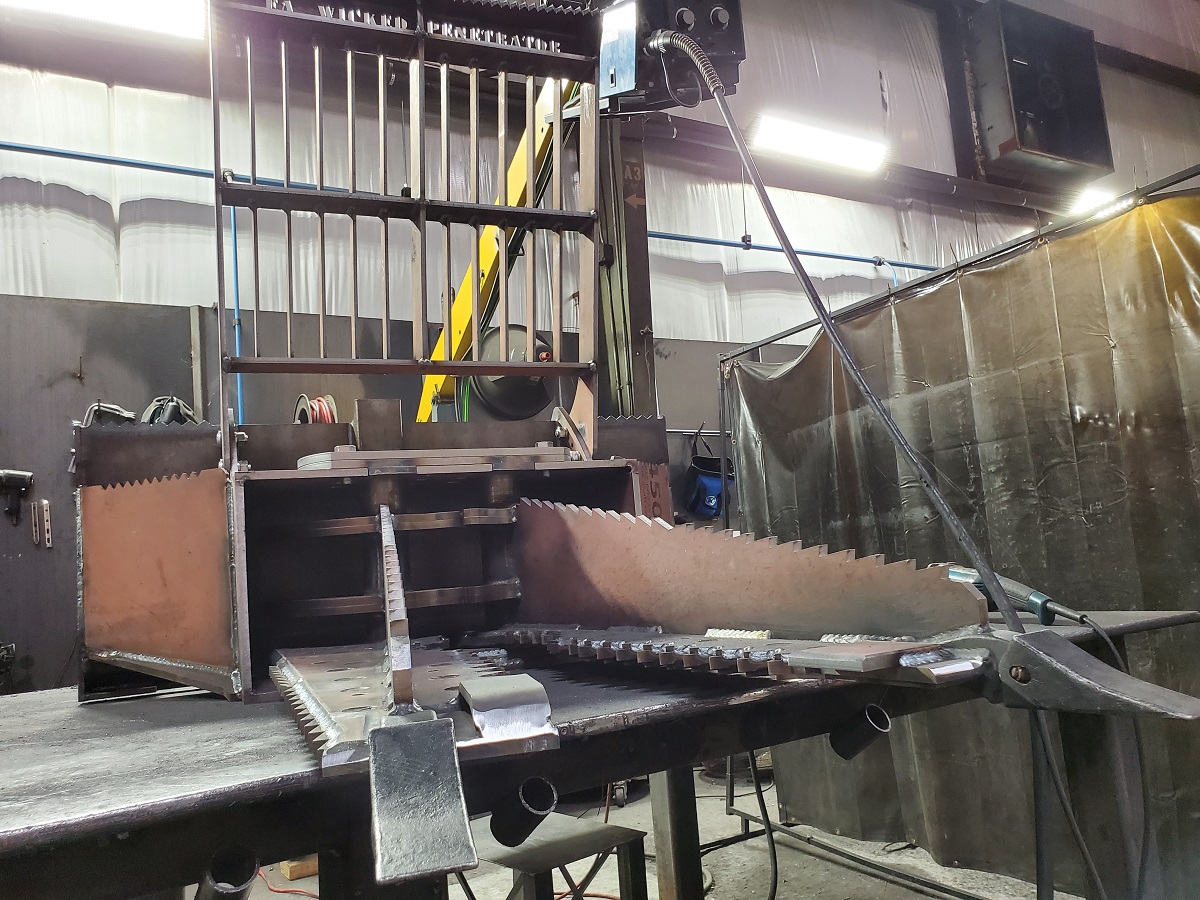

Depends on your budget I suppose, but I highly recommend the Notch Tree Puller.
Well, at least ya have good taste in box blades. :laughing: I kid, I kid.

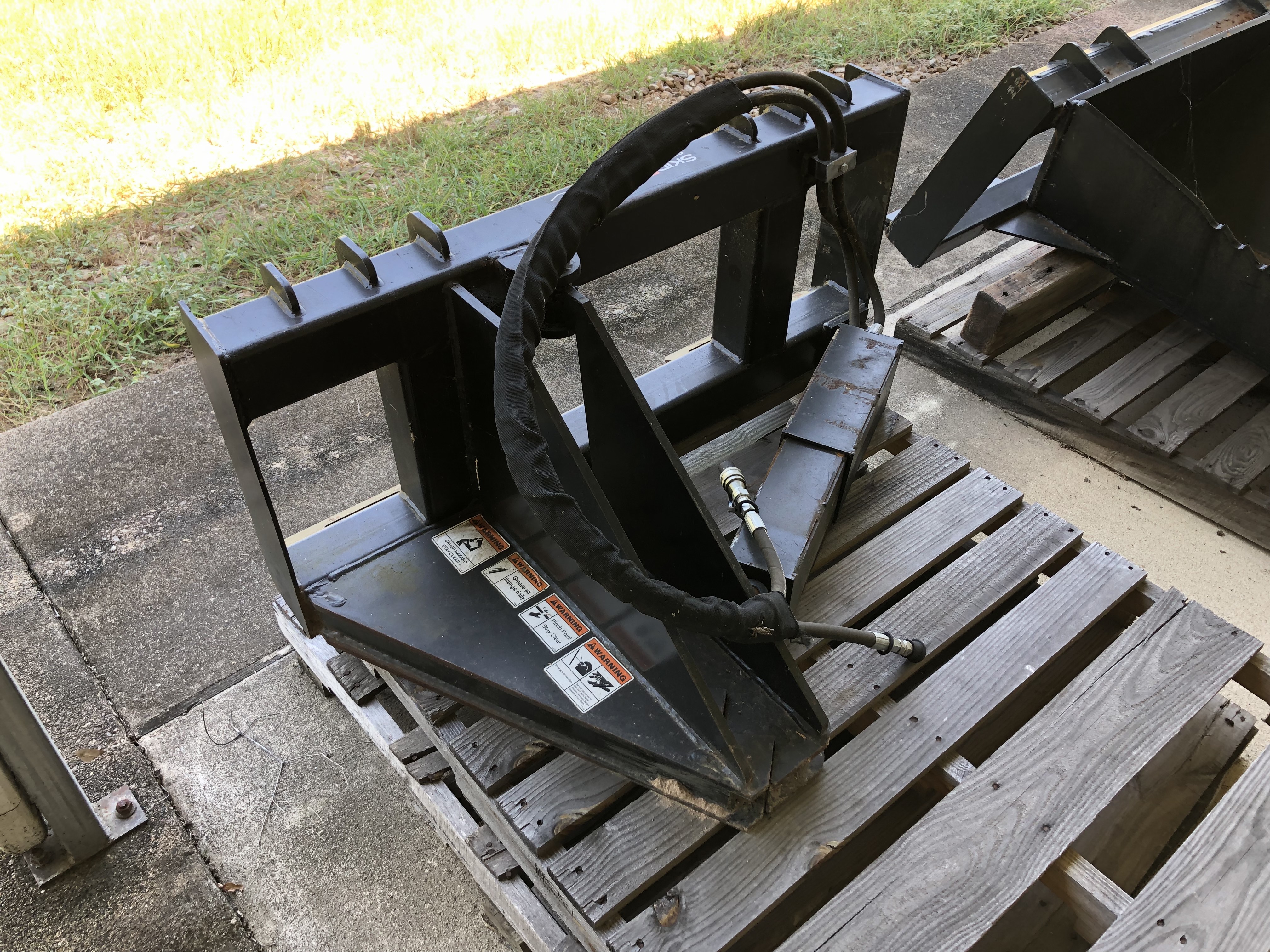

This first one is full blown big daddy puller, so, at 850+ pounds, it'll be to big for many tractors. My pic makes the jaws look wider than they really are, I think.
This tri layered AR450 Hardox Wear Plate is Nasty!
Plans for the near future will be for a 600ish pound model for larger compact and utility tractors and a 350ish pound model for compact tractors.
Gonna be good.

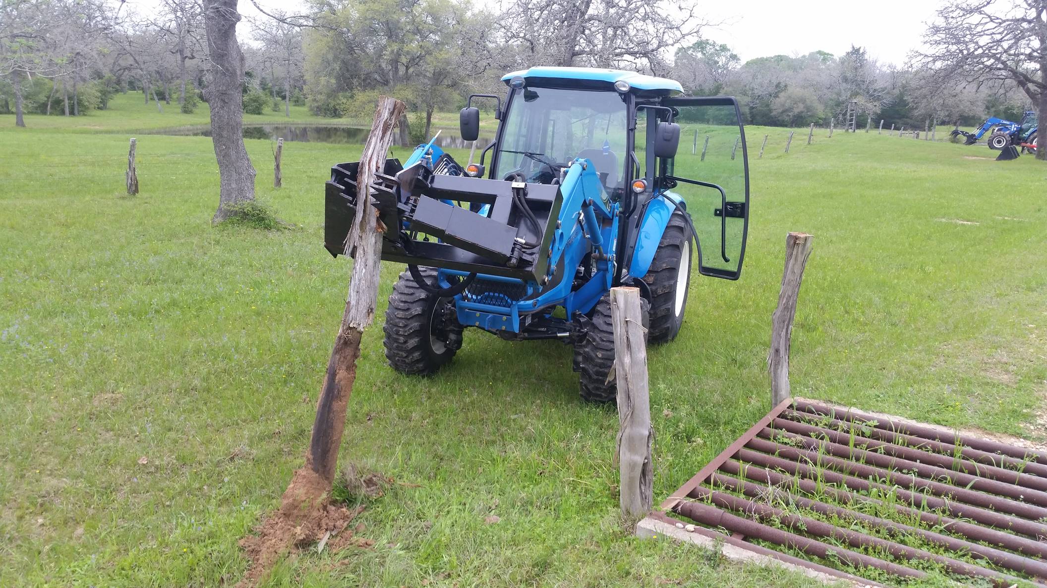

Wonder if you could put a little push on the tree as high as the loader will reach, then cut the tree with a chain saw, just above the fence, and make it fall to the inside.
/ Tree puller question #20
Sometimes that works, other times it doesn't (not my tractor)...
