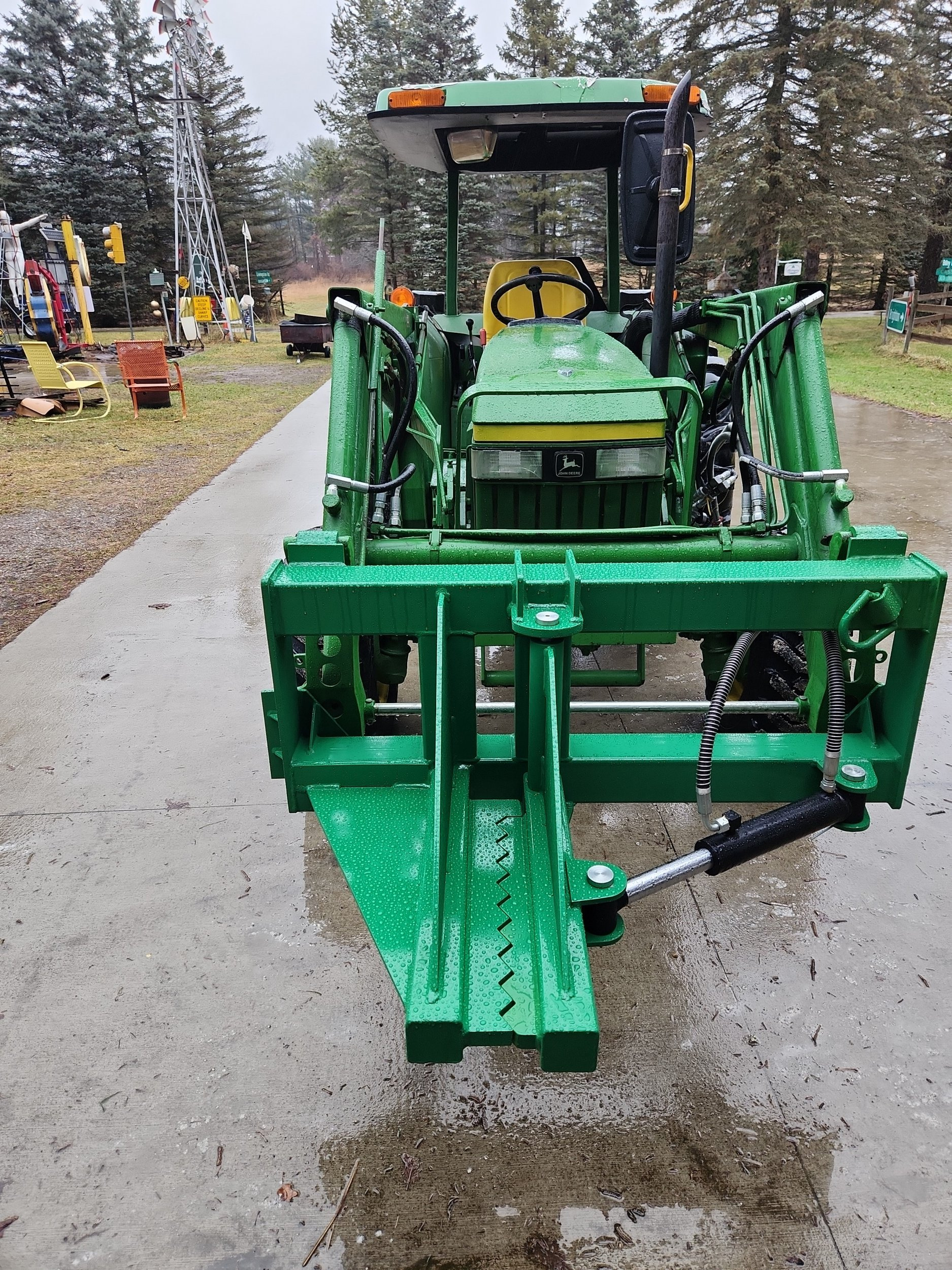

I agree 100% based on your assessment and also that of others. Here is the outcome: I have an 80 loader and easily converted it to the JD Hook & Pin Quick Attach system. Then I acquired a 7' snow pusher, forks, changed the bucket over, adapted a hydraulic motorized PH digger, and even rigged up a truck snow plow to the QA plate on the loader arms. BTW: I'm using a Summit 3rd Function diverter slung off
the tractor frame instead of the loader. This means I have selectable 3rd function options with the loader off for other applications

I agree 100% based on your assessment and also that of others. Here is the outcome: I have an 80 loader and easily converted it to the JD Hook & Pin Quick Attach system. Then I acquired a 7' snow pusher, forks, changed the bucket over, adapted a hydraulic motorized PH digger, and even rigged up a truck snow plow to the QA plate on the loader arms. BTW: I'm using a Summit 3rd Function diverter slung offView attachment 777042 the tractor frame instead of the loader. This means I have selectable 3rd function options with the loader off for other applications
Did you build your puller? Very nice!!!

No way ! Titan. On sale. Came in 4 days. Was advertised as "Free Shipping", but was charged $75 for Freight Service because of it's size & weight. Good thing I had forks because there is no way a semi-truck could make it down my road and turn around. Picked it up at the school nearby.

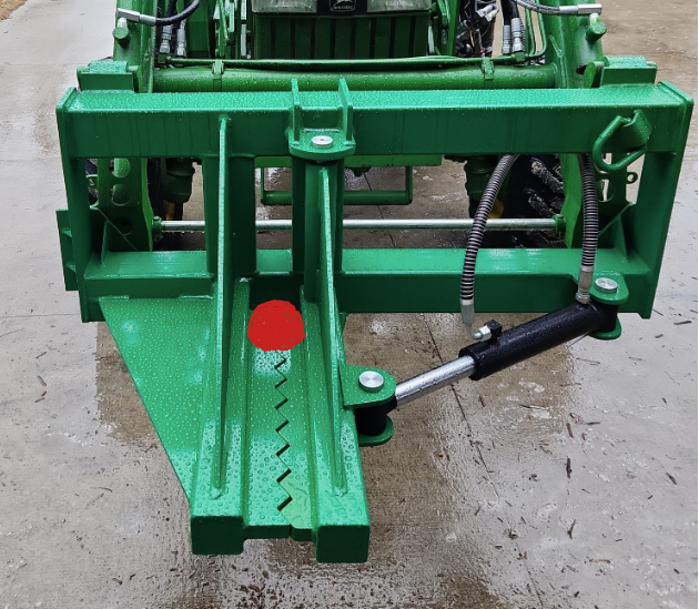

The idea is to sharpen 1/2 of one side of the jaws nearest the hinge to get a shear action there. I can still grip with the far jaw teeth. Yes or No ?
What are you wanting to shear?
It would not shear anything very big in diameter:
And then you need to remove the stump.

I built mine. It's not nearly as pretty but seems to function okay. I broke a hydraulic hose fitting at the cylinder once. You'll need to be cautious with yours the way they are plumbed. Thanks for the pic.
Mostly scrub honeysuckle, grape vines, deaf ash 1" in diameter. It's advertised as a tree puller, so roots and tree, no stumps hopefully. I'll probably reroute the return hose connection. BTW I do have a nice collection of Stihl saws if you are worried that this won't get the job done. A log chain and a running start... Maybe it can also serve as a tire bead breaker. Trespasser may want to take notice, too.
