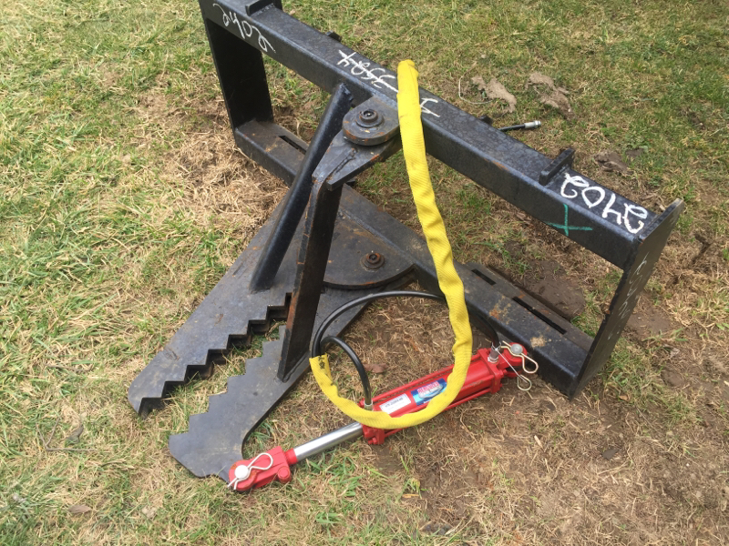

Anyone end up converting this two a three point?
I have a different version but I am think of adapting it to the three point since it have a stronger lift capacity. (Since I have a smaller tractor vs a beefy skid steer)
I just think with the lift and hydraulic top link it would be beneficial. Then with the grapple up front it would help clean up and stack.

I'm not sure what others have done but I purchased a Titan 3 Point to Universal Quick Tach Adapter Skid Steer Tractor Plate & it allows me to use all of my quick attach implements on my 3PT..... I use it for my tree / post puller & my pallet forks the most.

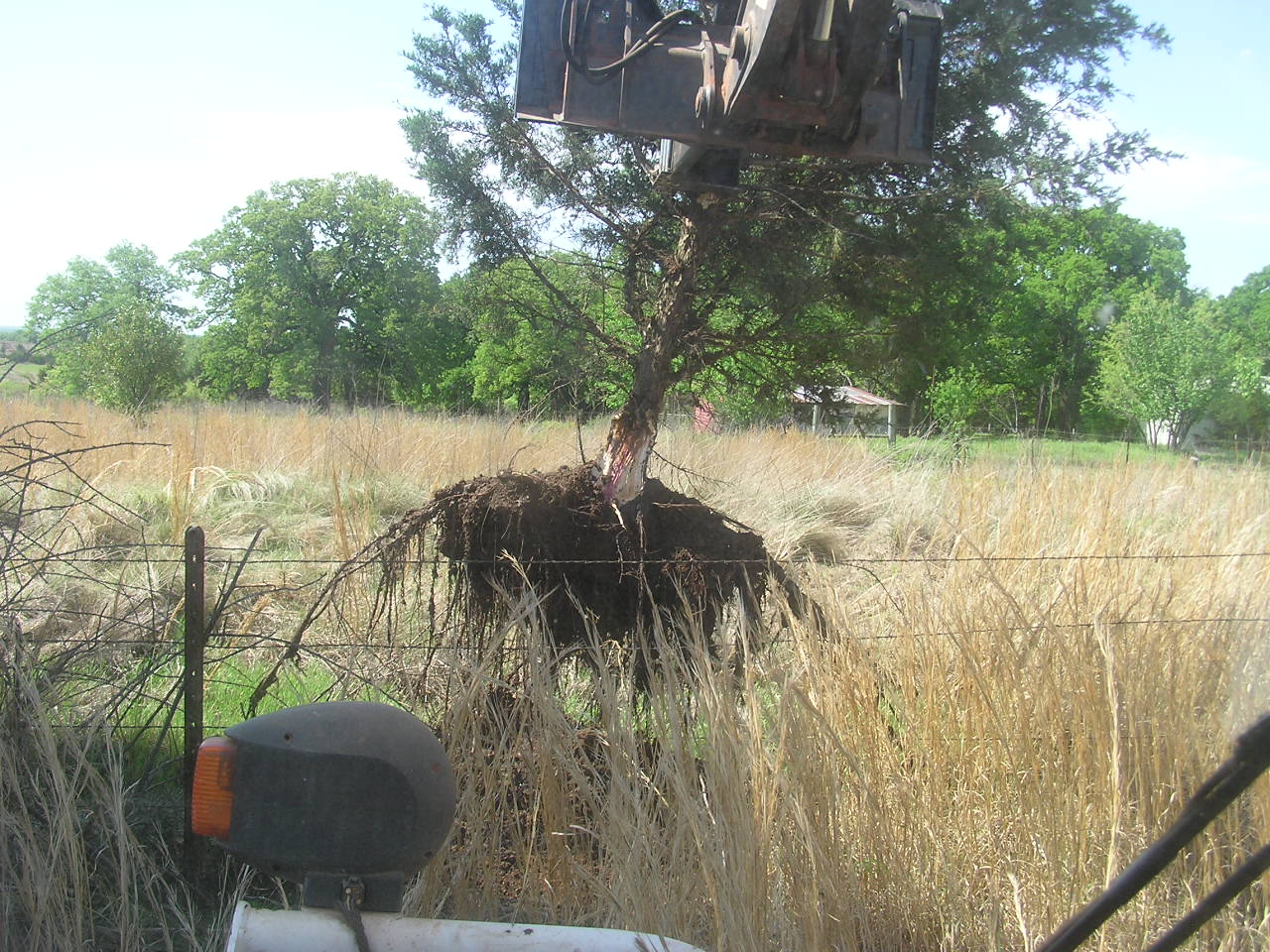

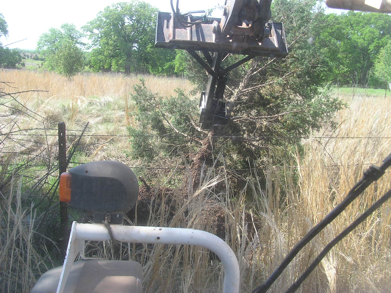

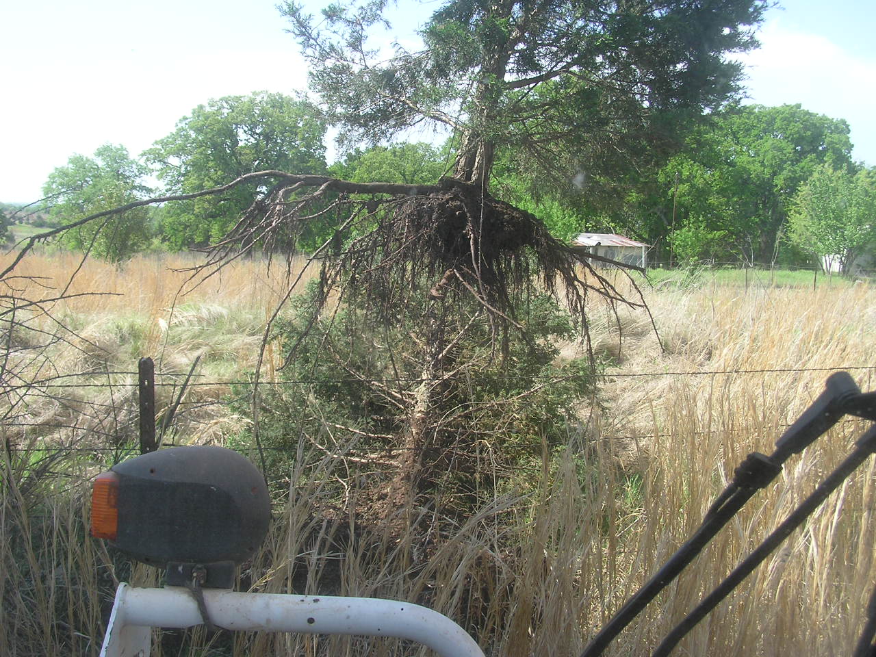

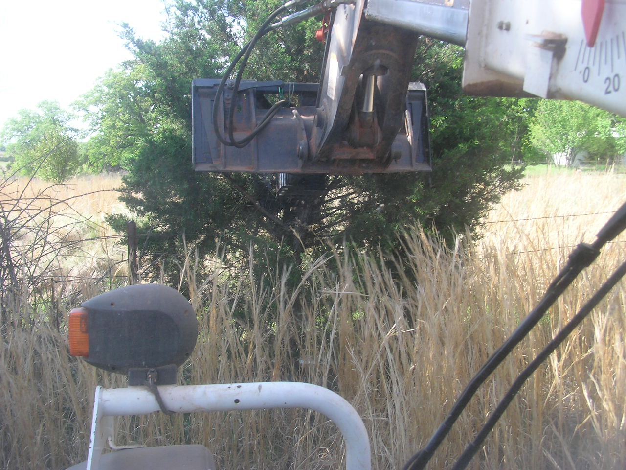

Pulling a multi-trunk cedar that is on the other side of the fence:
Reaching over the fence:
Clamped onto the closest trunk and raised the boom:

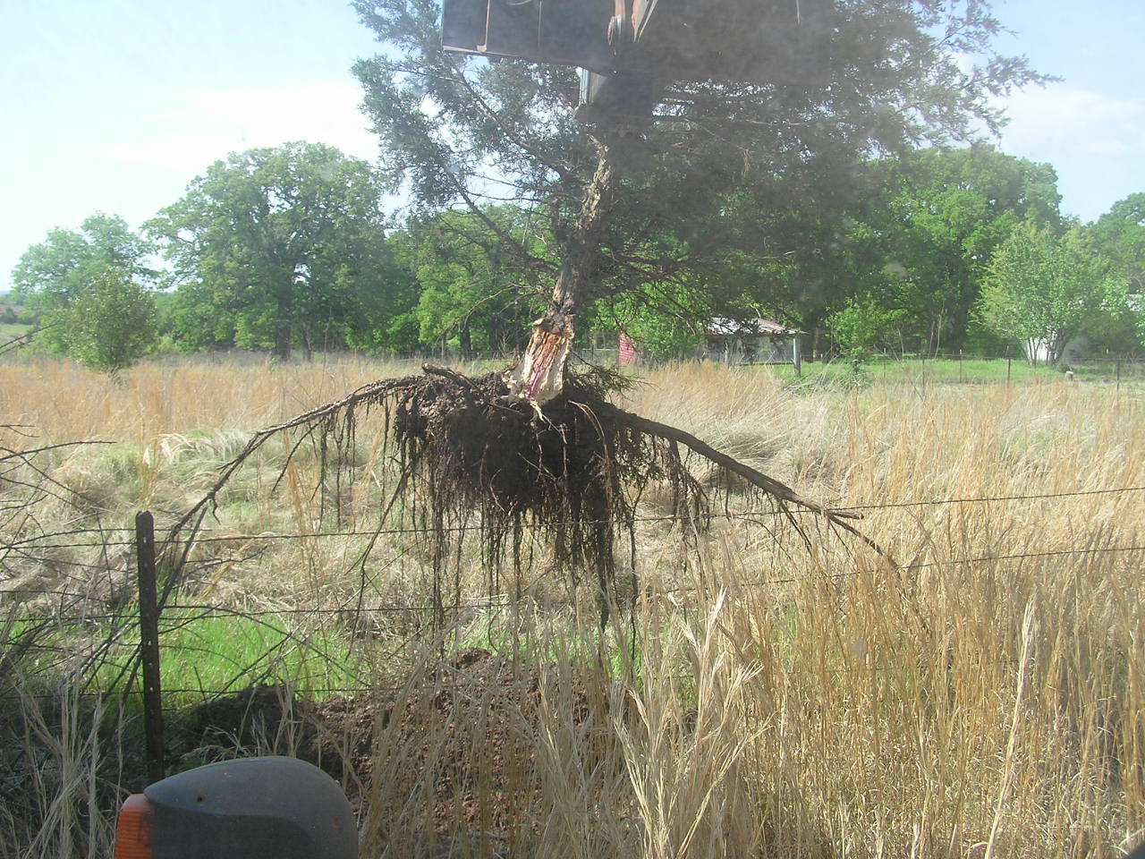

Raised it higher, looks like it got two trunks and one left in the ground:
Clamped onto it and pulled up:
Shook the dirt off of the roots:

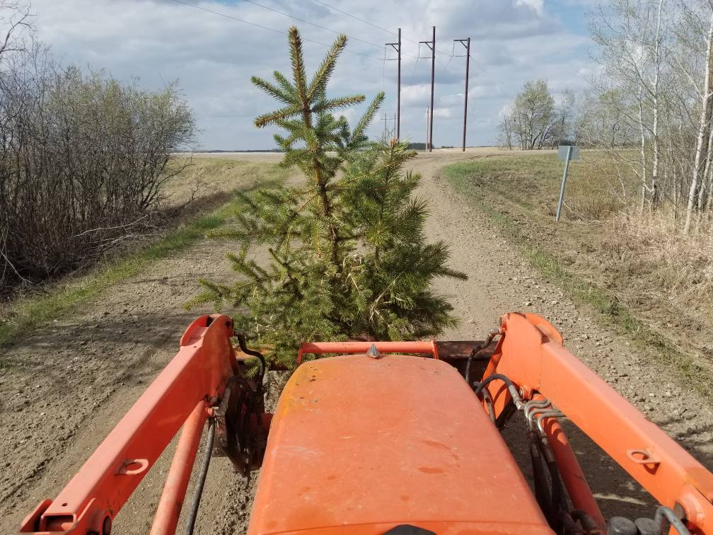

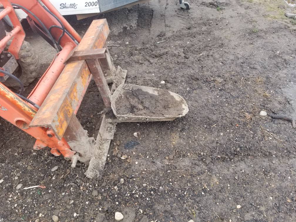

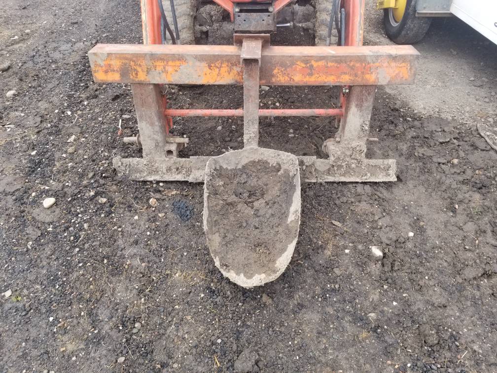

I built a small tree spade for moving small spruce and pine up to 12' tall. I found it works well also for digging out stumps and all sorts of other tasks that the bucket is useless for. I made it out of a lawn roller and an abandoned homemade forklift I attempted years ago. I find that you sometimes need the spade on the right or left so I made it adjustable. I can simply slide it one Way or the other. Of course the loader gets strained unless it's in the middle so I only use it in the offset position only for small trees. 20200513_164106.jpeg20200510_115908.jpeg20200510_115859.jpeg
