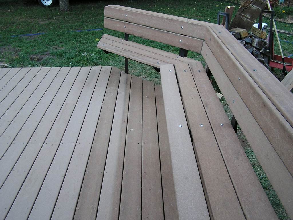

About 3 yrs ago, we built a 16x20ft deck, topped with trex. It is roughly 5/4 x 6 in boards. Works easily. Mine is 16" OC. The sagging/buldging I have is due to irregularities in the sub-structure. Yes, the trex flexs some, but I can live with it.
It is not slick when wet, but mine does seem to get a moldy like stuff on it as it's on the north side. I power wash it off and plan to use some bleach on it sometime.

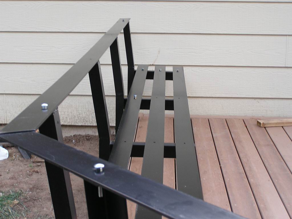

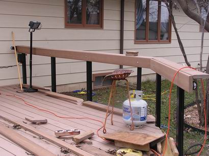

I wanted the trex for benches, but didn't want to have vertical support every 16"! So I built some metal supports that are on about 4 ft centers, and had them powdercoated. Had to run 1/4 x 4 steel strap (also powdercoated) under the trex boards to give it structure.
Pics are the end result. We really like it!
