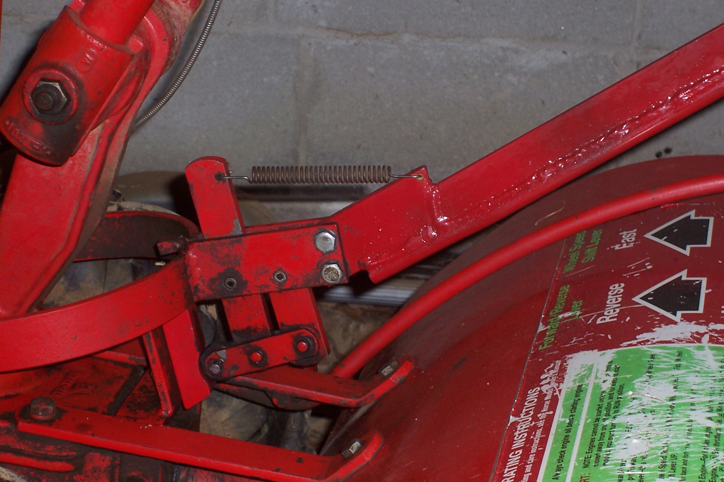

Be careful. Don't force. It's easy to bend or break the Forward-Reverse lever. All parts are available through MTD to rebuild the Forward-Reverse mechanism.

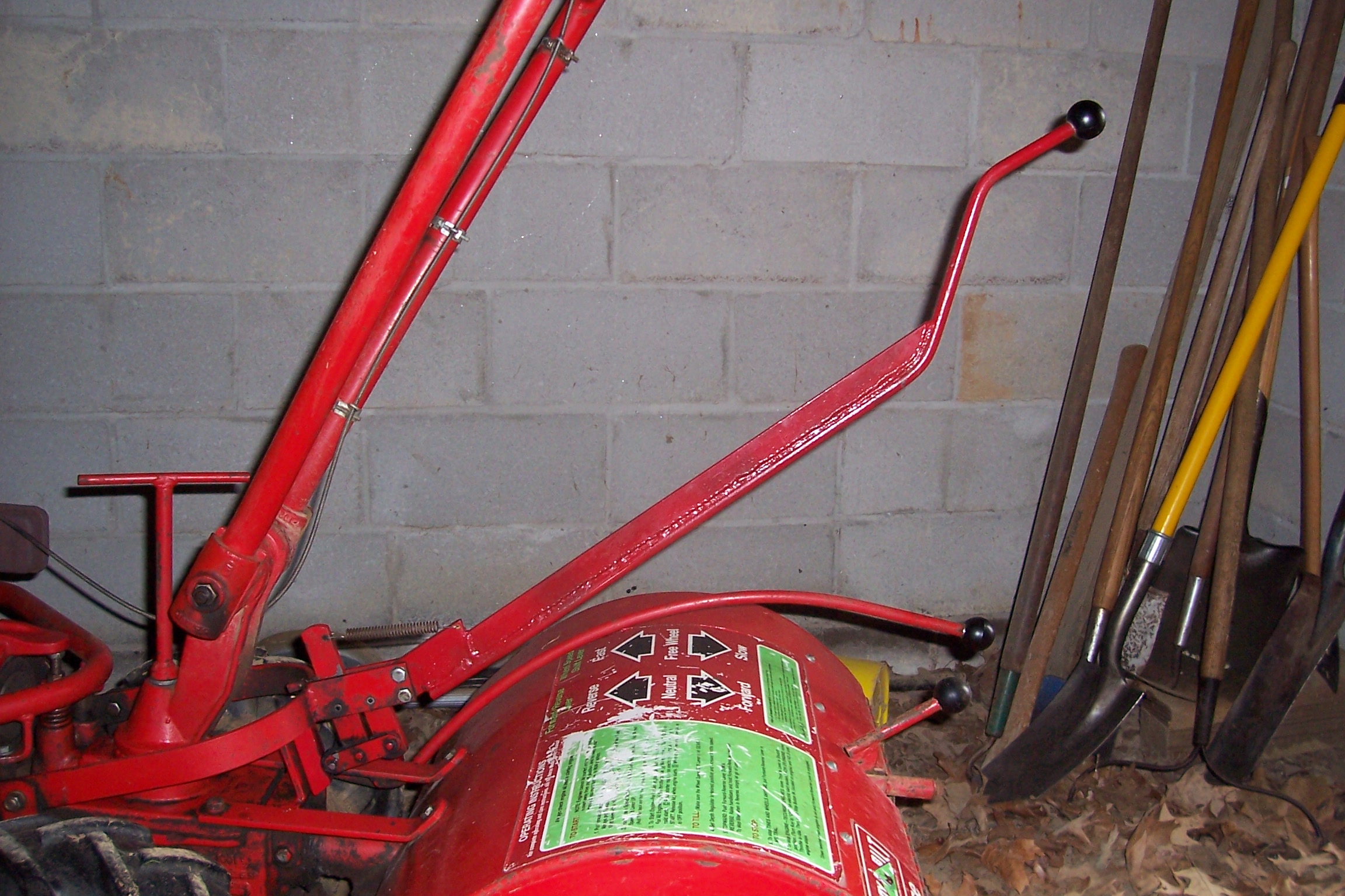

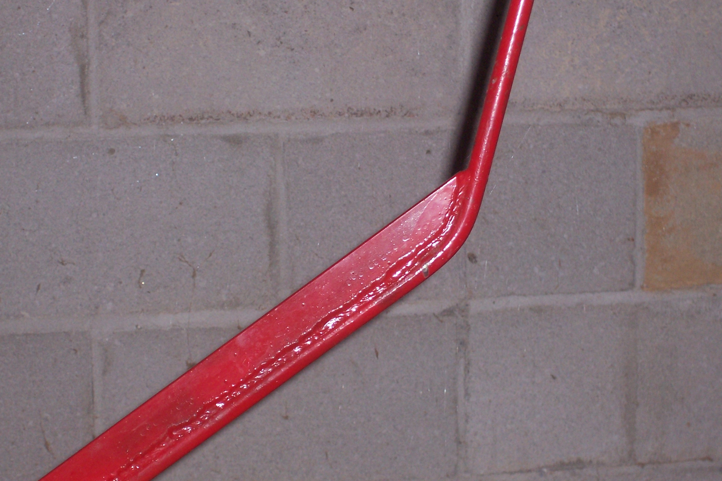

I have a 1976 Troy-Bilt Horse with a 6HP Tecumseh engine. I had the Forward-Reverse lever reinforced at a local welding shop. A strip of 1"X 1/4" steel was welded to the topside of the lever. Now it will not bend or break.
JakeBrake, any chance you could post a picture of the reinforced welded repair to the Forward-Reverse lever? thanks in advance.
   / Troy-Bilt tiller stuck Forward-Reverse lever #9
Hope this helps.
