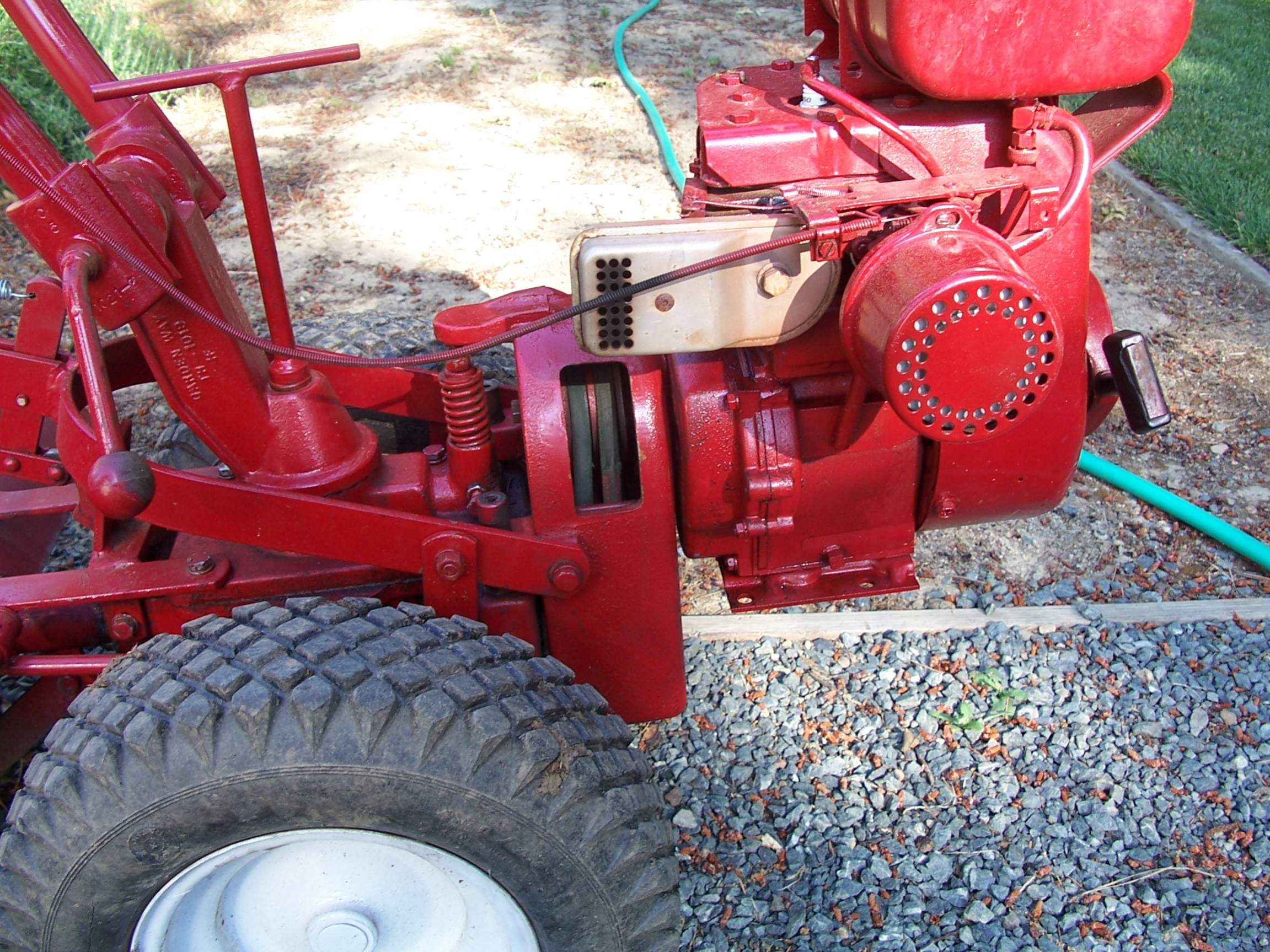

I have joined this forum because I have an ailing TB horse. I have had it to a shop for belts jumping off and other minor problems. Shop mechanic replaced bearings on the shaft and said the worm grear was good. It seemed to work okay for about two hours and the belts jumped off the pulley. After replacing the belts, the unit worked for about five minutes and I noticed the pulleys had apparently slipped forward about one inch. The mechanic does not want to work on the unit anymore because of the age and uncertainties. I have found the identifying numbers on the transmission case. TH1001 also, there is a plate with the number 5 and then another plate with a third number 189V and a forth number 1003H. Is there any hope for a "wanting to retire" shade tree mechanic to get this sick beast up and running properly? I have no idea as to where to start or how much trouble I am facing. Any help would be appreciated.

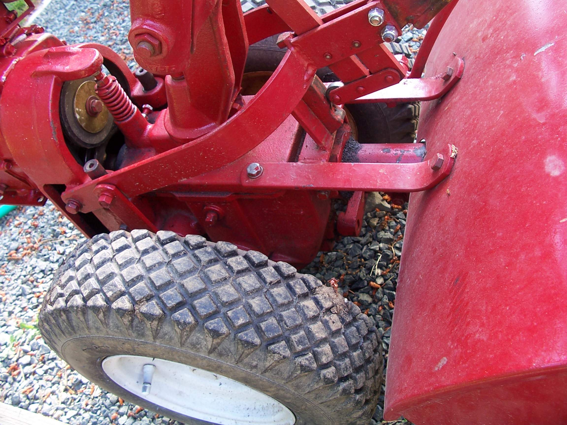

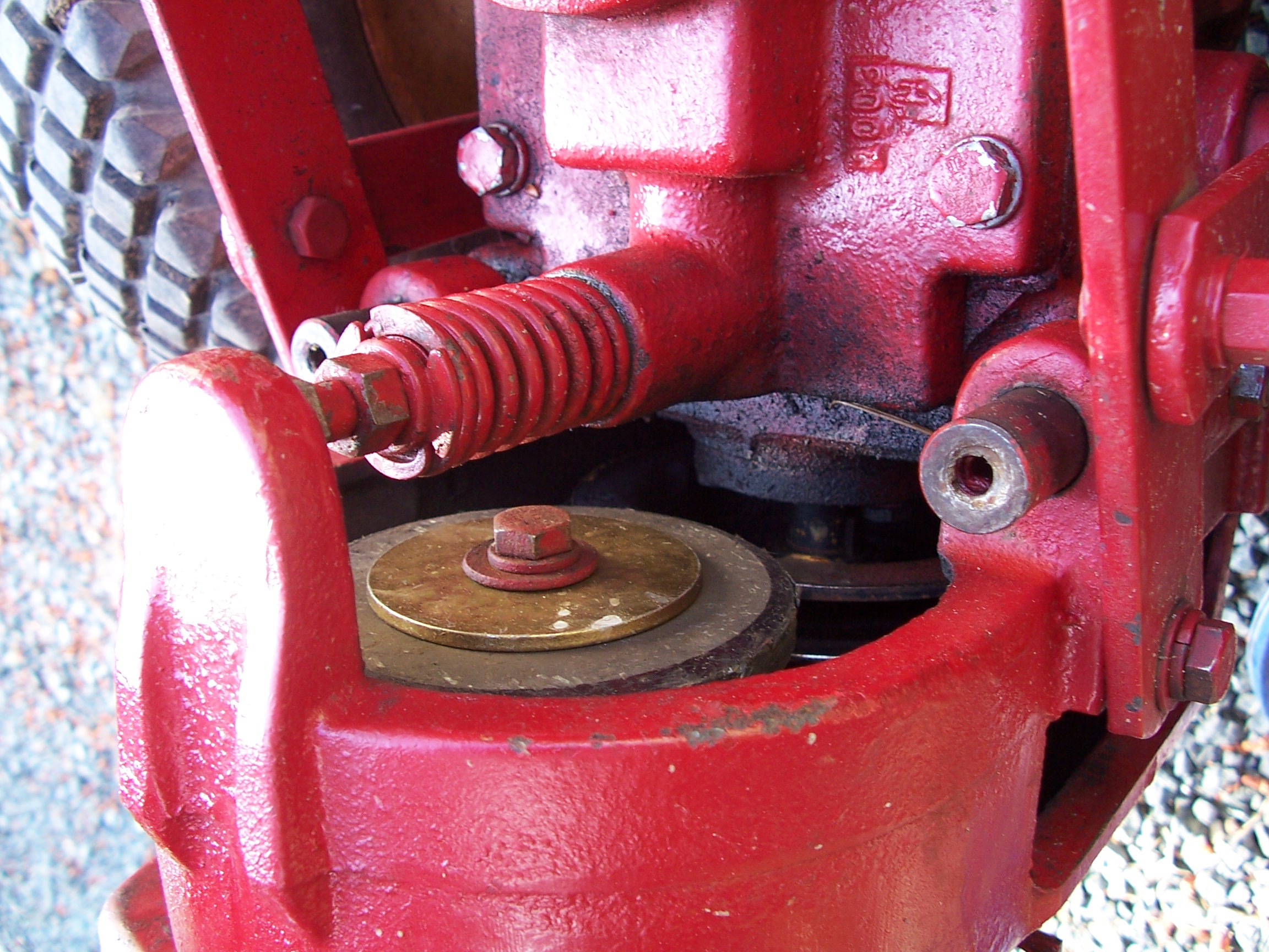

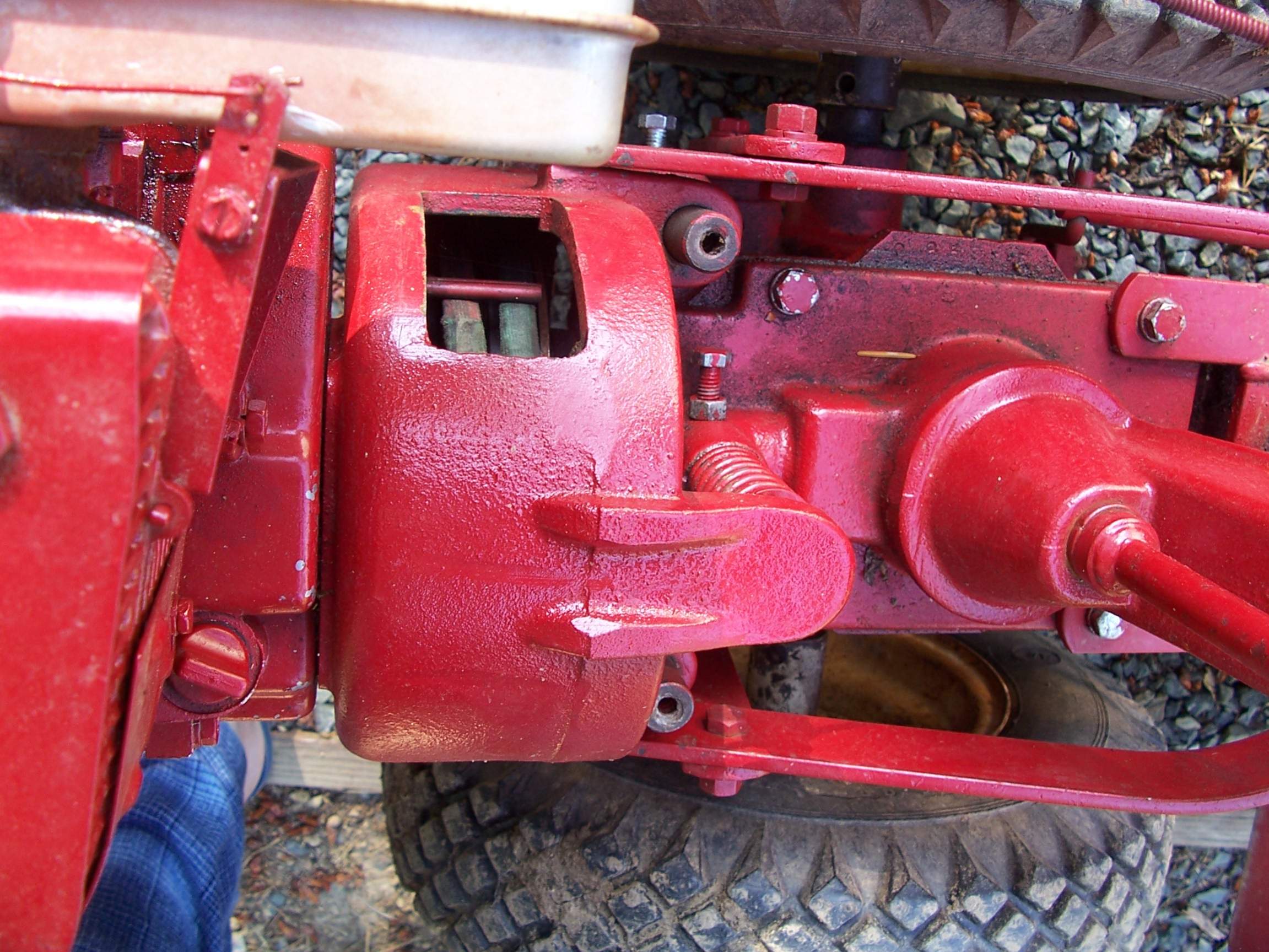

/ Troy Built Tiller Old
Hi Guys, Thanks for your posts. Had a bad case of the crud for the past few days and had no energy to respond.
I will get to the suggestions tomorrow and see if I can have any success. I have tried to attach photos and hopefully they will be there. If so you will see that some previous owner used a lot of red paint to try to spruce up the unit.
Hi Guys,
Things have gone better than I expected. I cleaned off a swath of dirt and located the S/N with a neighbors help. It is 118986.
Removed the engine and it was easy using a 2X6 bolted underneath and a floor jack to support the weight. The pulley to the shaft is part number 1008. This is a solid unit with all three pulleys cast as a single unit. The pulleys for the belts are both identical dimensions.
Discovered that the pulley should have been held on with a "C" clip. The shaft is 0.760 diameter. Does anone know the specific size clip I need? The clip of course was no where to be found.
Thanks in advance for any additional help.

/ Troy Built Tiller Old #10
The shaft should be .750" and the "C" clip is available at most auto parts stores as a nominal 3/4" clip. They are standard sizes, not specific to Troy-Bilt.
