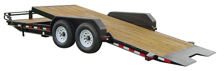

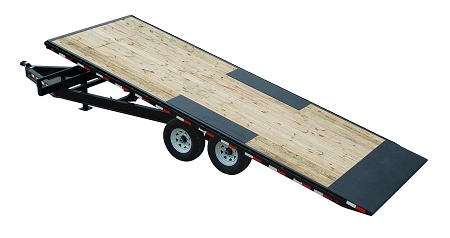

Here's a couple of PJ tilt trailers from the site JJ listed
This is a nice trailer.

J J-
It technically does have a dovetail. Just looks like a normal flat deck while driving on the road. But I don't want to start any arguments.
P.S.-
I've seen that 2nd pic on here before. I wonder if LB can see what's wrong with it...:rolleyes::D
Kyle
Just curious, what do you think is wrong with that trailer, and does anybody else see something wrong with it?

J J-
I can't believe someone with experience wouldn't see the S-10 towing probably 10,000#+. I know he was just moving it to the back lot, but still.
Kyle
   / TRUCK AND TRAILER TEAM. #87
It looks like a 1/2 T chevy to me and not an S10. But even zoomed in its hard to tell.
   / TRUCK AND TRAILER TEAM. #88
J J-
Kyle
I thought you all saw something serious about the trailer that I didn't see.
That is exactly what he was doing.
I know the potential for dragging the dovetail when going over a swell of any kind
