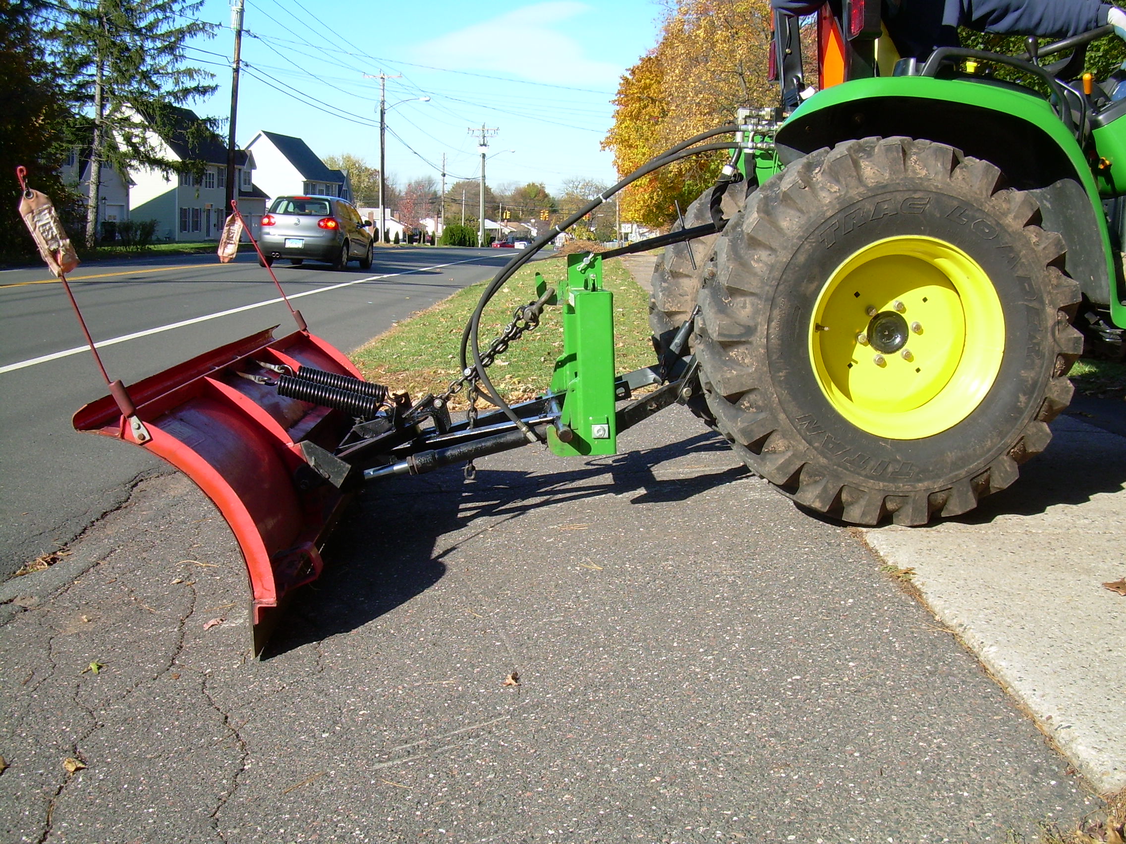

The 2x2 stock is not all that strong in this application, had to brace mine as you can see, for my loaders capacity it's fine.
Your loader looks like in can handle much more so you might want to use the 2x2 just at the receiver end and make your pole out of some kind of heavier pipe or beam.

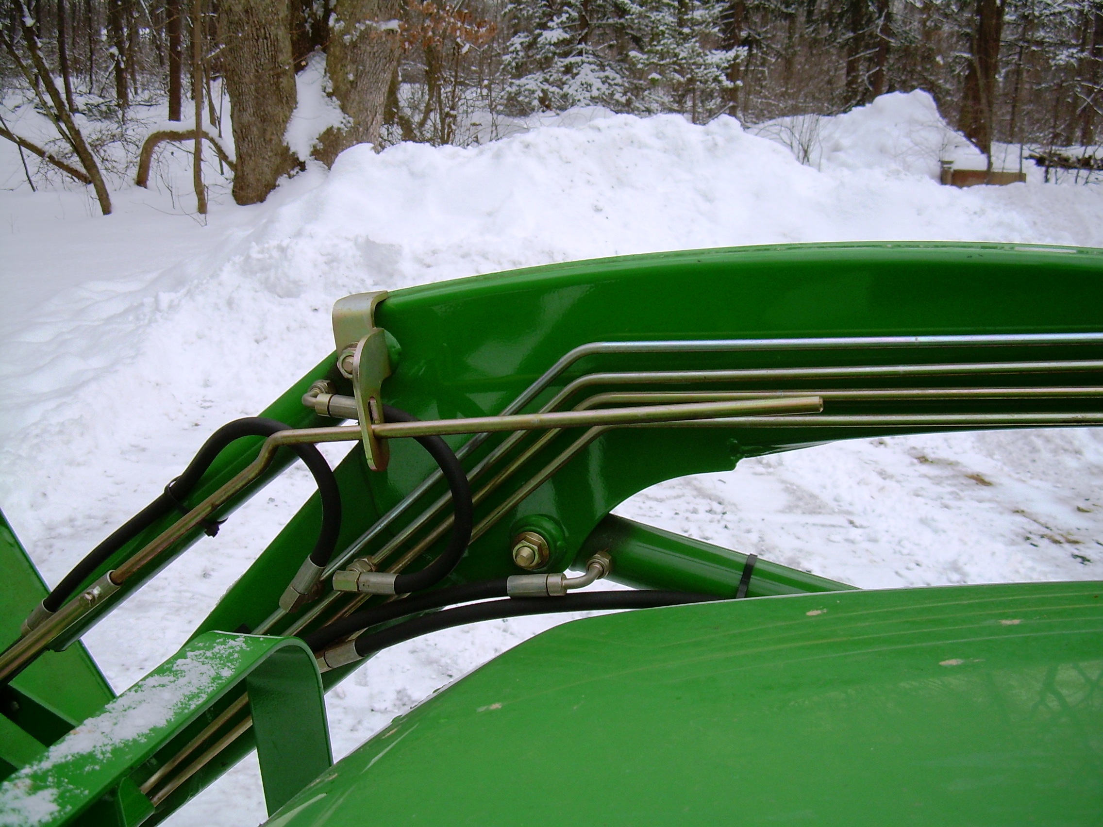

OK, without further ado, here's the pictures of the snowplow set-up:
First issue I have to deal with is that the hoses are too short and I have a leaking connection, as you can see in the last photo.
I'll make a trip to my local hydraulic shop tomorrow and get that straightened-out.

nice job.
looks like you got what you wanted nice and short.
congrats.
I have to save this with 4shorts and get my --- in gear and convert my sno-way plow.
Thanks for sharing.

Yup looks nice, you'll have to experiment with chain slack, plate angle, loader position/float etc.
You really don't have any snow yet? I just came in from plowing another 4 " today. piles are starting to build up.
