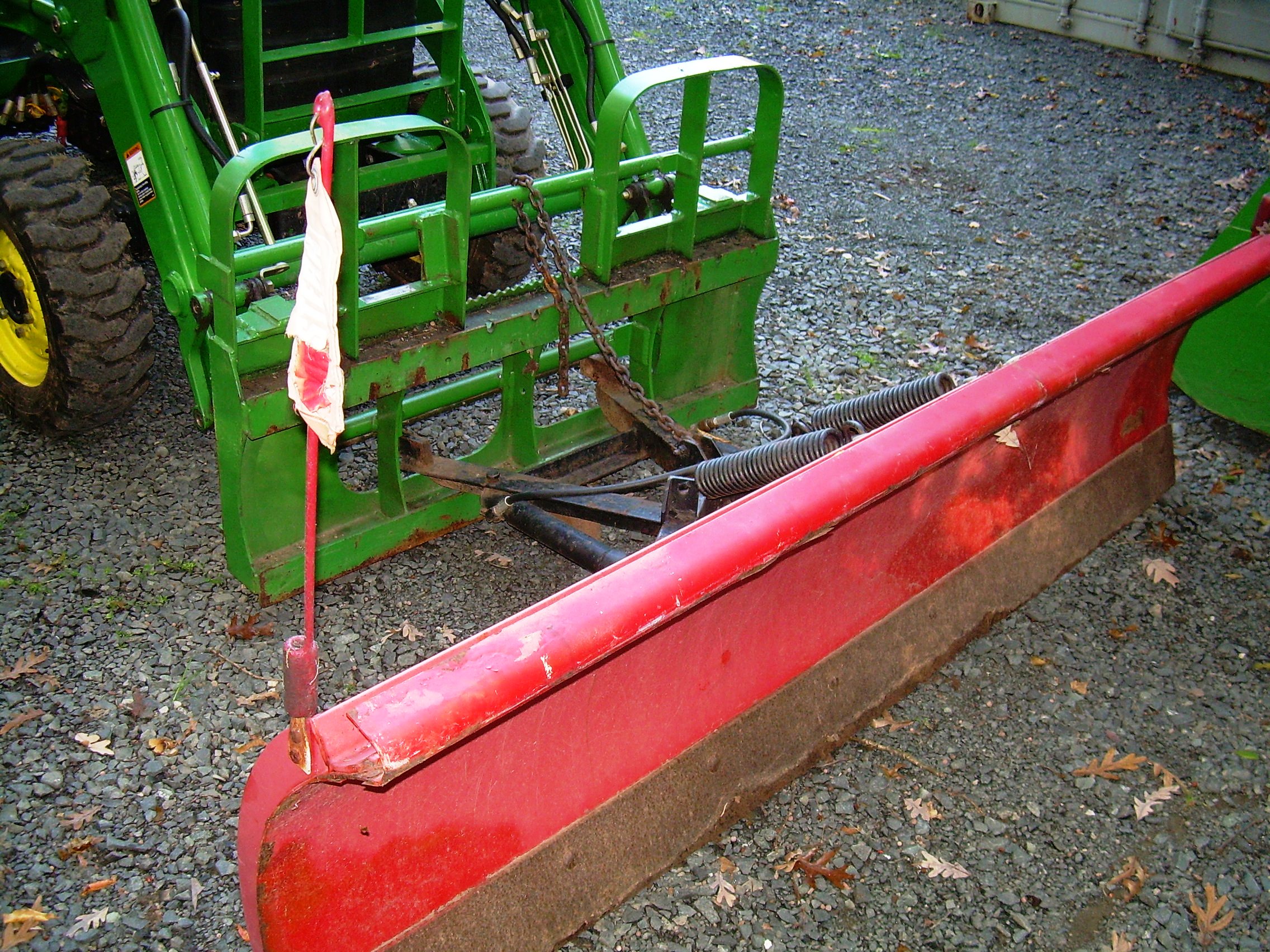

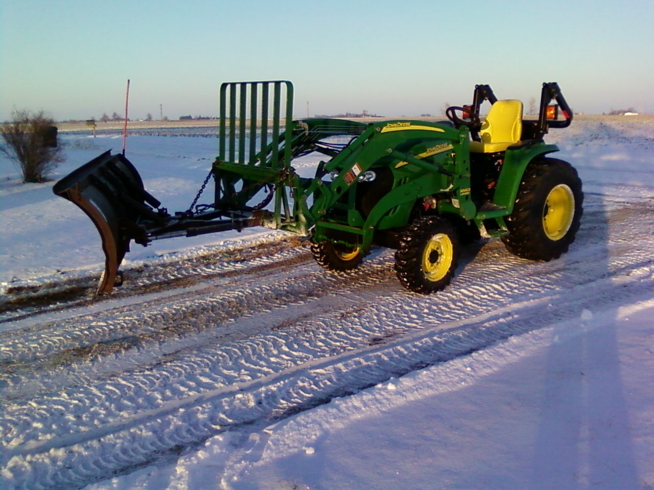

Seeing all the different plow mounts posted on this forum sparked my own idea. I took the forks off fork lift attachment and welded on plates to hold a worn out plow that a guy gave me. We finally got enough snow to try it out and it worked great after I took the skids off the bottom to the plow. I do like the idea of skids on the bottom of the push frame. I have to keep the frame pretty low to keep the blade from folding over. You also have to be easy when angling like others have talked about.

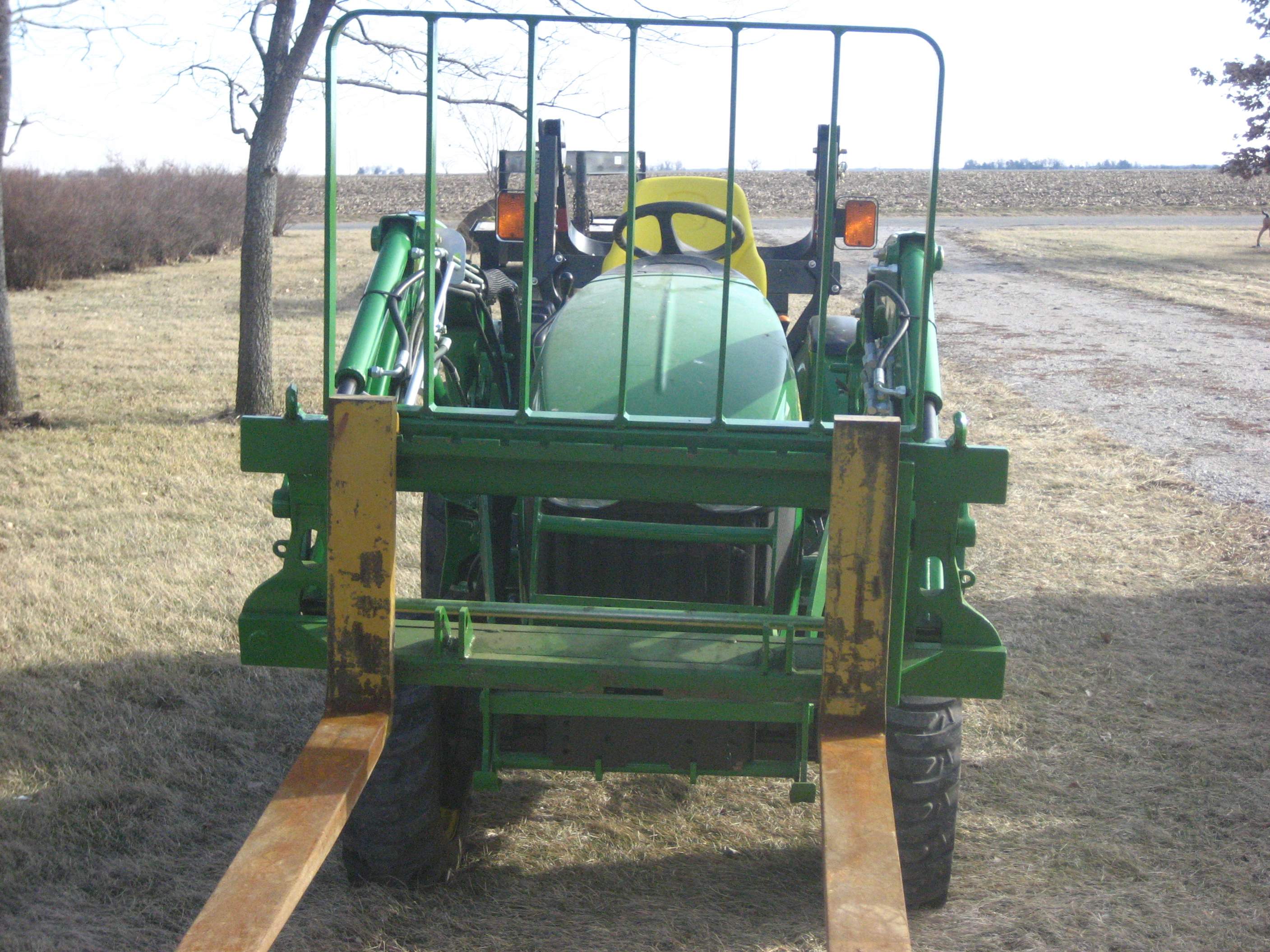

Dan,
Looks good can you still put your forks back on when needed?

Dan,
All I have to do is pull two pins to remove the plow and the forks will set right back on the mounts. I wish they were 4' wide instead of 3'
The plow is 7' wide but the price was right so if it never works out I'm not out anything but my labor. I could cut it down to 6' with out a lot of trouble.
Dan

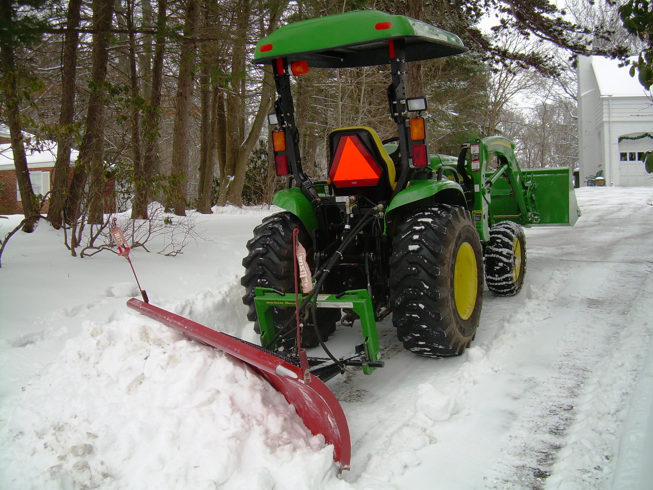

Hi Builder,
I had a 6' truck plow on my Kubota last year. The plow set up was 1/2 Fisher, 1/2 Myers. That's the way I bought it. I used the electric over hydraulic to power angle and the bucket for the up and down. A simple toggle switch in the dash to a solinoid was all I needed. I cut down the original quick disconnect frame to just a bottom rail and welded on ears to be bolted into the bucket. I could pull the plow and leave the ears only...and then unbolt the ears in the winter. I'm using a snowblower now but the plow worked great and didn't need nearly as much maint.
Here are some photos, good luck with your project!
