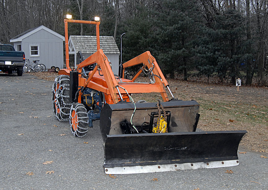

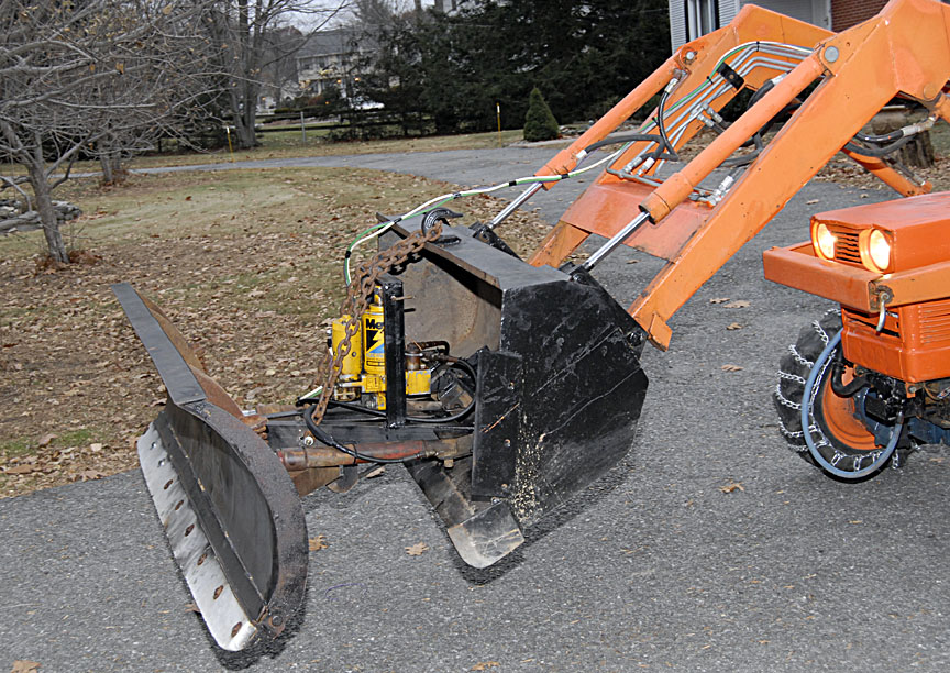

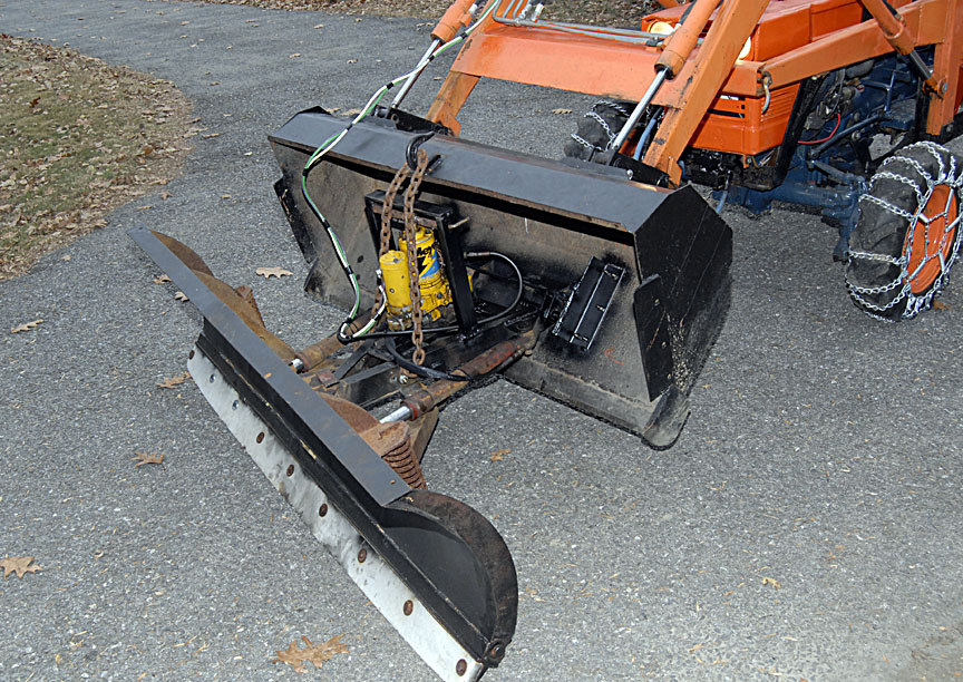

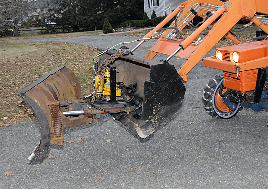

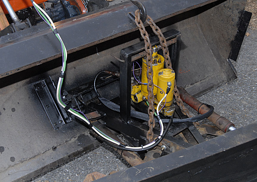

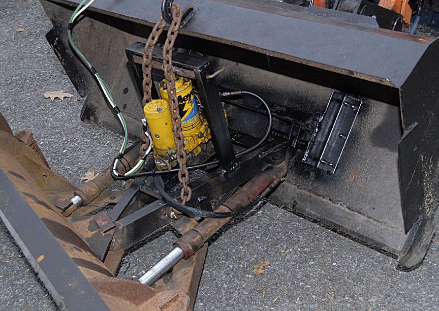

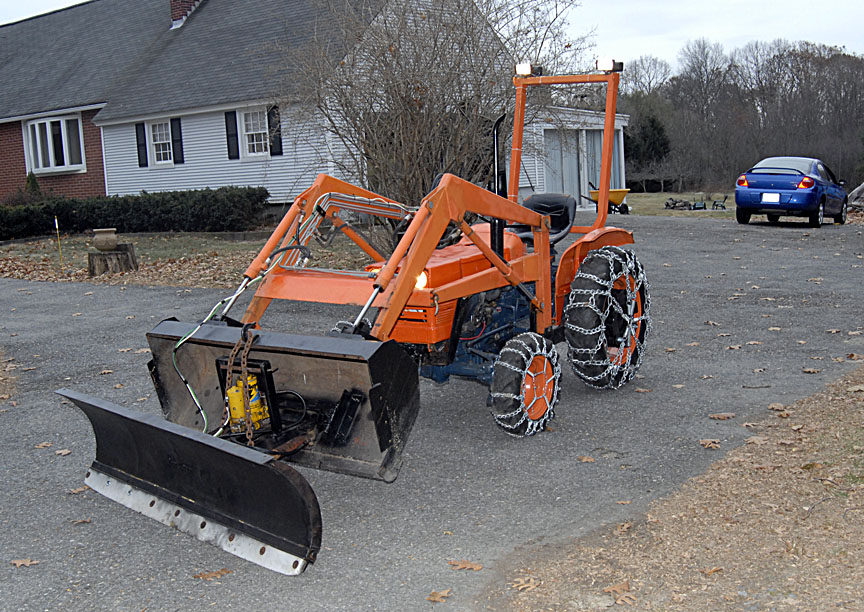

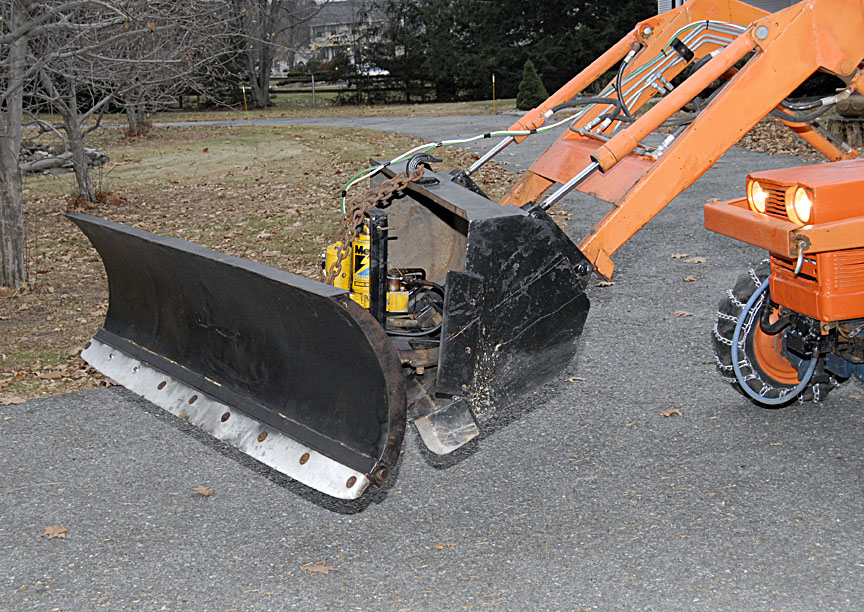

Hi Builder,
I had a 6' truck plow on my Kubota last year. The plow set up was 1/2 Fisher, 1/2 Myers. That's the way I bought it. I used the electric over hydraulic to power angle and the bucket for the up and down. A simple toggle switch in the dash to a solinoid was all I needed. I cut down the original quick disconnect frame to just a bottom rail and welded on ears to be bolted into the bucket. I could pull the plow and leave the ears only...and then unbolt the ears in the winter. I'm using a snowblower now but the plow worked great and didn't need nearly as much maint.
Here are some photos, good luck with your project!

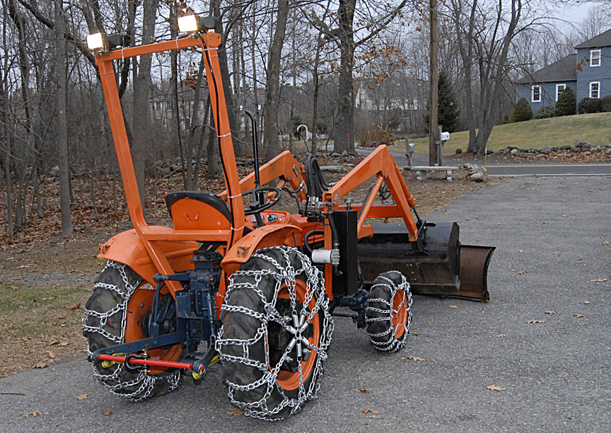

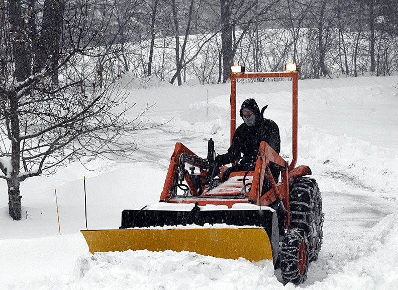

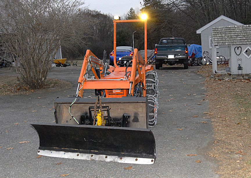

   / truck plow to tractor plow #54

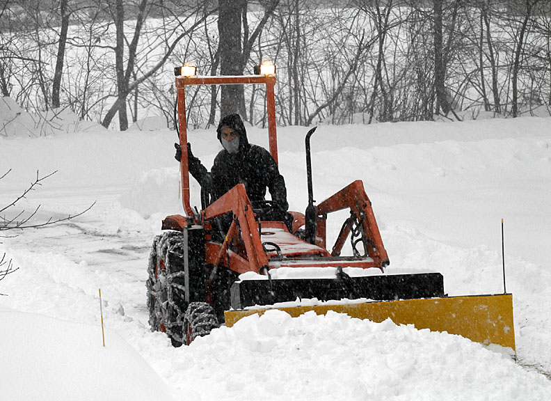

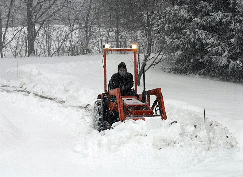

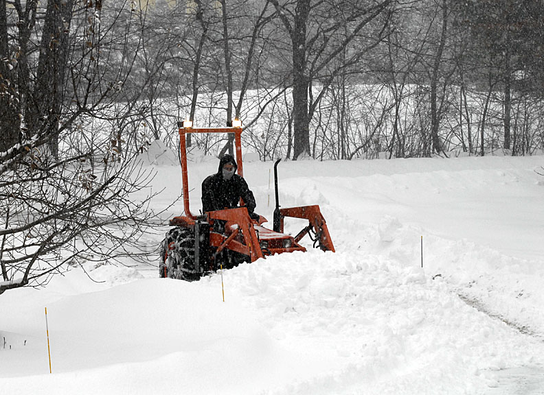

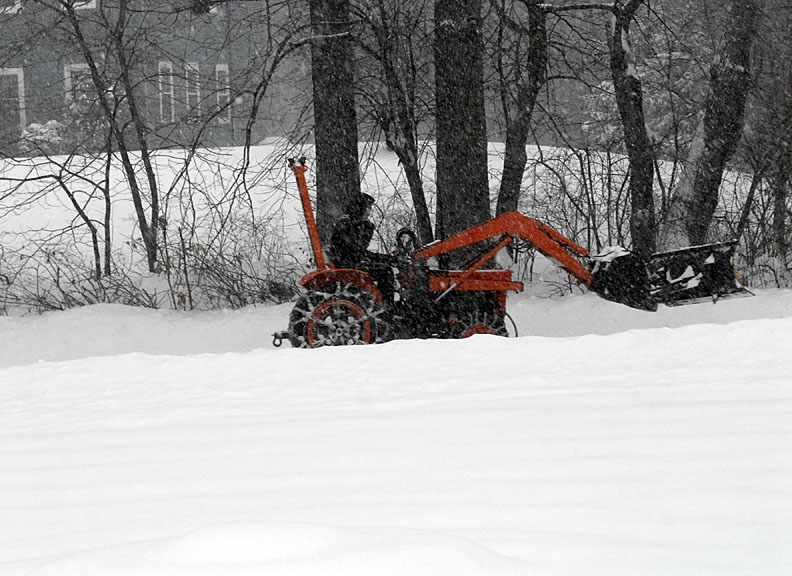

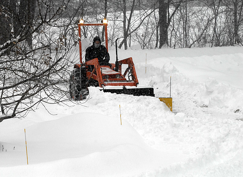

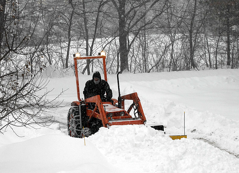

Here it is finished and in use.

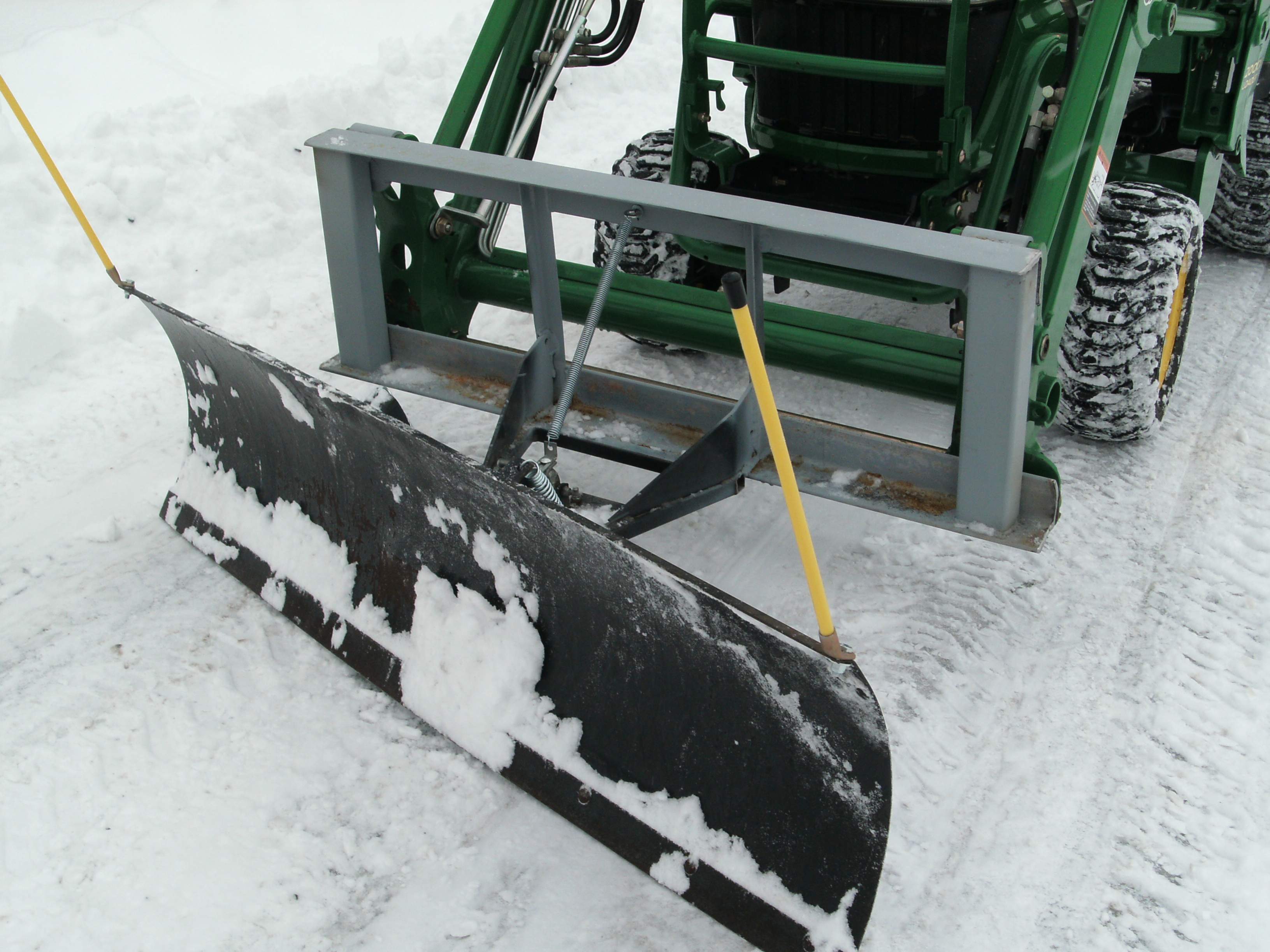

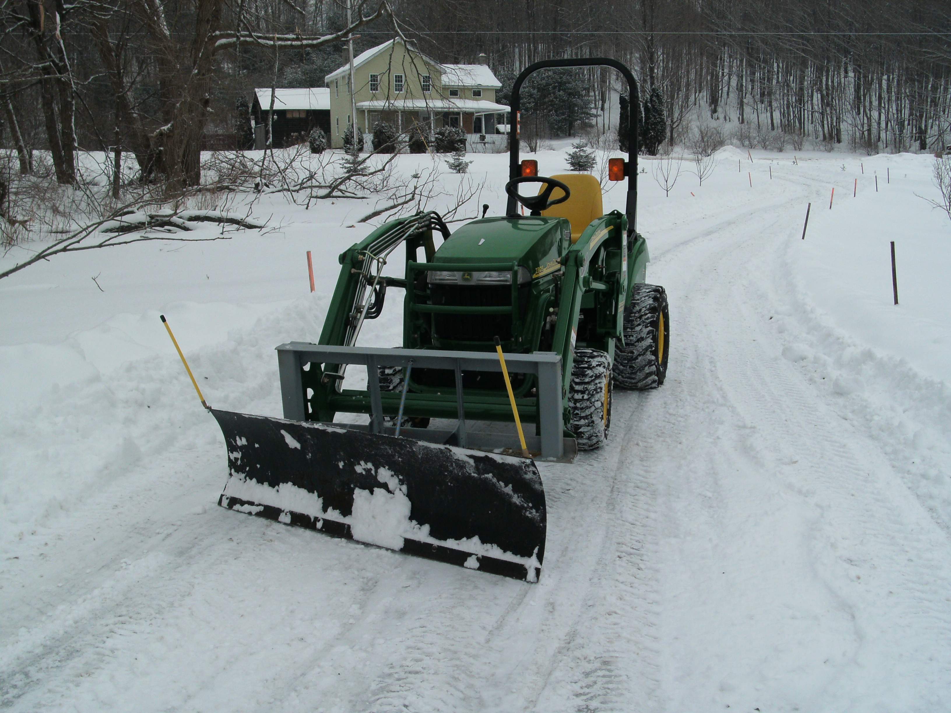

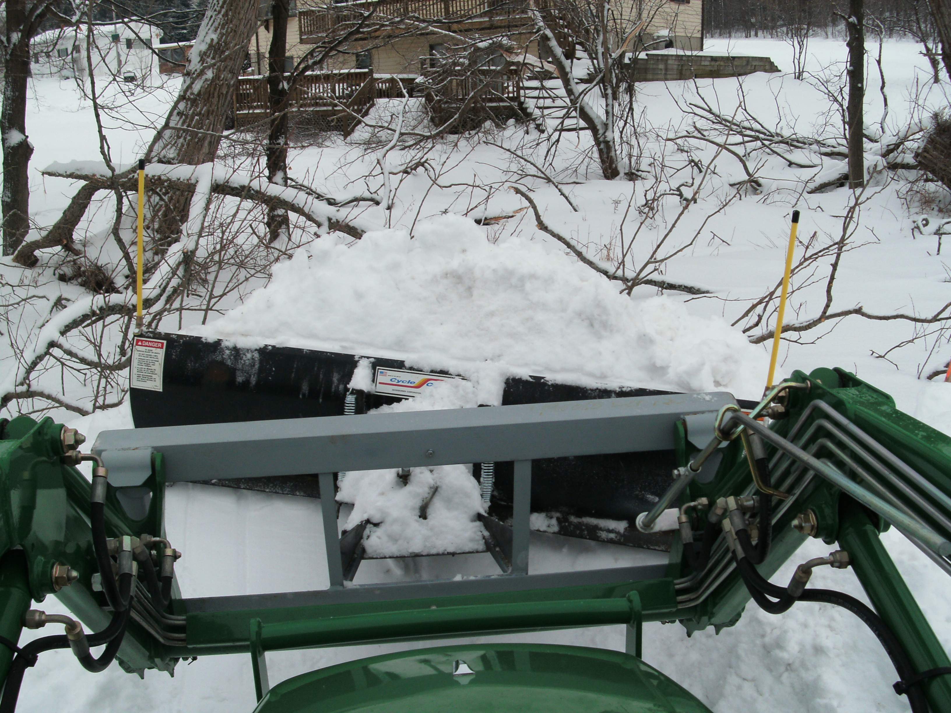

I actually just built a frame that attaches to the loader arms on my JD 2305 and welded a 60" atv plow w/ manual tilt to it. It works great. It is pretty light duty - which is fine for my machine.
I attached some pics. The nice thing I like about this system is that you can raise the plow to pile snow higher.
