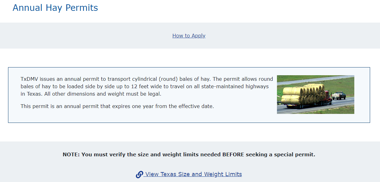

Here in my area of Texas, and I'm guessing it's common all over the state, are people hauling hay in hay trailers that are two rows wide. The guy I'm buying 20 bales from next week for my brothers place hauls with one of them. Ten bales lined up side by side that he pulls with a Chevy 3500 truck. Five foot bales put him at least 120 inches wide. The guy that I buy my hay from for my place hauls 18 round bales in two rows. I've bought 6 foot bales from him, which was at least 144 inches wide. He feels that's pushing things, so now he only delivers 5 1/2 foot bales, which is 132 inches wide. He's been doing this for years, and I see so many other people doing this, I have to think that it's something that they are not getting pulled over for. I also have to wonder how the hay trailer companies can sell these things if they are illegal?
I forget if these bales are 6 foot or 5 1/2 feet, but this is him delivering hay to my place.
They are not "illegal"
Far use gets all kinds of exemptions.
Those trailers and 2-bales side by side are still ALOT narrower than alot of the farm equipment you see going down the road. Some of these big combines with duals have to be 14-15' wide with no header. And some of the articulating tractors with duals and some of the equipment they pull....

Hay haulers can get an annual permit to haul up to 12' wide. Cost is $10.
