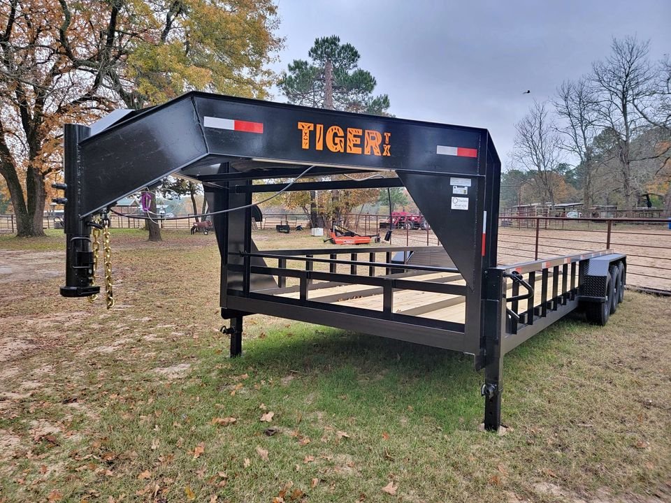

I'm also leaning strongly towards getting as low a trailer as possible. The higher everything is, the more effort it will take to hold it in place. This is a picture of what I'm liking the best. It's 22 feet long, it doesn't have any folding or slide out ramps, you just drive right up on it, and it's 8 feet wide between the rails, so I can fit two round bales between the rails and not have to strap them down. I'm thinking 10 bales with one strap on the back, and then 4 or five more on top that I'll have to strap down. Strapping down round bales takes forever!!!!
This dealer is pretty close to where I live. He's asking $9,650 for a brand new 2023 and it's at 21,000lb GVWR, 5,700lb empty weight, 15,300lbs carrying cap with three 7,000 pound axles.
That trailer is WIDE! wonder what “farm use only“ means?

Eddie that trailer you have pictured can't be 96" in between the rails. 102" is the maximum legal width and I believe that all you can squeak out of a deck between the wheel (and fenders) is in the 80" range.
Eddie,
Unfortunately for you the Texas farm exemption cuts off at 20k trailer GVRW (see post #20). It is possible the dealer can de-rate it for 21k to 20k and put a new tag on it but I think you usually have to order the trailer from the factory with the lower rating.
I would also be very leery of that trailer because it is technically over width. Here is a listing for it Tigar Trailer 96" x 20' where they advertise the 96" between the fenders. The federal max is 102" which typically results in a trailer like this have a between the fenders width of 80" to 82". Using the 82" number the tires and fenders add 20" to the trailer meaning this Tigar Gooseneck is 116" wide. I know farm use makes exceptions for wide loads but I would not want to be towing around a wider trailer like that all the time, and if you are any narrower county roads it could put you in the ditch at times.
Trust but verify.
I dont see any way that thing is 8' between the rails.
8'6" is still the legal max width to not have a wide load permit.
Thus MOST trailers that have a deck BETWEEN wheels are in the 80"-84" range.
I guess I should have logged into the FB instead of just looking at the pics he linked.
YEA, that trailer definitely aint road legal. its listed at 10' wide. Hence the farm use

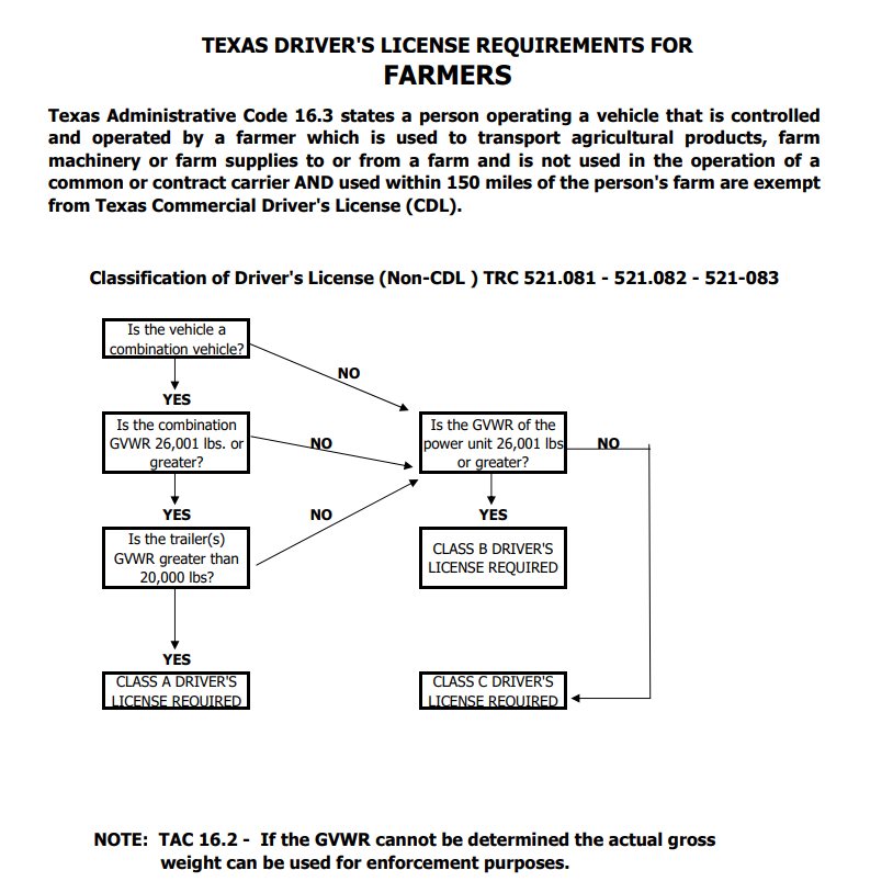

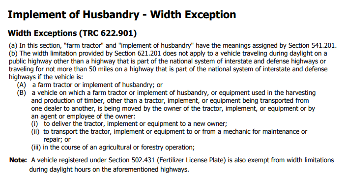

Here is why is says farm use only, so the 102" width requirements don't apply.. From the Texas DPS "A Texas Guide to Farm Vehicle Compliance" page 34. The definition of a vehicle includes a trailer with farm tags. Register it for 20,000# or less and pull it with vehicle under 26,001#, all you need is a Class C license, in Texas. See page 9.

We are limited to 102” in PA, but something like hay is allowed to be more than the width of the trailer. I have hauled loads of hay, grown by me, that were 11’ wide.
Obviously, a trailer thats 96“ or 102” wide can have the commodity exceed the sides of the flatbed trailer, as long as it’s properly secured.
