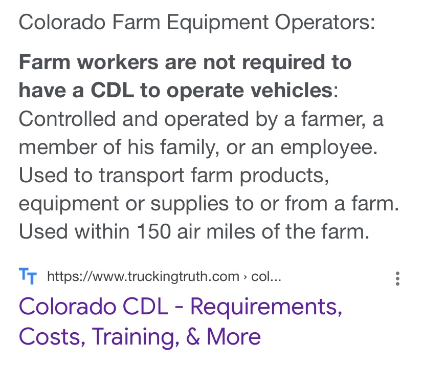

But, again, farmers fall under different rules unless hauling for hire. Here is an example from Colorado. The same for Texas and most states.

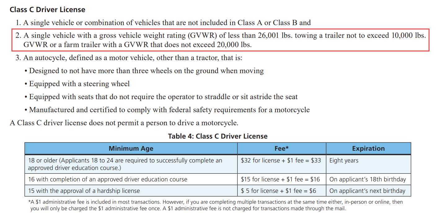

I'm not saying you're wrong, but the guidelines I've always gone by are these. Can you show me a source that shows an allowable 26k GCWR with a trailer weight over 10k without a cdla? It seems counter intuitive that you'd legally be able to haul a heavier trailer if hauling it with a smaller truck.
Types of CDLs​
There are three types of CDLs, as defined below by the Federal Motor Carrier Safety Administration (FMCSA):
  • Class A: Any combination of vehicles with a GVWR or gross combination weight of 26,001 lbs. or more, including a towed unit(s) with a GVWR or gross vehicle weight of more than 10,000 lbs.
  • Class B: Any single vehicle that has a GVWR or gross vehicle rate of 26,001 lbs. or more, or a vehicle towing a vehicle with a GVWR (or gross vehicle weight) that isn’t more than 10,000 lbs.
  • Class C: Any single vehicle (or combination of vehicles) that doesn’t meet the definition of Class A or Class B but is designed to transported 16 or more passengers (driver included) or is transporting material that has been designated as hazardous or material that’s been listed as a select agent or toxin
Texas Transportation Code Section 521.083
Page 4 of the Texas Driver Handbook from the Texas Department of Public Safety.
