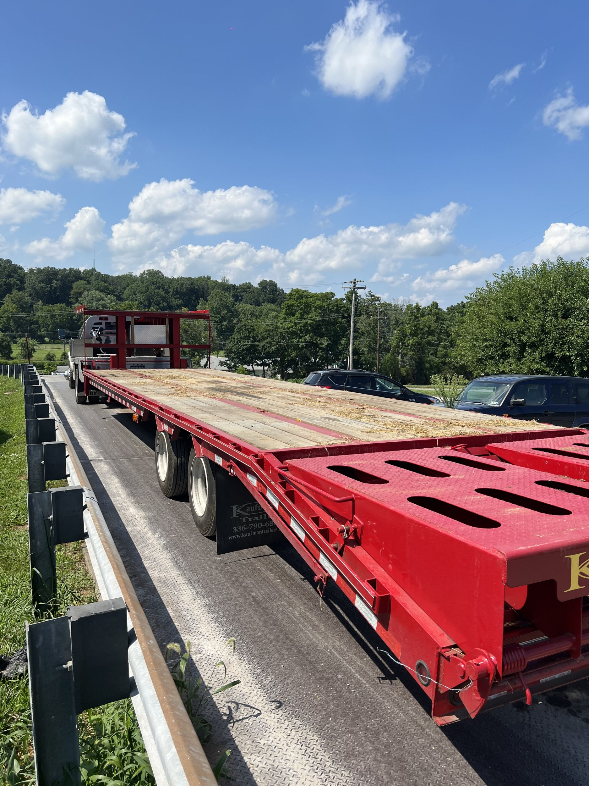

Eddie that trailer you have pictured can't be 96" in between the rails. 102" is the maximum legal width and I believe that all you can squeak out of a deck between the wheel (and fenders) is in the 80" range.
Ramps on a "deckover" with a std beavertail can be real assuring the your loads not going to roll off the back.
Be careful with your "just one strap" thinking, especially for 60 miles. This is one of the easy to spot reasons for Johnny law to pull you and snoop around.
Sorry Eddie, I never heard of such a trailer and don't do fb.👍

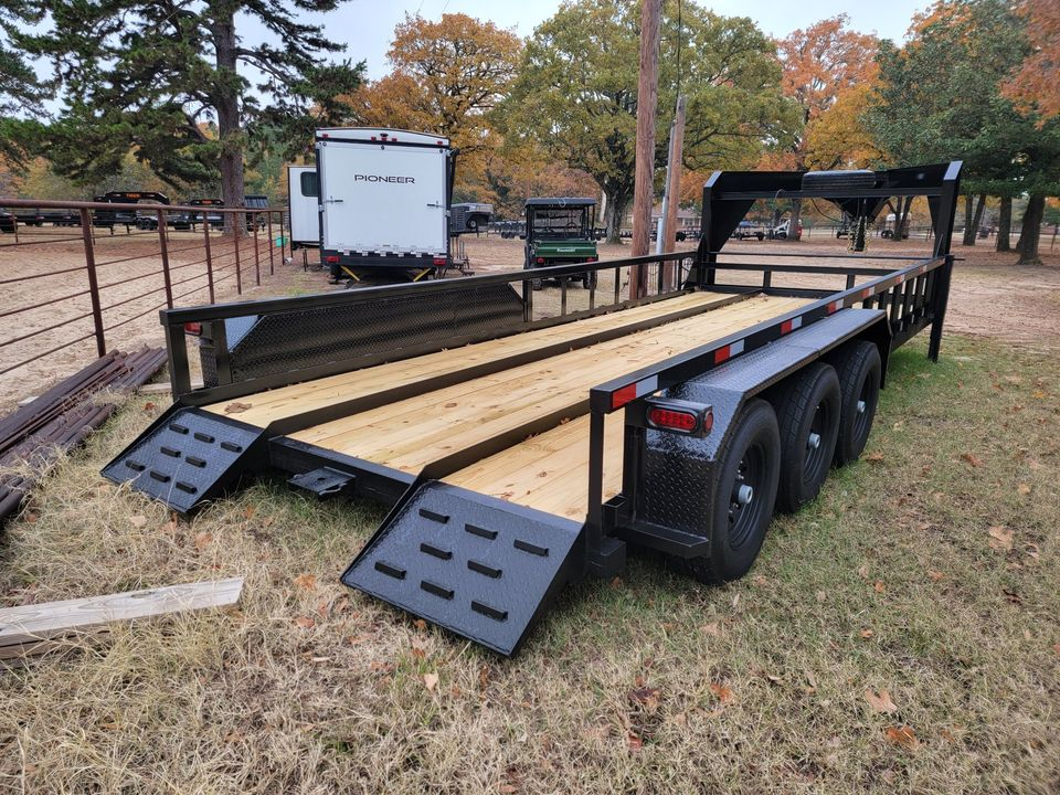

I'm also leaning strongly towards getting as low a trailer as possible. The higher everything is, the more effort it will take to hold it in place. This is a picture of what I'm liking the best. It's 22 feet long, it doesn't have any folding or slide out ramps, you just drive right up on it, and it's 8 feet wide between the rails, so I can fit two round bales between the rails and not have to strap them down. I'm thinking 10 bales with one strap on the back, and then 4 or five more on top that I'll have to strap down. Strapping down round bales takes forever!!!!
This dealer is pretty close to where I live. He's asking $9,650 for a brand new 2023 and it's at 21,000lb GVWR, 5,700lb empty weight, 15,300lbs carrying cap with three 7,000 pound axles.
That triple axle trailer is used for loading a tractor with a rake or hay baler behind it. Keeps from having to haul the tractor and baler separately. Farm use only because it's extra wide. The people that bale my hay have them and they can quickly load a tractor with rake or baler and move to the next field. All the load on the rear of the trailer but that's why the axles are set so far back. You may want to consider a 102" wide low profile trailer with drive-over fenders.

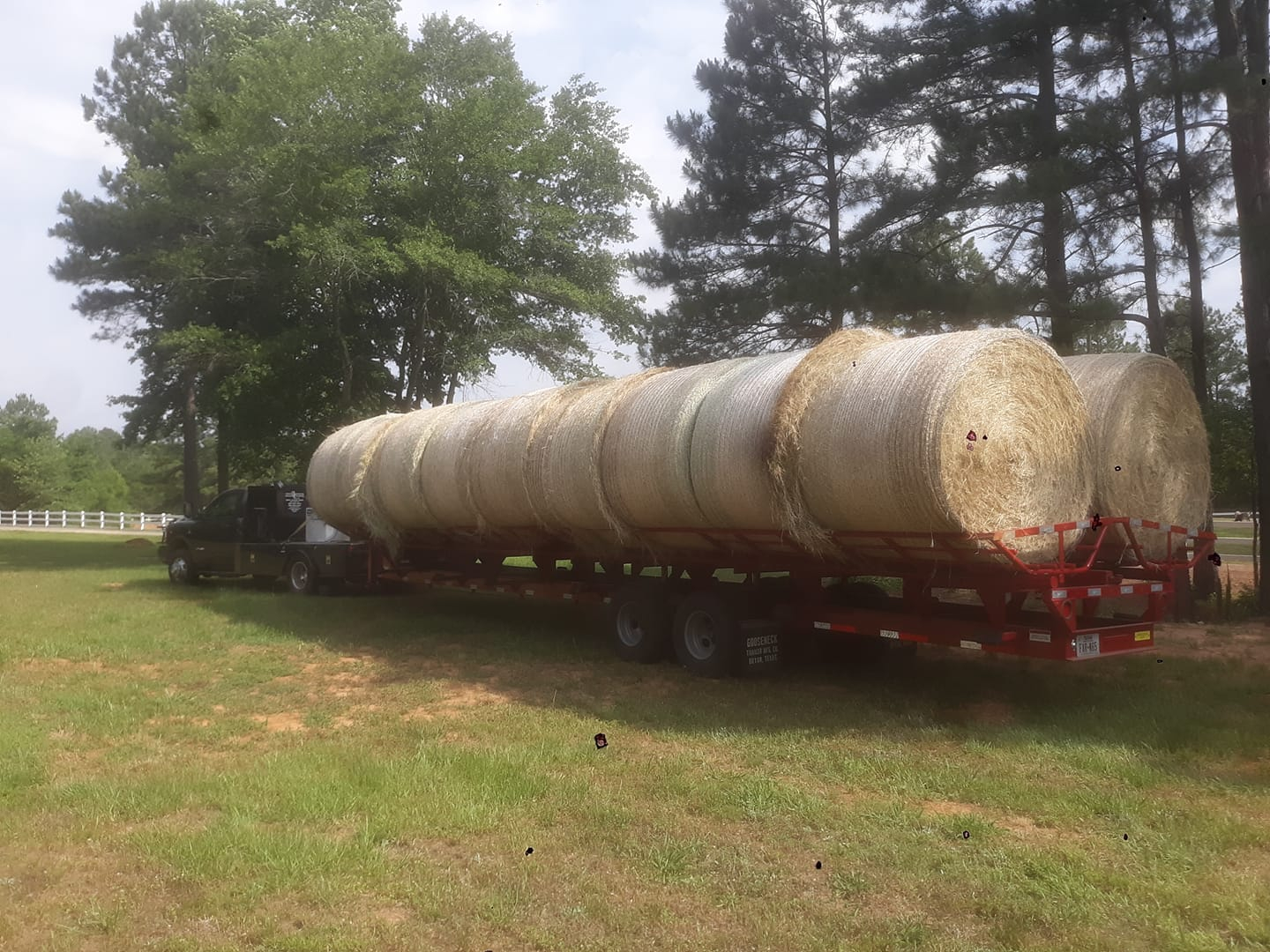

Here in my area of Texas, and I'm guessing it's common all over the state, are people hauling hay in hay trailers that are two rows wide. The guy I'm buying 20 bales from next week for my brothers place hauls with one of them. Ten bales lined up side by side that he pulls with a Chevy 3500 truck. Five foot bales put him at least 120 inches wide. The guy that I buy my hay from for my place hauls 18 round bales in two rows. I've bought 6 foot bales from him, which was at least 144 inches wide. He feels that's pushing things, so now he only delivers 5 1/2 foot bales, which is 132 inches wide. He's been doing this for years, and I see so many other people doing this, I have to think that it's something that they are not getting pulled over for. I also have to wonder how the hay trailer companies can sell these things if they are illegal?
I forget if these bales are 6 foot or 5 1/2 feet, but this is him delivering hay to my place.
