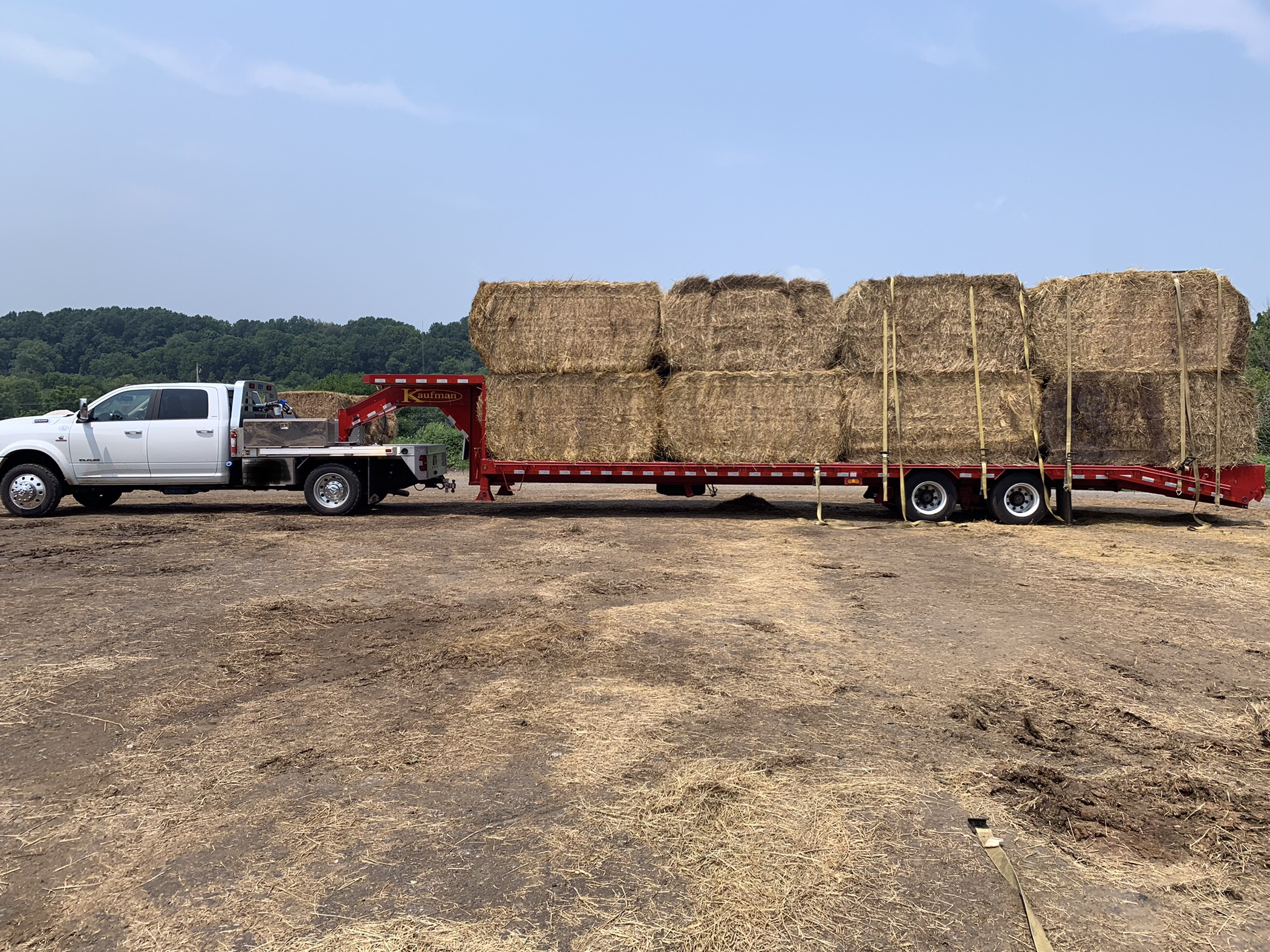

My Ram has a 19,500 GVWR. The trailer I tow has a 38,500 GVWR. Ain’t no way in hell that combination would be able to roll down the road at 58,000lbs. I have it tagged for 48,000lbs and it’ll do it, but it’s pretty well loaded.

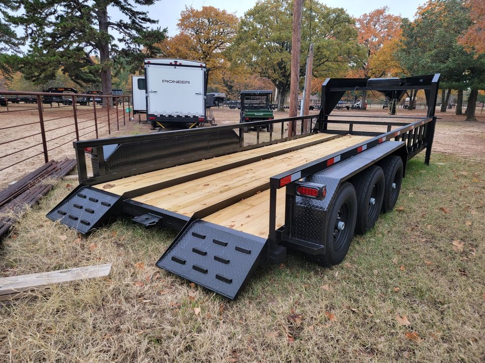

With the farm exemption I think your best bet will be to look for a 2005 or newer gas powered DRW pickup and get a 20k gooseneck trailer. If the gooseneck has flip down ramps you can often back a backhoe onto the trailer and the hoe pivot will swing through the space between the ramps eliminating any dragging concerns. Another option is to get a low profile trailer with super single 10k axles and drive over fenders so you still have a full 102" width.
Diamond C is a premium brand but they make if very easy to illustrate this. Other manufactures offer this option as well.
Drive Over Fenders for 102" Width
Low Profile Gooseneck Example - If you have the budget and are buying a new trailer I would recommend this one with two 10k axles, drive over fenders for the 102" width, and 28 or 30' long.

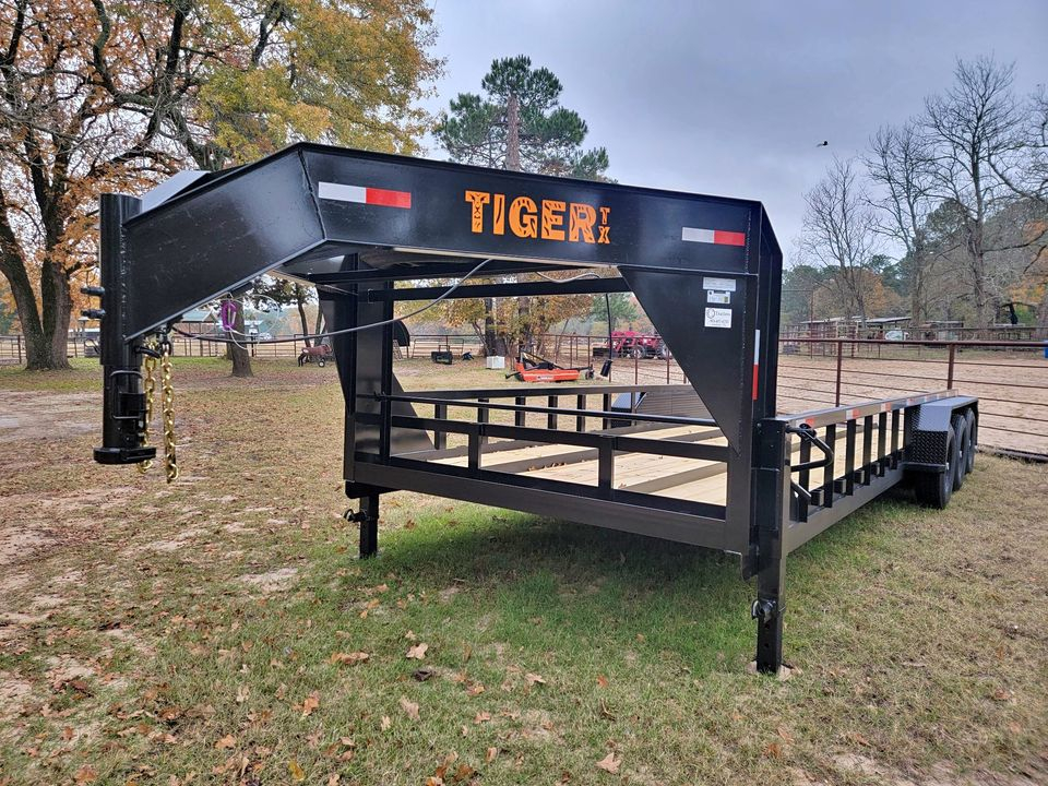

Eddie, further to my previous post(49), will a class 7 or 6 truck work for you? EG, in New Zealand we would use a 3 axle truck on either 17.5,19.5, or 22.5 inch rims, with a long wheelbase, with a 20' - 28' deck including beaver tail and hydraulic ramps. I would recommend tandem drive for off road and a power divider(inter axle) lock.
Thank you for the suggestion, but I don't think it's a workable option. I'll need to be able to haul different things back and forth, along with hauling livestock. I already have a 16 foot cattle trailer, so the truck would be used for two different types of trailers.
I'm also leaning strongly towards getting as low a trailer as possible. The higher everything is, the more effort it will take to hold it in place. This is a picture of what I'm liking the best. It's 22 feet long, it doesn't have any folding or slide out ramps, you just drive right up on it, and it's 8 feet wide between the rails, so I can fit two round bales between the rails and not have to strap them down. I'm thinking 10 bales with one strap on the back, and then 4 or five more on top that I'll have to strap down. Strapping down round bales takes forever!!!!
This dealer is pretty close to where I live. He's asking $9,650 for a brand new 2023 and it's at 21,000lb GVWR, 5,700lb empty weight, 15,300lbs carrying cap with three 7,000 pound axles.
