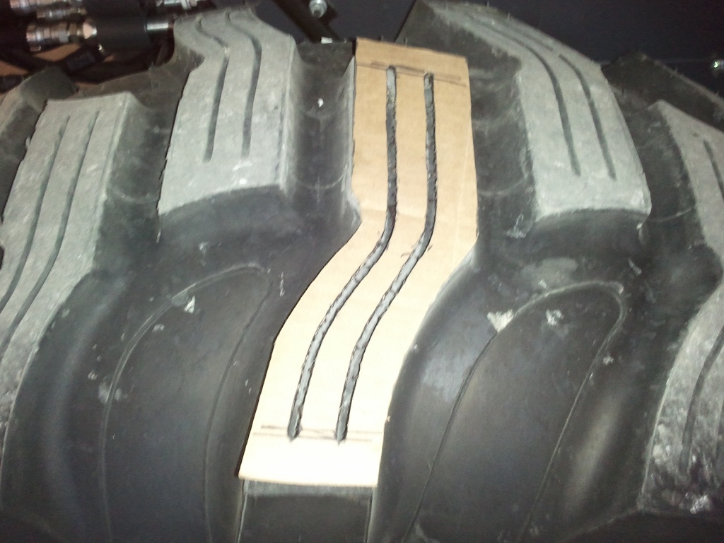

Trying the tire grooving for next mod

Thanks a lot! No sorry I don't have a link, but it was Speed Shop on ebay. They sell a ton of groovers on there. They also sell, what looks to be, a lot of dirt track racing accessories. Just look up tire goovers on ebay and 9 out of 10 will be speed shop. Then look for your a package that has the knife size(s) that you want to use. I used a #4. A lot of guys have been using a #6 on the rears.

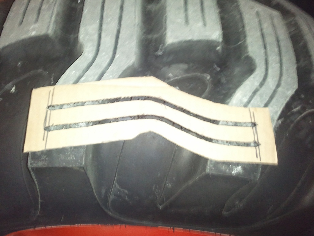

Good job, those templates are a great idea.
Thank you very much! I like the fact that my dealer said that it looked like it came that way.:thumbsup:

As for gooving, if you put grooves somewhat perpendicular to the lugs, that helps for side ways (lateral) stability. Like the one I put down the center of the front tires. Again the more biting edges the more traction even side to side.
