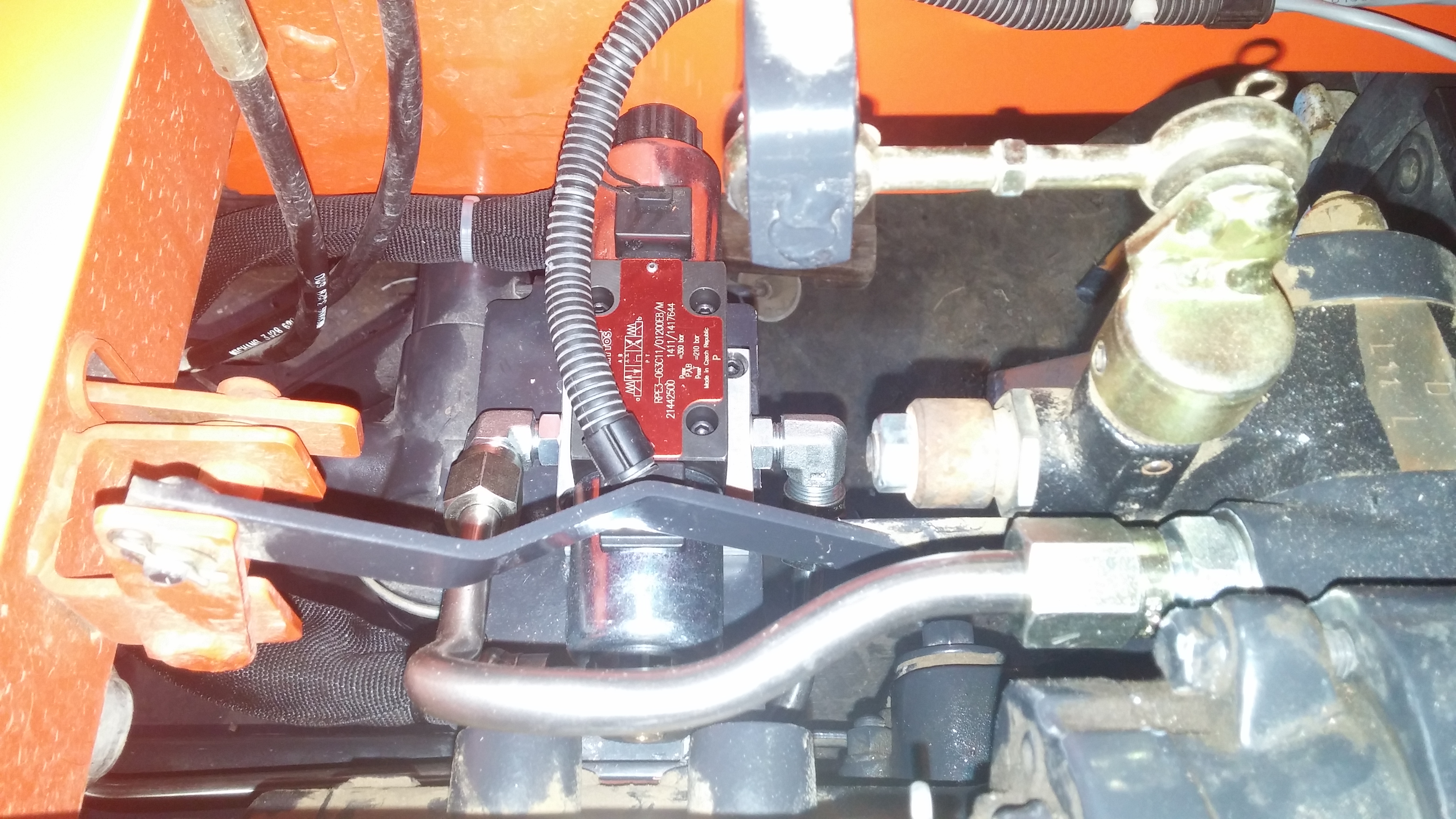

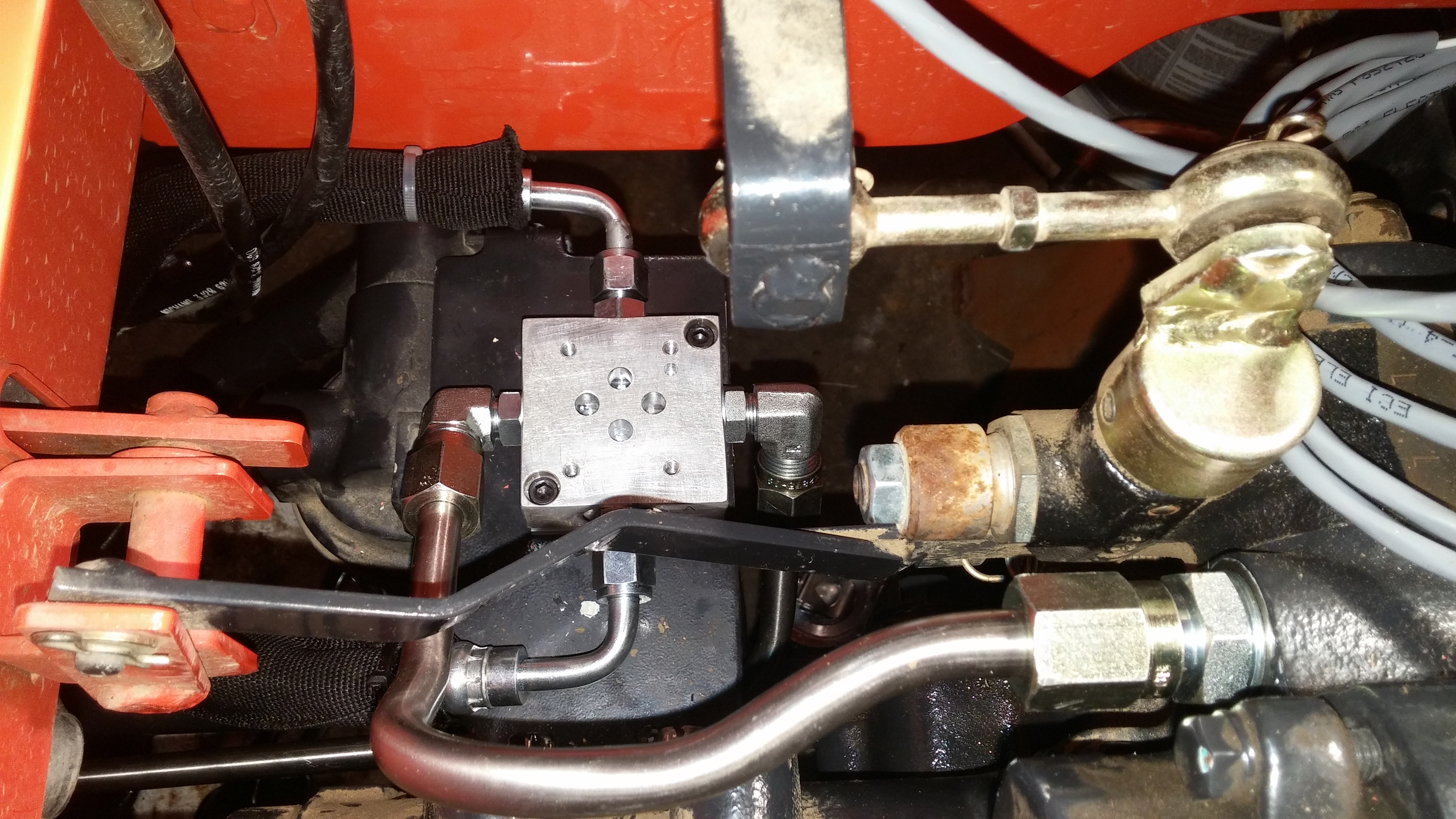

I went with this valve and the same do3 sub plate your looking at
12 VDC 21 GPM ARGO RPE3-6 DA HYDRAULIC DO3 SOLENOID VALVE | Solenoid Valves | Hydraulic Valves | Hydraulics | www.surpluscenter.com
Only reason was it was able to handle a much larger flow and pigtails instead of a bulky connectors. I have been very happy with it for the past 6months, its a very good quality valve made in Europe. I also opened up the ports in my sub plate I wanted as little restriction as I could get since my power beyond circuit also runs my backhoe when I have it mounted and if there is a lot of restriction it will create much more heat.

One question on solenoid valves in general. Can the valve be mounted on the subplate so it aligns with either the work ports or the through ports? Or can it only be mounted one direction?
To be perfectly correct they can only be mounted in one orientation (the pesky engineer thing again). That is to say only in one direction (like North-South vs East-West) and only one way in that direction.
There is a small pin on the bottom of the valve that sits into a hole on the subplate & the bolt mounting pattern is rectangular to prevent you from mounting it any way but one.
Another thing to point out, if you look at the pictures from Snowback that you linked earlier, he's using the W.R. Long kit and their subplate has ports on only two sides NOT one port per side like the subplate you have selected.
There's nothing inherently bad or wrong with what you have, I just wanted to make sure you noticed that not all subplates are created equal so to speak and that you are going to have to account for that with your mounting position and hose routing. Trying to eliminate the gotchas. ;)
As best I can tell W.R. Long is either making their own subplate or having it made just for them because I couldn't find anything like theirs after a couple good weeks of internet searches.
I did finally find one from Magnaloy that has ports on two sides but their design appears to be thicker (taller) that W.R. Long's and it's probably double the cost of the one you're looking at right now. That extra $$ buys a lot of 90 degree fittings LOL

Update.......everything works! Took a little figuring out on the wiring part and getting a 12v line close by was a bit of a challenge but not bad for a couple evenings install time. Huge thank you to all that have helped me along the way........been researching and asking questions for a month. Considering what I saved, I dont regret it at all.
dealer installed $1200 plus tax
wr long kit $900 shipped
my kit $360 various shipping included
