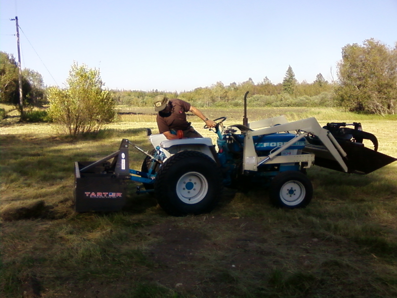

If you compare the photos of the TSC and United box blades note that the TSC blade has two angled flat bar braces from the top link point to the back of the box. The United blade has one brace going straight back. I have a TSC blade and bent these braces like a pretzel pushing back some dirt that I just dropped from the box. I repaired it by installing a brace similar to the United straight back out of 2 x 2 tube steel. Now it works like a champ.:)
IMHO United box blade construction is stronger. If its a toss up between the two, get the United.

Good points. Perhaps the Country Line BBs are the regular duty Tarters, not the HD. I have the heavy duty Tarter and it has a big square tube going to the back, as well as very wide plates forming the side braces. It's very sturdy.
Photo Large
The United looks like it has a tubular brace with flattened ends at the attach points. The ends look like weak points compared to square tubing cut at the proper angles to match the surfaces.
Just an observation.
Joe

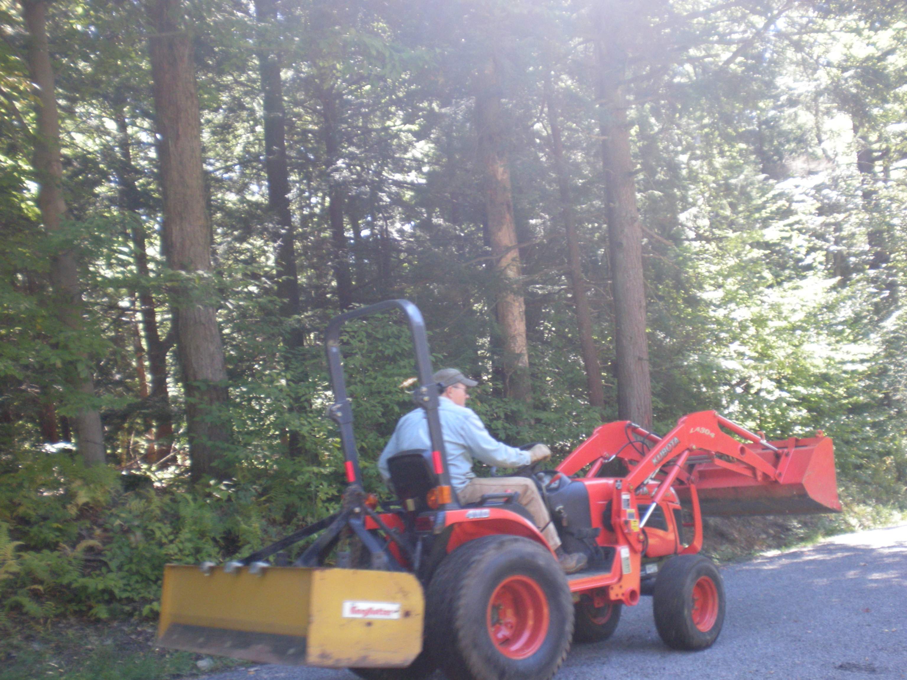

I bought my 5' King Kutter at TSC about 4 years ago. I am very happy with it. It is listed as 415 lbs. on the King Kutter web site.
