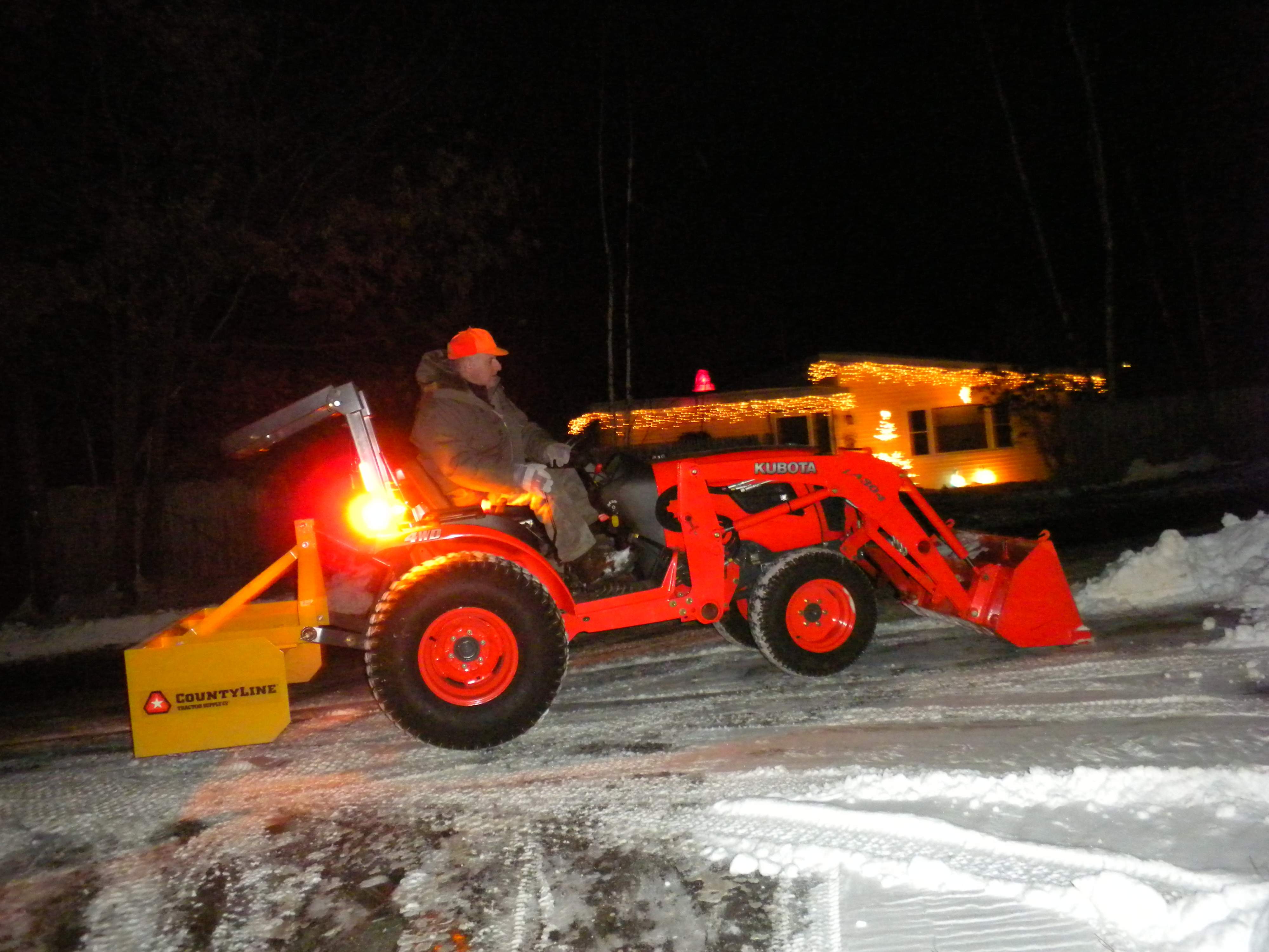

Crazyal, You'd be Crazy Al if you had one now and didn't hang it on the back for this snow......it works great...!!....I love to plow with it....can't wait for more ....:laughing:

Forgot to mention mine's 60" w....(tractor is about 48" w)

With a front mount snow blower and "soon" a Herd sand spreader for the rear I have no need for a box blade in the winter time. Actually the only reason I don't have the spreader now is because I never got around to filling the tires so I have a rear weight on the tractor.

Ahhh...I hear that, really hard to beat snow blower out front..:thumbsup:
