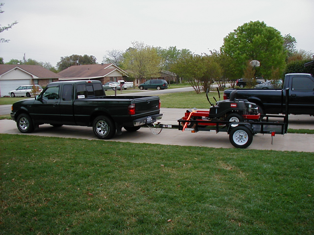

I guess I was lucky because my old Ford Ranger had the 4 pole connector when I bought the truck, so this trailer, and a couple of others in the past, just plugged in and the lights all worked properly.
