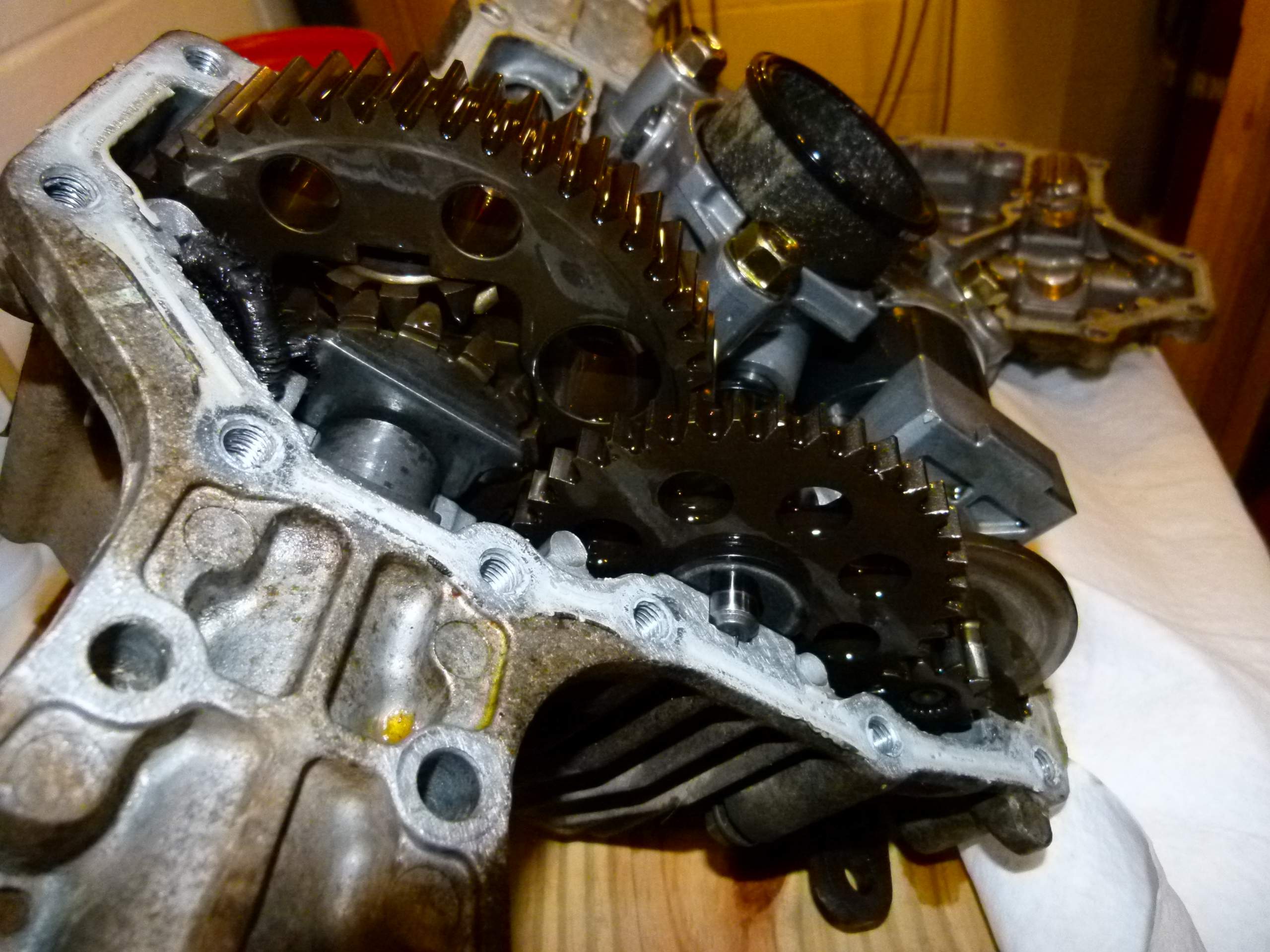

Hey Y'all! I've read all 68-so-far pages here and thouroughly enjoyed the expertise of some folks here, L.O.G.G, you are the MAN for the work I see here.
I picked up an L130 a couple years ago, cheap at the pawn shop and soon discovered the 'why-it-was-there-so-cheap' reason. I somehow missed this place in my searches and decided to park it rather than spend the bucks to 'fix' it. Now the trans is on the bench and I know what I need to do and order. Thanks Guys, much appreciated.
Some pics - it's an L130, haven't a clue on the age, K46 s/n is 46AC0129722.

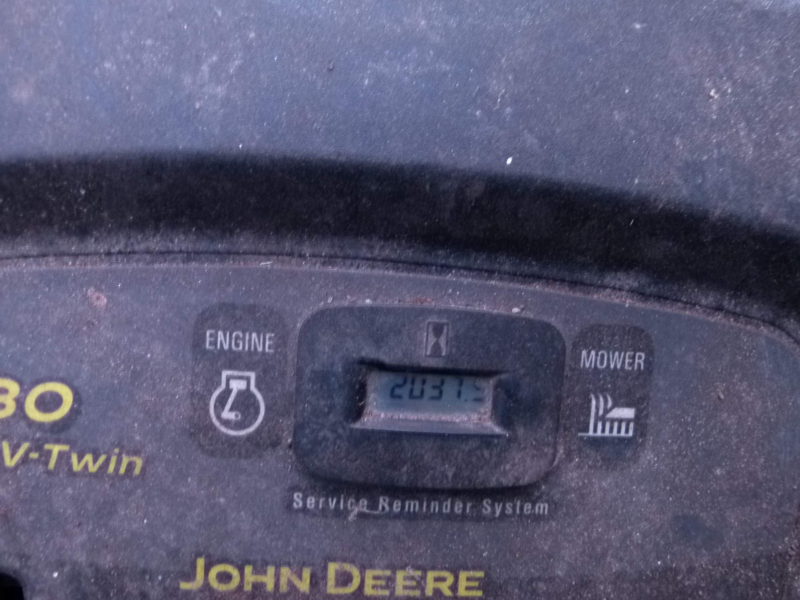

I kind of question this, it's WAY higher than I've EVER seen (except the JD265 I had upo north for a bunch of years)
The oil was suprisingly honey colored at first, but it got nasty black quickly, with a far number of specks showing. I'll strain it later to see better.
The magnets were pretty nasty, looks like they really are useful.
I can see the wear patterns on the gear faces but overall everything is suprisingly fairly evenly worn looking, nothing broken. Fair bit of wear on the spider gear faces, but I'm going to shim that some, there really is an unacceptable amount of play in that whole area. Still amazed at the overall 'niceness' of the insides given the hours.
You can see one magnet there, and it looks like the filter worked ok - nice little reflections all through it.
Off to tufftorq.com, I'll update with results in a week or so, it's Georgia, it's winter and this isn't priority yet. :D

My 130 says over 4000 hours..reason for this was the previous owner had a screwed up ignition switch. It was always in the "Run" position and that's when the meter starts ticking...as long as the battery was hooked up, it was recording time. He started it by jumping it at the starter with a pair of pliers, he shut it off with the choke.
Looks like you have the powder gears. I would recommend changing them for 24 bucks to the new steel gears. New filter 10.50 Lap the surfaces one piece 79 cents 320 grit paper. Silver silicone from tuff torq for 12.50 and 19.50 ups ground frieght. Total 54.79 and you should be ready to go. PS. For 10.50 I ordered a spare filter for the next time
Watch out for the tiny pin that goes into the center case... this pin is activated by the bypass shaft. If you move the bypass lever is and out, you will see the motor housing pull away from the center case, this lets the oil bypass on the motor when moving the tractor by hand. When you re-assemble check the operation before you button it all up. PS. When you install the center case, make sure the bypass shaft is in the regular position and not in bypass mode or you can screw things up bad.. PSS. lightly tap the center case back in with a rubber mallet.
Good luck to you.

Dapped: Thanks for the info, and another member mentioned using a dab of grease to hold it - something I thought of when I first heard of the pin. A teeny little bit won't hurt a bit and will give great piece of mind.
I kind of lean towards these hours being fairly real, based on tire wear more than anything. All 4 show the same dry rot indications so they should be a set, and the fronts are darn near bald.
