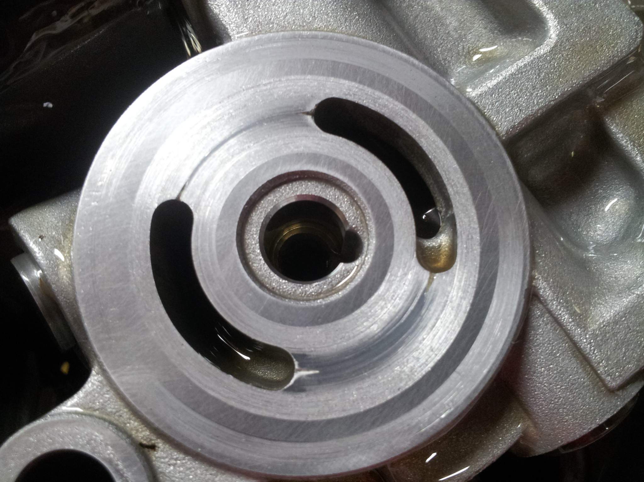

Here's an update on my K46AC that was rebuilt by sandpapering the case/pump/motor a year ago. After working well all summer, this year's harsh winter took a toll on the K46 while I was snowblowing my driveway as well as my two neighbors'.
The first sign of trouble was in February when it refused to move at during very cold mornings, protesting with a loud bypassing sound after I floored the pedal. I eventually figured out if I could rock it back and forth a bit, it will eventually catch and warm up, and then I could do my snowblowing with no further trouble. Two big snowstorms later, the heat-induced issue came back, and it could only run for about 20 minutes before it would start bogging down and have trouble going up/down hills.
I finally took the K46 apart last week, and saw the same scoring as before on the case, along with a lot of aluminum and iron flecks in the screen filter.
The Castrol Edge 5W50 was very dark and looked burnt. My differential gears were already quite worn from before, and I think that's probably the prime source of iron in the filter and oil. I think the premature failure was caused by having residual metal in the case and not flushing the oil out completely last time.

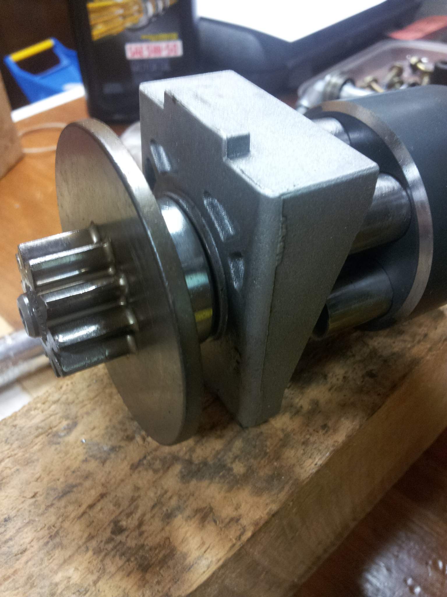

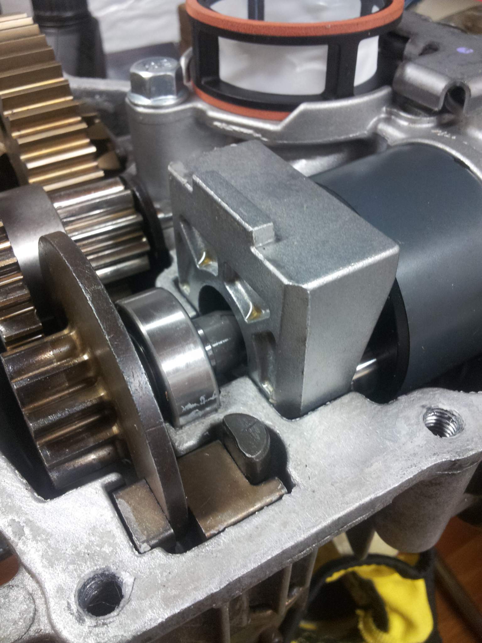

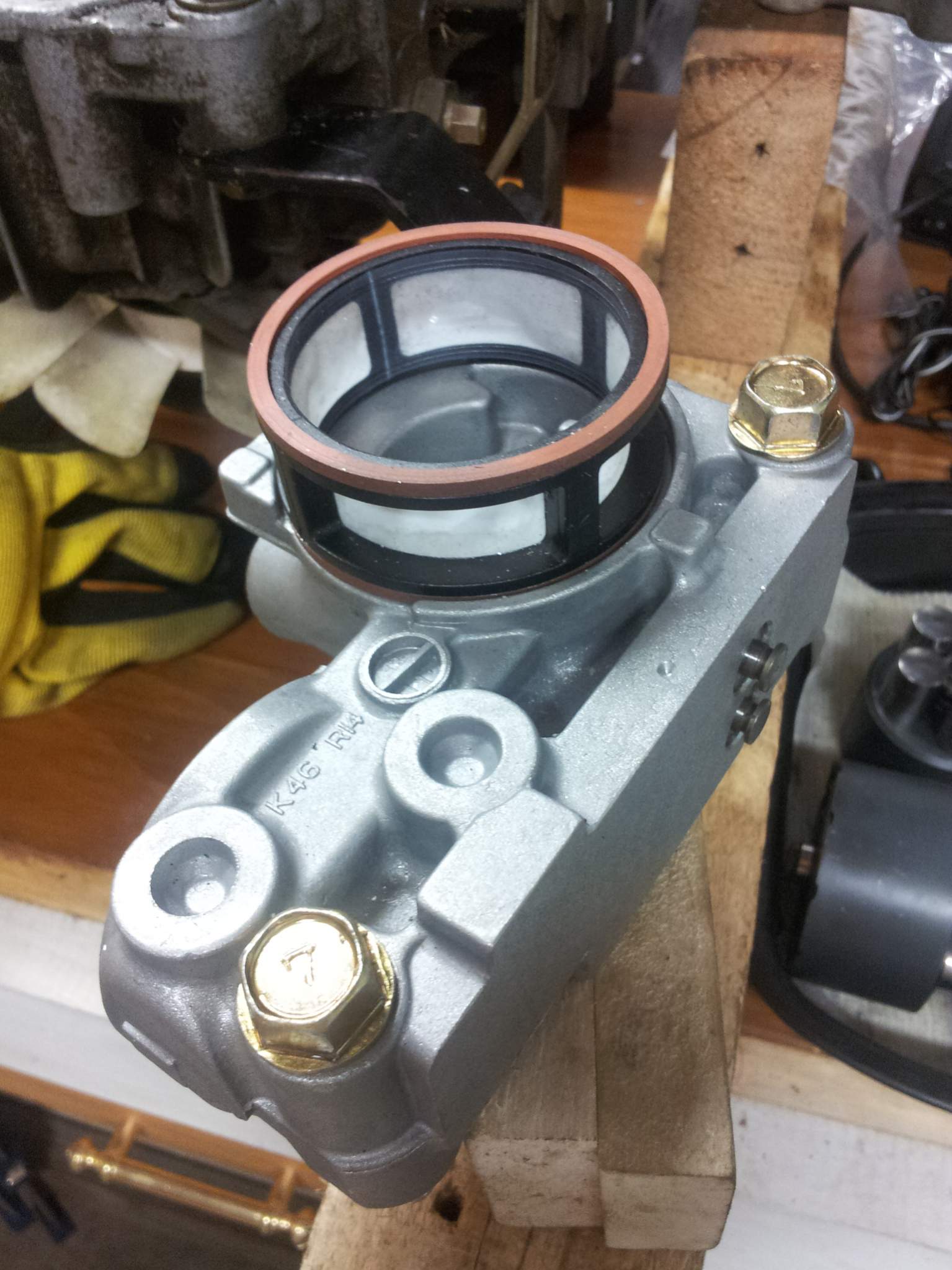

After sanding the case, pump and motor, I found someone on Ebay selling like-new differential gears and like-new T40 pump motor with case, screen filter, and IDS filter (really just a couple of magnets). This combination cost under $200 shipped, compared to almost $400 if buying new parts from Tuff Torq, so I went for it. The new differential gears took back a lot of the slack that I had with the worn gears. The only thing from the T40 that didn't fit was the wedge, so I re-used the K46 wedge.
T40 case, K46 case:
T40 wedge (notice the extra lip next to the shaft bearing), K46 wedge:
